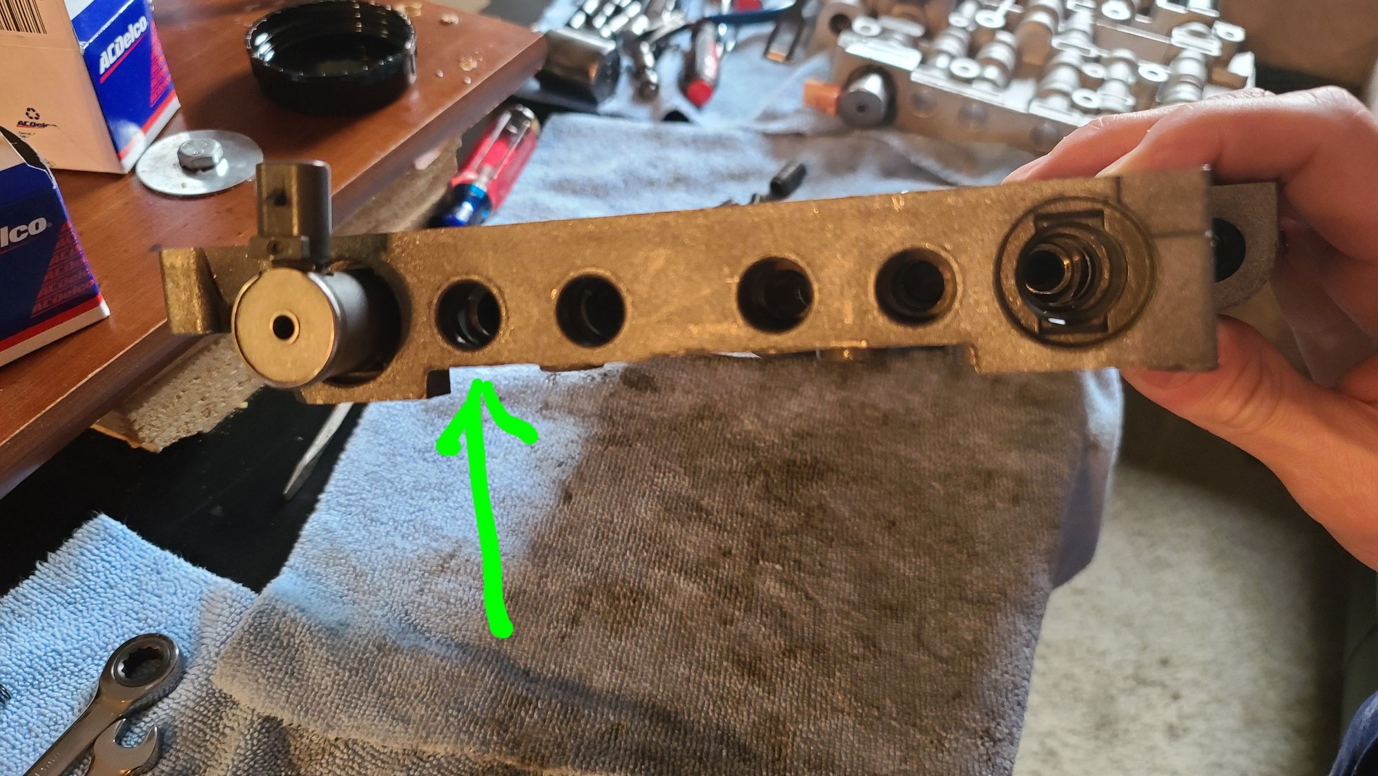

Getting myself turned around pretty good here.
Is this the Sonnax TCC line up in the valve body for the converter clutch regulator?

That line up was here
Old May 30, 2021 | 12:24 PM
David1's Avatar
Joined: Mar 2021
Posts: 23
From: Central Oklahoma
Yes. Page 2 figure 4 and 5

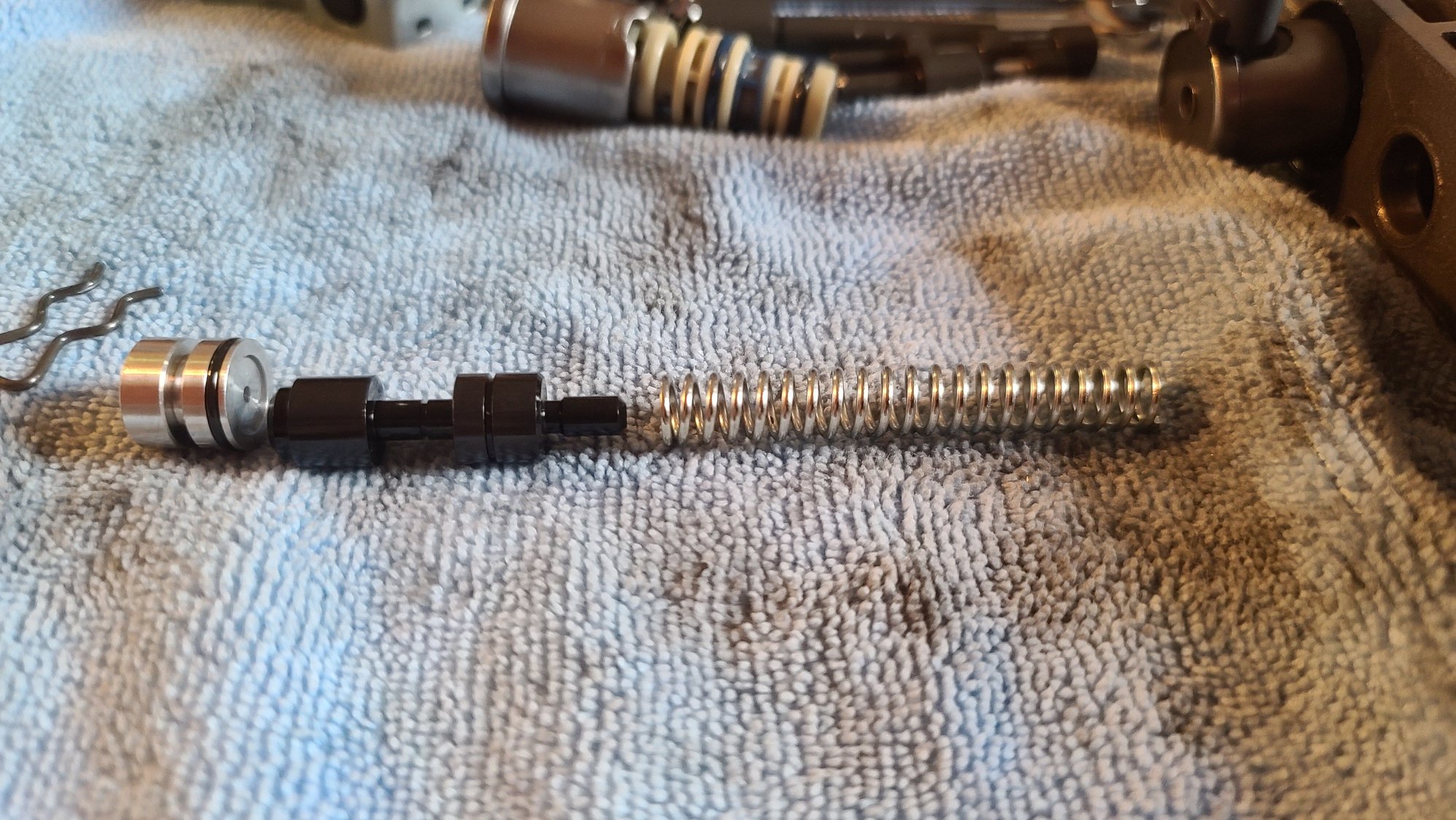

I'm swapping my '98 valve body over to a '03 valve body.
I have the Fitzall A74741QA tcc valve. Do I need to match that valve with valve body year (2003) or vehicle year (1998) ?
Also what should I run, the sonnax part or the Fitzall ?
hp-4l60e-01
Damn, thanks. I have been searching high and low in all the wrong places to id it.
