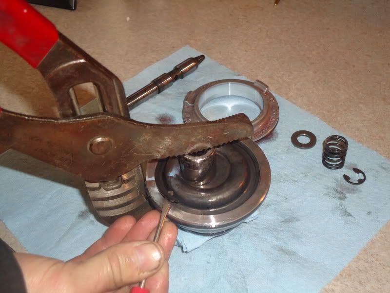

i have a 2000 z28 pulled the servo out. theres 2 springs inside where you pop off the clip to open the servo. do i need the middle small spring.? i seen videos of people installing just 1 spring there.. thanks

You talking the 2nd gear servo release spring or the cushion spring under the washer and e clip?

yea the one under the big plate that you have to pressure down to unclip it.. theres 2 springs inside

right here where u take the clip off there 2 springs under.. do i need the small 1?

Keep both of the Cushion Springs for the intermediate Servo.
