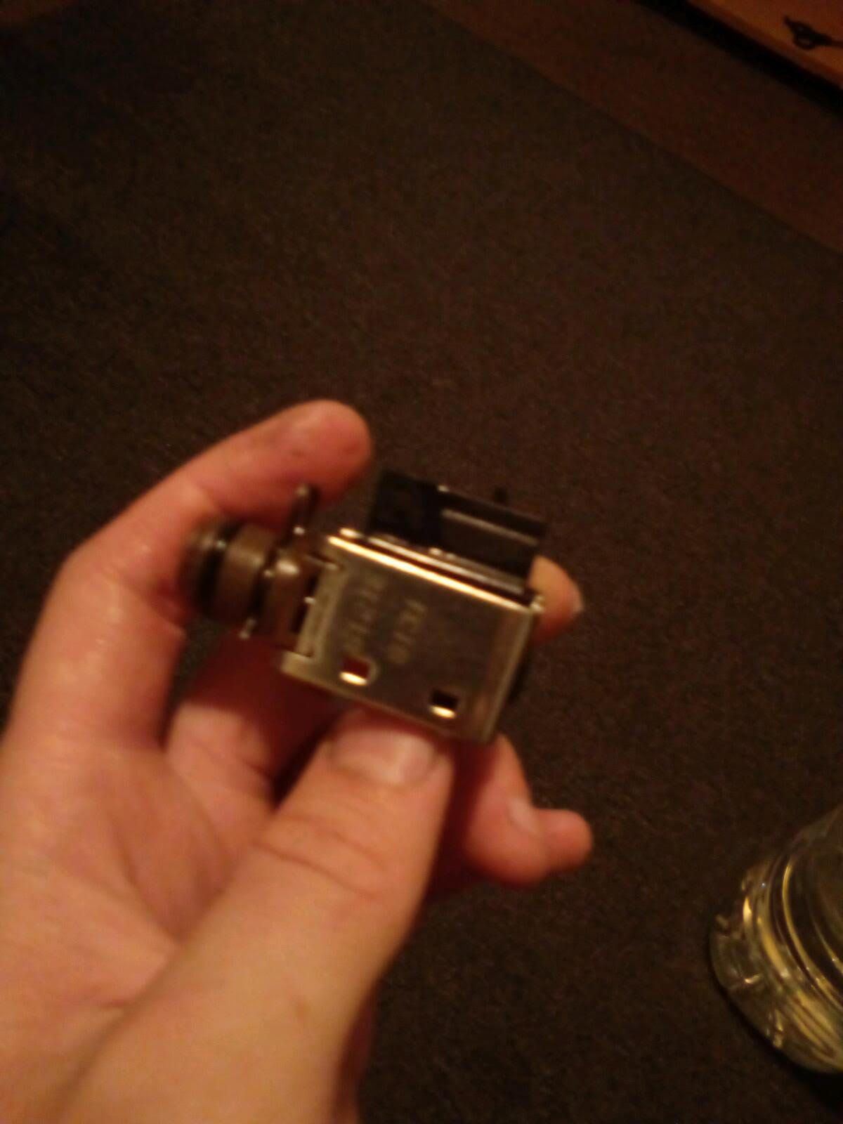

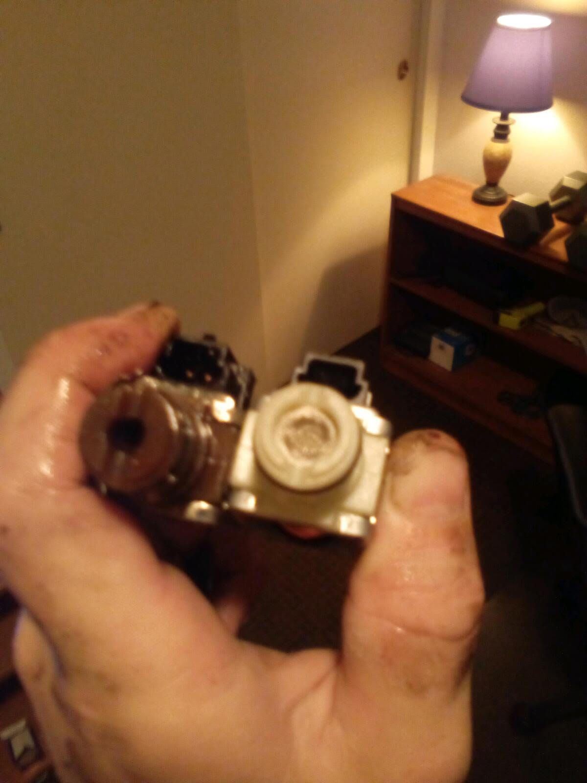

Do the corvette shift solenoids not have a screen? I had messed up one of mine changing the trans filter and replaced it with one from a rebuilt 2000 ss trans. Now i had ordered a replacement as pictured ac delco from amazon and fit that back in the stored spare transmission. When i got mine out i do notice that the one from my 99 corvette doesnt have a screen. Do all corvettes come like this it does seem slow or sluggish shift but this be my first time having a high performance automobile that was auto with the 4l60e. Part number i seen from both are 6121E 8131 versus whatever other 4l60e comes with. I attached photos. Anyone had theres off or even looked at them from a 4l60e ls1 car? And does anyone know where to find the same 6121E 8131 to compare it to or put back in the transmission?

Corvette did not get any special solenoids.
They just changed over the years and new replacements are a bit different too.
They all will work fine.
Sluggish shifts are not the fault of shift solenoids
