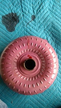

Can anyone advise if this is a #0 or #6 impeller?

Take a photo from side the showing the outer most dimple.
Looks like a 0 or 3 blade from that angle though.

Man I don’t have one. The guy is insisting it’s a #6, so we stopped communication.
how much of a difference would a #0 and #6 be with all things being equal? Say with an 082 stator.

Few hundred RPM difference depending on the combo.

What do you think flash stall would be between the two on say a 500 hp 500 TQ LS. 0 vs 6 082 stator?

Engine displacement?
RPM where peak Torque occurs?
Vehicle weight?
Old Jul 21, 2021 | 06:34 PM
PRNDL's Avatar
Joined: Feb 2019
Posts: 94
6.0
4000
3200
just looking for a general ballpark idea
