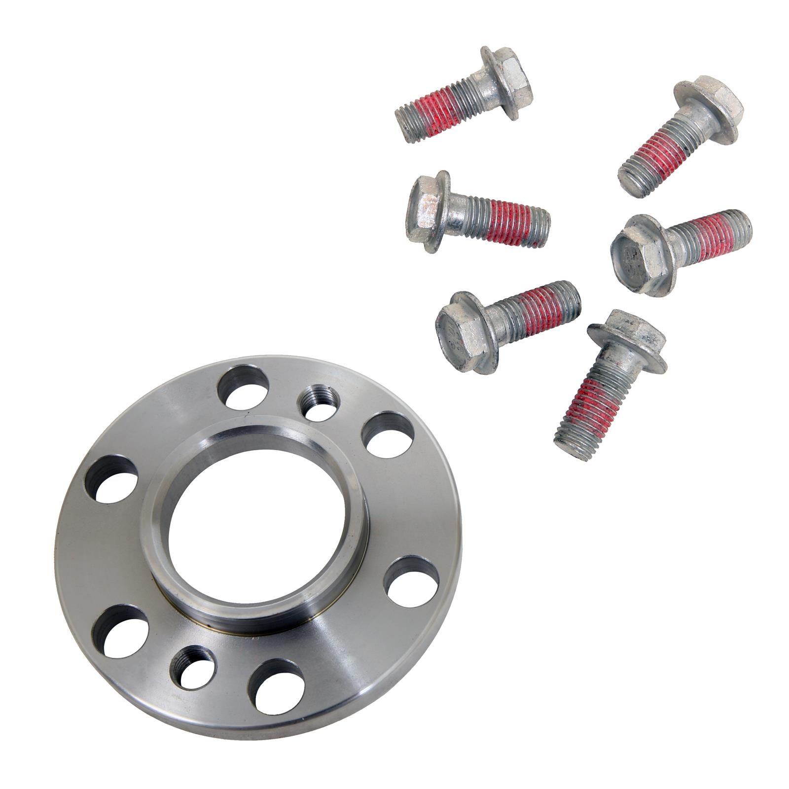

-Use a GM Flex-Plate Spacer with longer Flex-Plate to Crank-Flange Bolts: HyperLink

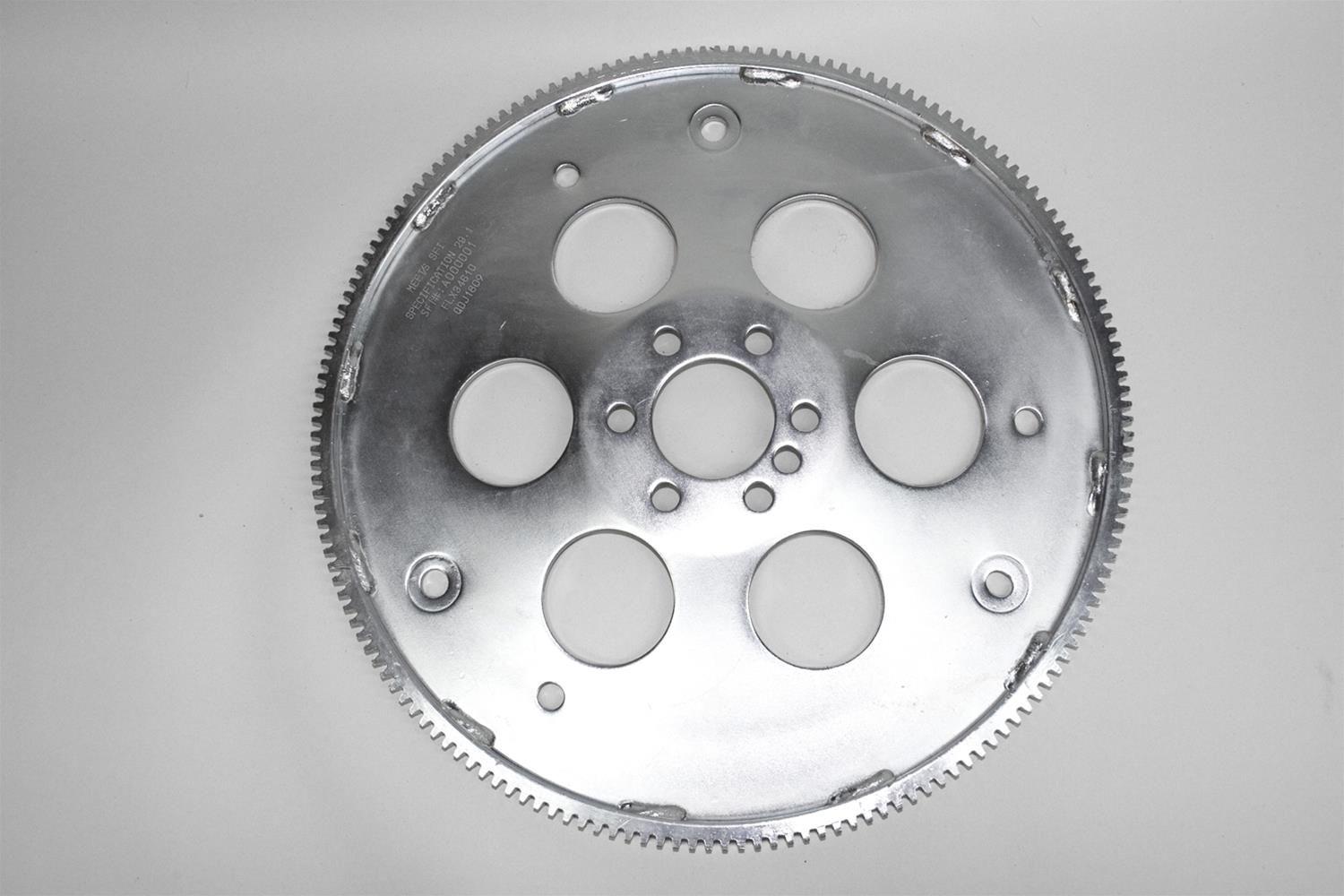

-And last, use a Gen-3/ -4 SBC Swap Flex-Plate with a DUAL-PATTERN for the Torque-Converter Bolts.
The 10.75" Pattern is for Transmissions used with Gen-1/ -2 SBCs (like the THM200-4R).
The 11.066" Pattern is for Transmissions used with Gen-3/ -4 SBCs (like the Late 4L60E, However the 4L80Eand THM400 are an exception):
