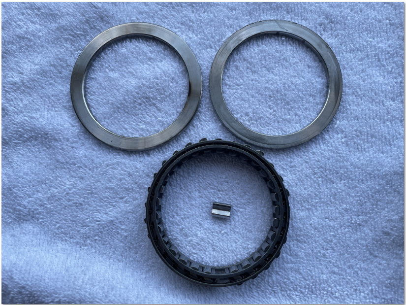

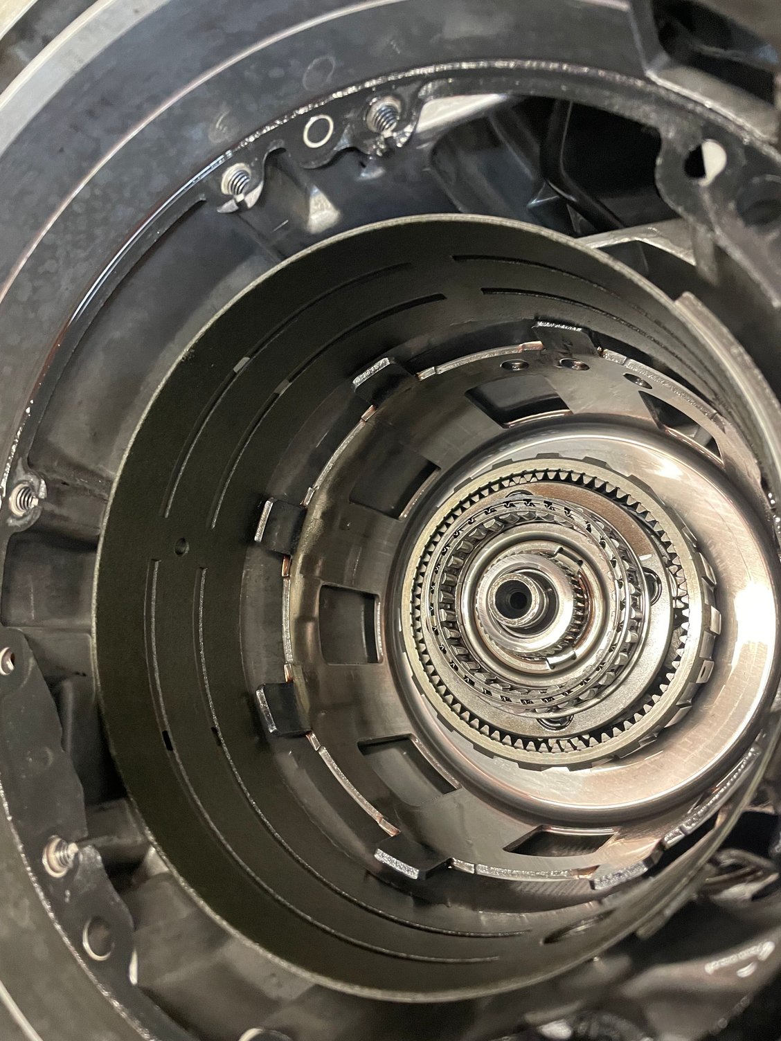

Well finally got the trans out and started to disassemble, when I pulled the pump out then the drums this is what I found
here are some pictures of the sprag
Any ideas what the root cause could have been?

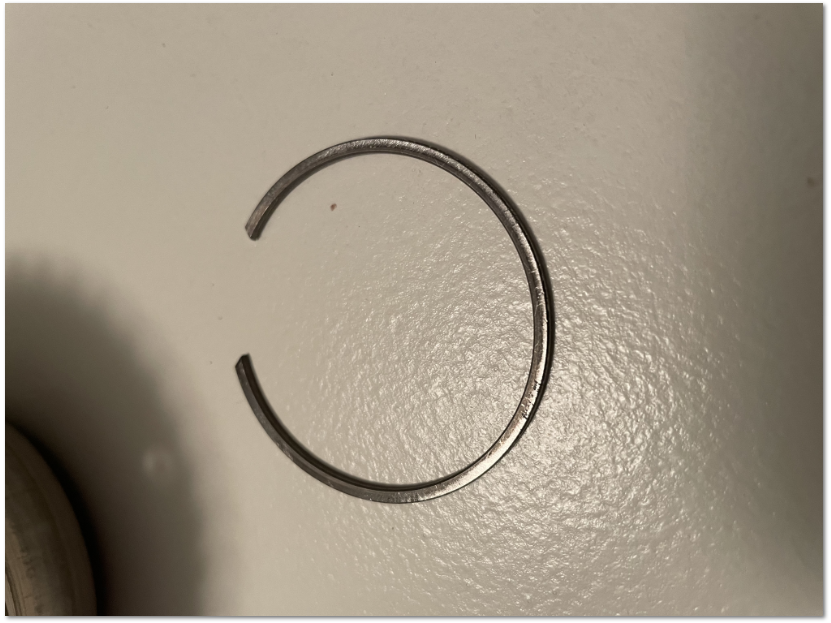

What did the sprag retaining snap ring look like? Pics?
Old Nov 13, 2021 | 11:12 PM
  #34
apex2112's Avatar
Joined: Sep 2005
Posts: 47
From: Davie, FL
All the snap rings appear to be in good condition and were fully engaged.
one picture of each side
Everything seems to be in place expect for the sprag itself.
The inner race has a pretty deep wear groove on one side as shown in the earlier picture.

That Dog-Bone/ Spag had some wear on it...
It was past do for a replacement.
