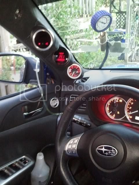

As already stated, NO tires in the air.
Take pressure-readings in all Gear-Selector Positions...
Both at an Idle, and at 1,200 RPM to 1,500 RPM.
Idealy, also monitor the Pressure while Driving and Shifting.
Obtain a LOOOONG Hose, and tape the Gauge to the outside of the Windshield.
