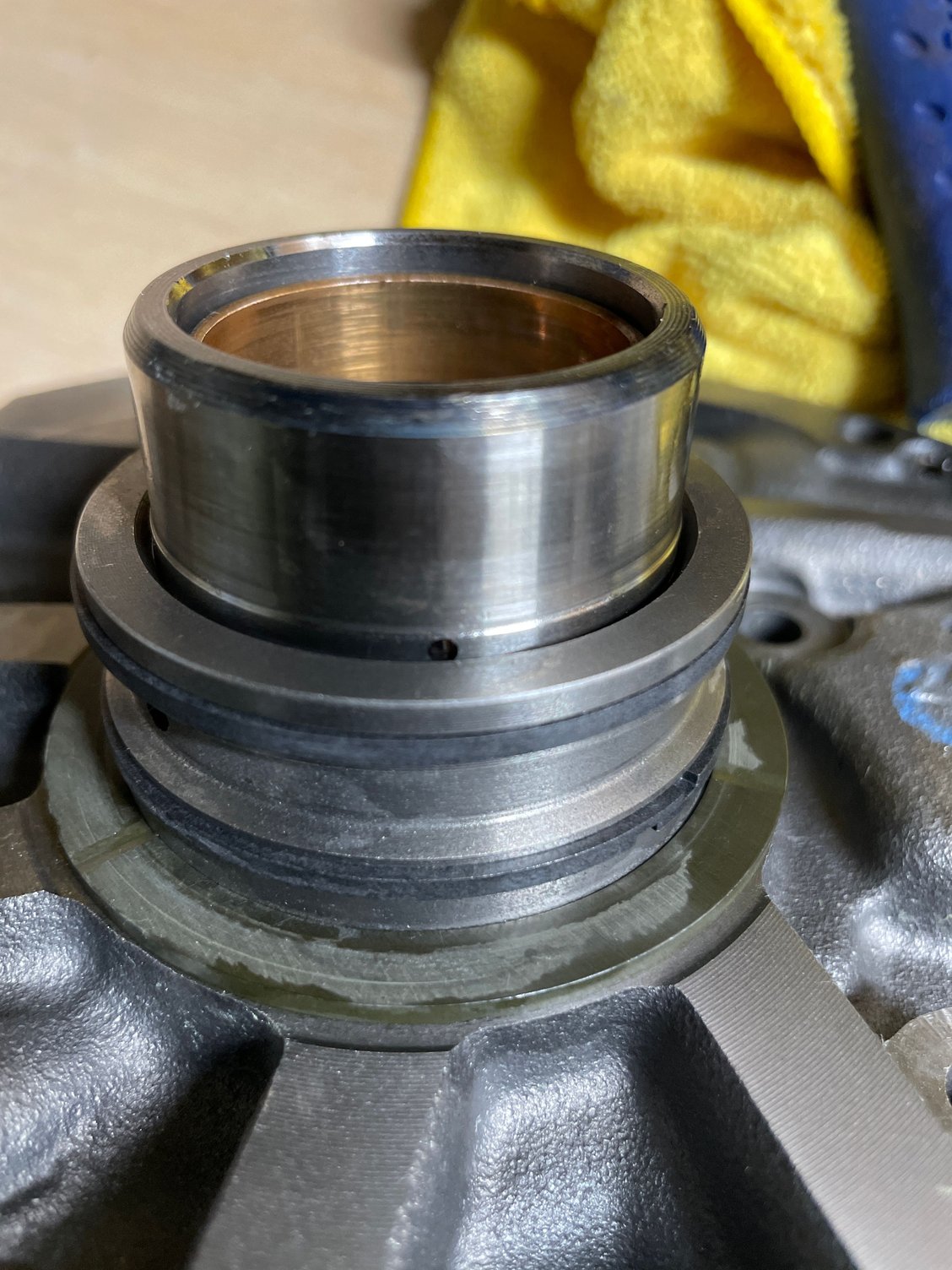

I’m getting ready to do some pump mods to this junkyard trans I got and it looks like someone has already done, something. I was about to do the lube to line bypass when I saw some witness marks and found this hole. It’s just under 1/16”. Should I still do the normal bypass?
Also, this hole gets enlarged to 1/8” at a 45° angle, correct? Sorry for the dumb questions fellas.
This is the one I want to make sure gets enlarged to 1/8” at 45°

that is most definitely not the correct location for that hole...that hole needs to be plugged. It will cause more harm than good
and 1/8 at a 45...where did you get that?
if you're going for line to lube, different factors determine how big you go

my apologies, 1/8 at 45° was in reference to a different pic of the stator support that didn’t load. This is an early model (96) with a Jakes stage 4 kit and D3 transbrake. It will be mated to an approx 1000rwhp in-line 6 Ford barra. Street/strip machine.
What would be the best way to plug that hole?

That hole will be a bear to plug.
If you can even get a tap in there...a really small setscrew like 10-24 might be OK
If you're good with a TIG you might be able to make something work for ya also.
That hole will see line pressure...so whatever method you use, it better be pretty stout

10-4. I have a Tig machine, but that’s certainly not a great spot to work in. What size would you recommended the proper lube to line bypass hole be given my setup?
I think I may be better off getting a reman pump than messing with that previously drilled hole.

Another option may be something as simple as a nail that is a slight slight press fit in the hole.
With some creativity I'm sure you can figure out a way to effectively plug that hole.
.093-.105 depending on converter used.
If using a triple disc, go on the larger end of that range.
Single disc, .093 is fine
