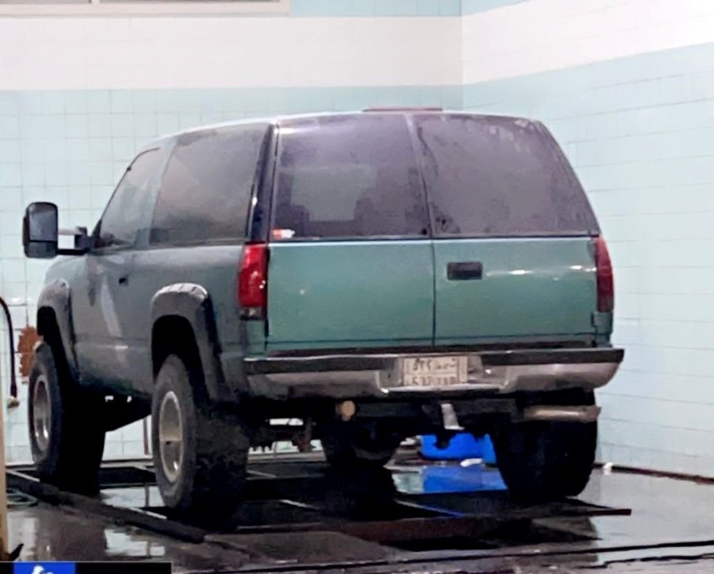

my car chevy tahoe 1995 2door 4WD
i swap the engine to Lq4 6.0 2006
tire size 305/70/16
I added Truecall cooler 40.000
the problem with transmission
3 times I changed the transmission over the course of three years
All of them I bought from Junkyard
last gear 2004 4l60e 5 pinion 4WD
Now work only 1
so I am thinking of buying a building kit that will be useful for my cars in the desert and daily use
Please help, thank you
