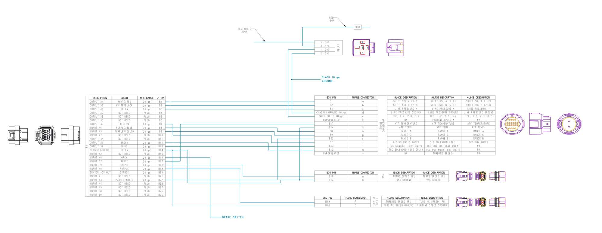

ok this is dumb but...where in the harness does the wires come from for the neutral safety switch on the side of the tranny? Doing a 4L80E swap and somehow I literally lost the wires/plugs that go into the switch...like I can't find them anywhere and I can't find any pictures that show where in the harness they are or where they should be coming from. FYI this was a complete engine/tranny pull out and rebuild so all of the harness was just hanging for a while...thanks folks.

If you have a puppy like mine, she chewed them off.
It has been a while, but I think they branched out of the harness with the big round trans plug.

i haven't been able to find it there, and the wiring harness pictures I have seen don't show it either, just the tranny plug, VSS, and rear O2 sensor plugs. there must be a separate harness somewhere with these in it...

TTT - anyone have any good pics or anything showing where the neutral safety switch wires come out of the harness?

Not sure if this will help, but here's a pinout from Holley's harness for the 4L__ got this from one of TruckDoug's awesome YouTube vids.
