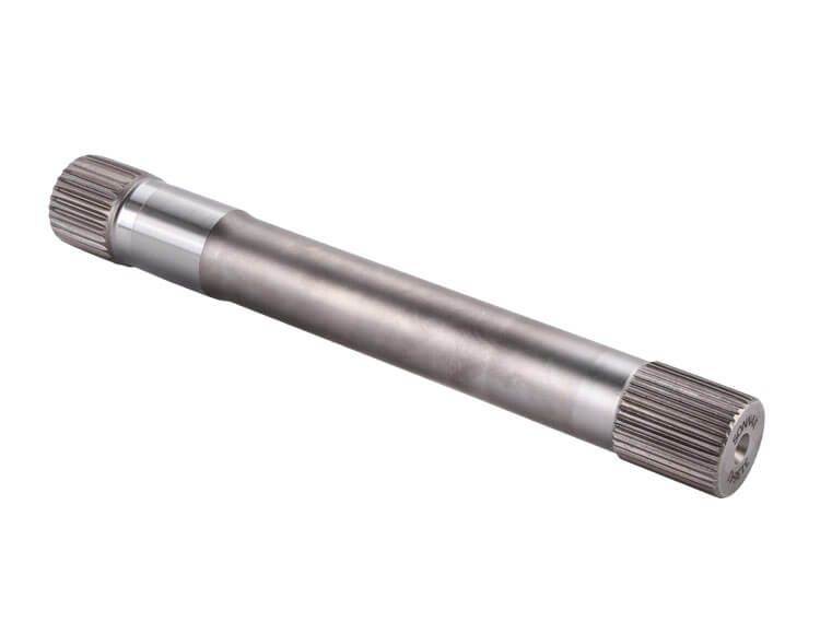

I have never used the Sonnax 1" input shaft (or any Sonnx Input for the THM400)...
What did you see in testing?
If it is the Design that I have seen... I do not like the design of where the Turbine-Splines end.
That transition could have been much better... I don't want to see much up an under-cut on anything that will have some power put through it.
This transition on the 1.25" Part is substantially better!
Below for anyone that has not seen the 1.25" Part:
