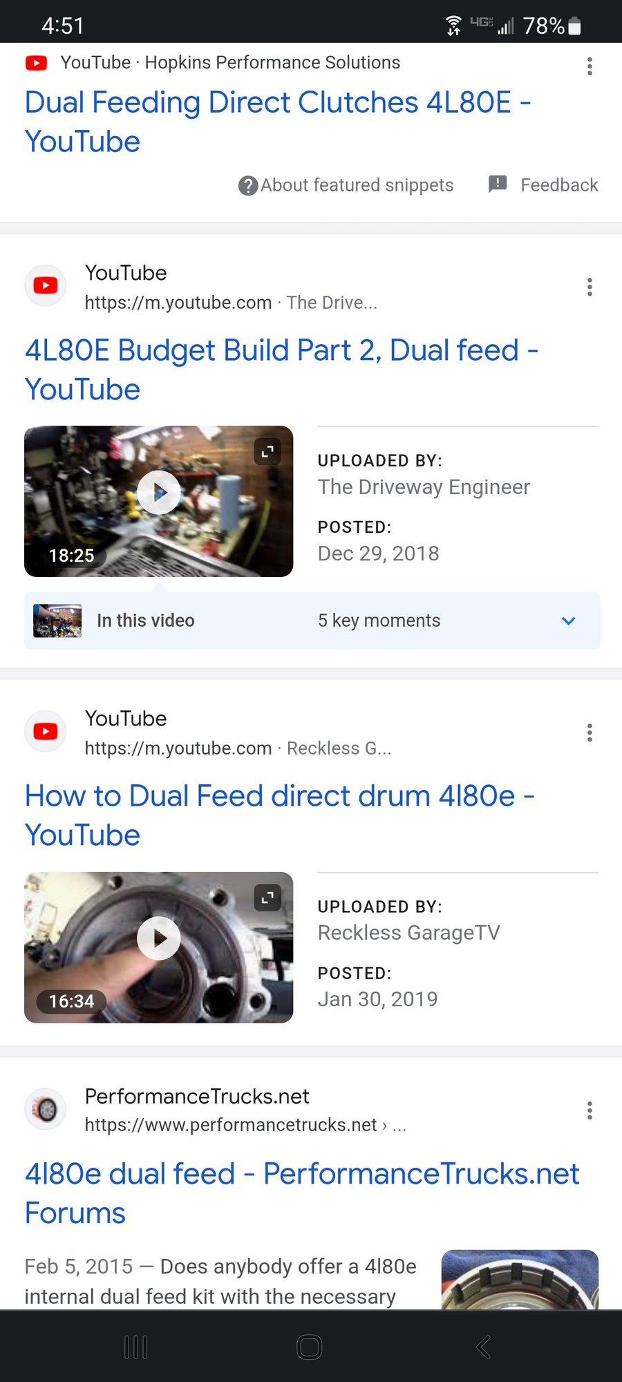

Will I need to take the trans apart for that? Or can I get away with outer valve body stuff? Is there a write up anywhere where people have done this?

Old Sep 16, 2022 | 10:01 PM
truckdoug's Avatar
Joined: Nov 2013
Posts: 6,389
Likes: 558
From: Portlandia
yes and no. the best way to dual feed it would require disassembly. transgo offers their HD2 kit that sort of accomplishes the same thing, but is done in a sandwich stacked separator plate that "rewires" the hydraulic circuit to do the same thing.
when I first got into turbo LS stuff thats what I did and sometimes the result was great. sometimes it turned out shitty. mushy, erratic shifts, short lifespan etc.
i became so frustrated trying to hold 750hp I went down the rabbit hole and now I build them for a living HA
