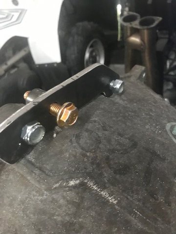

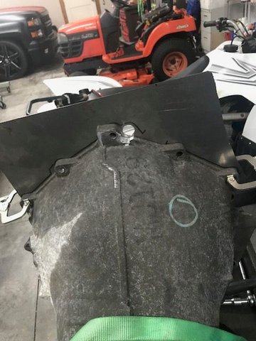

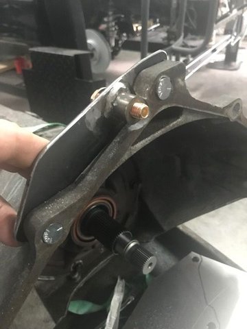

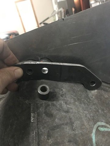

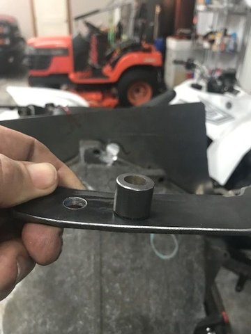

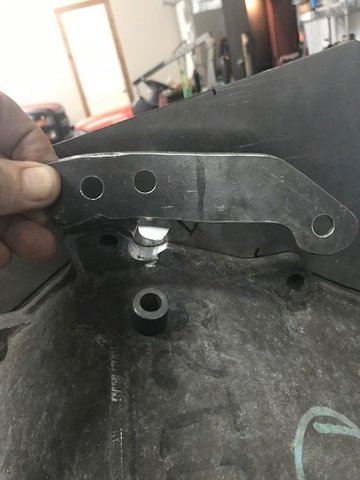

I am using a 2005 version of the 4L80 on the 2015 5.3L. The bolt pattern for the 6L80 is different at the top of the bellhousing and the 4L80 is missing two of the top bolts that don't line up with the genV block. Some people don't mind this and bolt it up and send it. I don't like the no support at the top, so I made a "saddle" so I can use the top hole. It was kind of a pain, but looks like it will work.
Made a pattern off the 6L80 and drilled the 80 bellhousing for the top bolt.
this is 3/16 plate with the shape and holes drilled

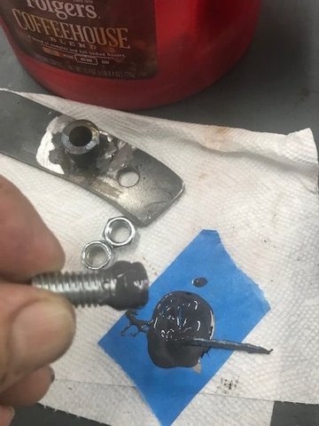

I will weld the 3/4" bushing with a 7/16" hole to the plate to fill the space in the bellhousing.
This is how it looks finished

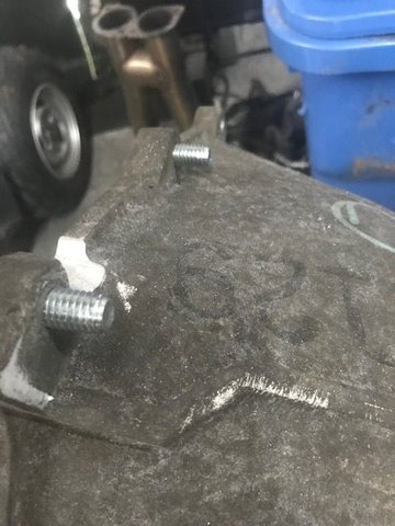

I used 7/16" hex bolts and ground the heads down so they fit thru the unused holes. There is a step in the bellhousing hole to prevent the bolt head thru.
Bolts after grinding
I used some JBWeld to prevent them from turning when I tightened the nuts.

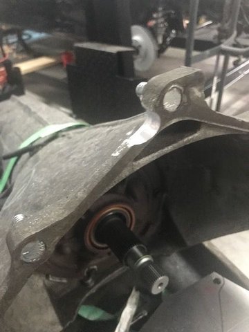

Bolts installed
Bolts installed--other side

With the holes that match. there is 13" of bellhousing supported. The two holes that do not line up are 5". That means that 38% of the bellhousing is not supported. Argue with GM about why those two bolt holes are 1000% not needed. I am sure they would not have put them there if they were not needed. And I know that a lot of guys have used a 4l80 on an ls and skipped the top hole---I did it---it was only one fastener, not two.

here's a unit I'm refreshing for a fella in utah. '98 case modded to get that 12 oclock bolt hole
Old Nov 3, 2022 | 06:32 AM
dw456post's Avatar
Joined: Nov 2005
Posts: 933
Likes: 75
That's the right fix ! I have a mig welder so I am limited.
Thanks
Who did the Heli-Arc Work?
Old Nov 7, 2022 | 12:04 PM
truckdoug's Avatar
Joined: Nov 2013
Posts: 6,389
Likes: 558
From: Portlandia
I would have to assume the owner of the unit I freshened it up for. he builds custom snowmobiles and side-by-side ATV's
