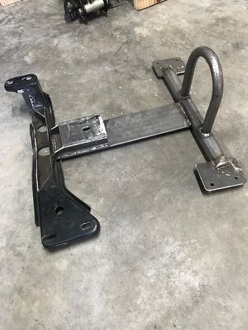

This is for my 2000SS.
I cut out the stock crossmember to clear the 4L80 pan. Then made a mount and attached that to my driveshaft loop and crossmember. I have to box in the stock crossmember a little, but it is pretty strong. It's all one piece.
