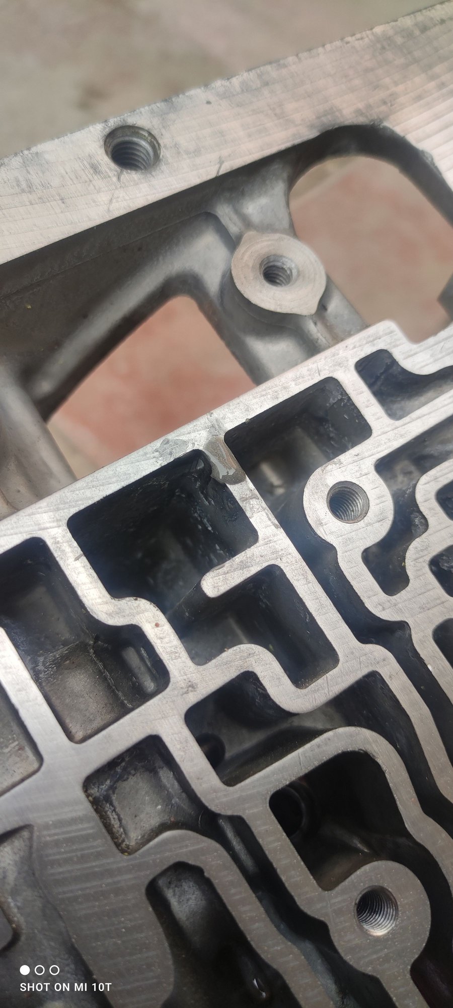

Hello everyone nice to see you all. I have broken my pump housing and went to junkyard to get another 4l60E case, however after cleaning, i found thet some of the channel have a grove. Wondering if I can fix it please share your thoughts

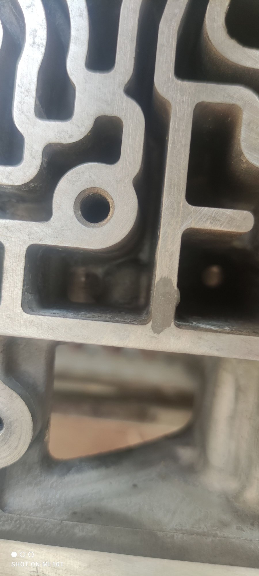

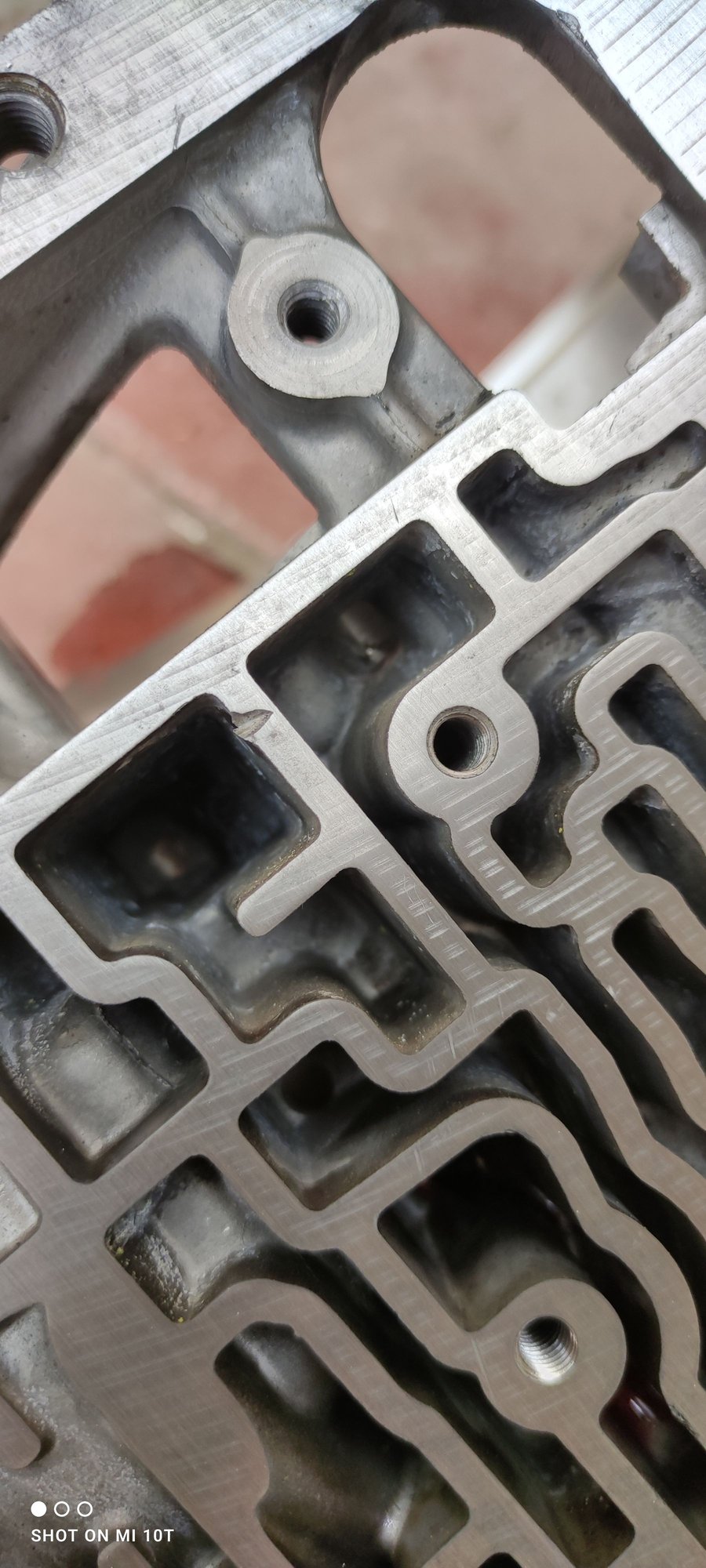

I just decided to fill the grove with epoxy aluminum welding and after sanding the results looks pretty good
Good quality epoxy weld
After leaving it to set for 20min
After sanding the epoxy with 400 grade sand paper,then the whole meeting serves area with flat rood and 1200 grade sand paper. I think this will be good to go. Please feel free to comment thanks

That is an appropriate repair in this instance.
It should hold just fine assuming you've block sanded the whole case passage area.
Your epoxy choice looks OK too.

I would have tig welded it, but it'll likely hold. Little things like that just chap my ***! glad you fixed it.
