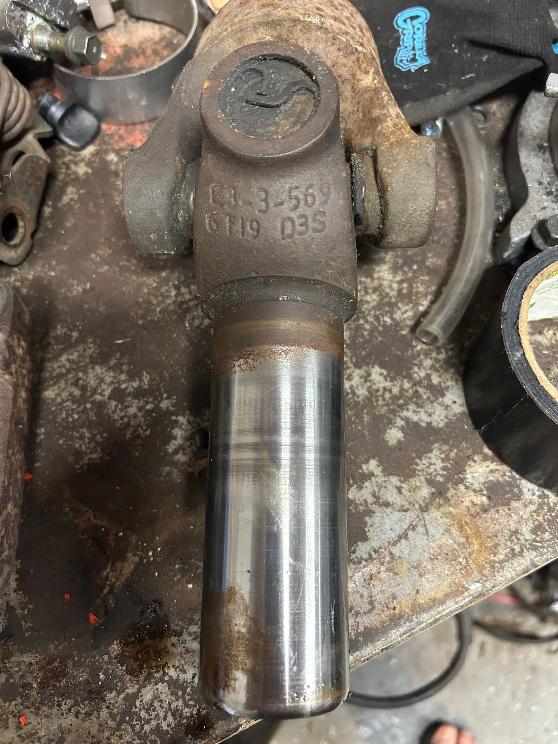

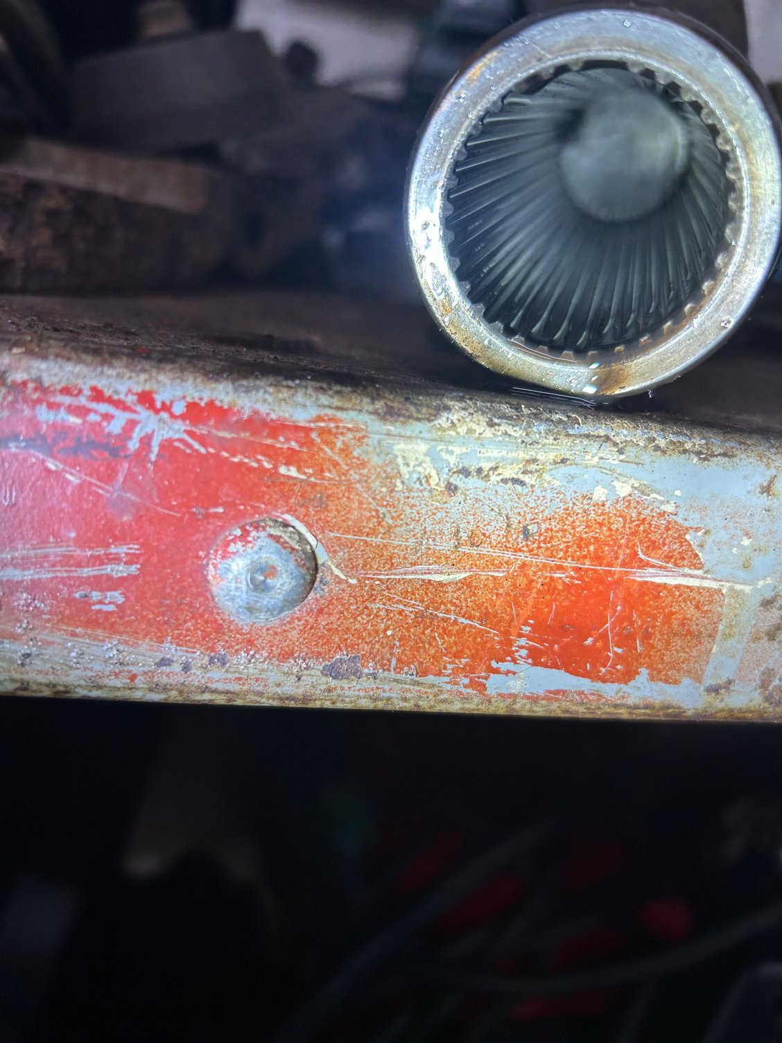

My trans is in the car and I didn’t bother pulling the tail shaft housing off before hand. The trans is from a 03 2500 2wd. I have the slip yoke it came with which is a spicer c3-3-569 5.5”. Does anyone know of a ujoint that will mate a 1410 yoke to a stock driveshaft or will I be okay with the th400 slip yoke?

The slip yoke you have pictured is for a full splined output shaft.
Because you know what it is from. You could ask at most parts stores for a conversion joint from that to another vehicle.
Make sure that they look in the paper catalog in the back is the conversion joints. They list by the 1350 or 1310 sizes. Get a part # for both vehicles/size and go to back of the catalog. Computer look up at this point is useless. Ask for the commercial guy if needed they are usually the most knowledgeable people there.
