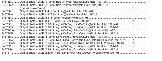

Now all that being said, there are MANY different output shafts. Check out pg 52 here:
https://www.wittrans.com/catalogs/witcatauto.pdf

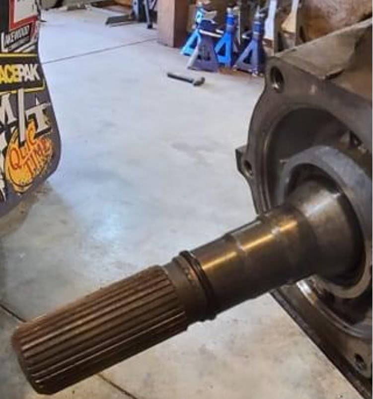

If my output wasn't fully splined and instead say it was like the one pictured below, I'd use a Sonnax T3-3-2431CBHP yoke on it.

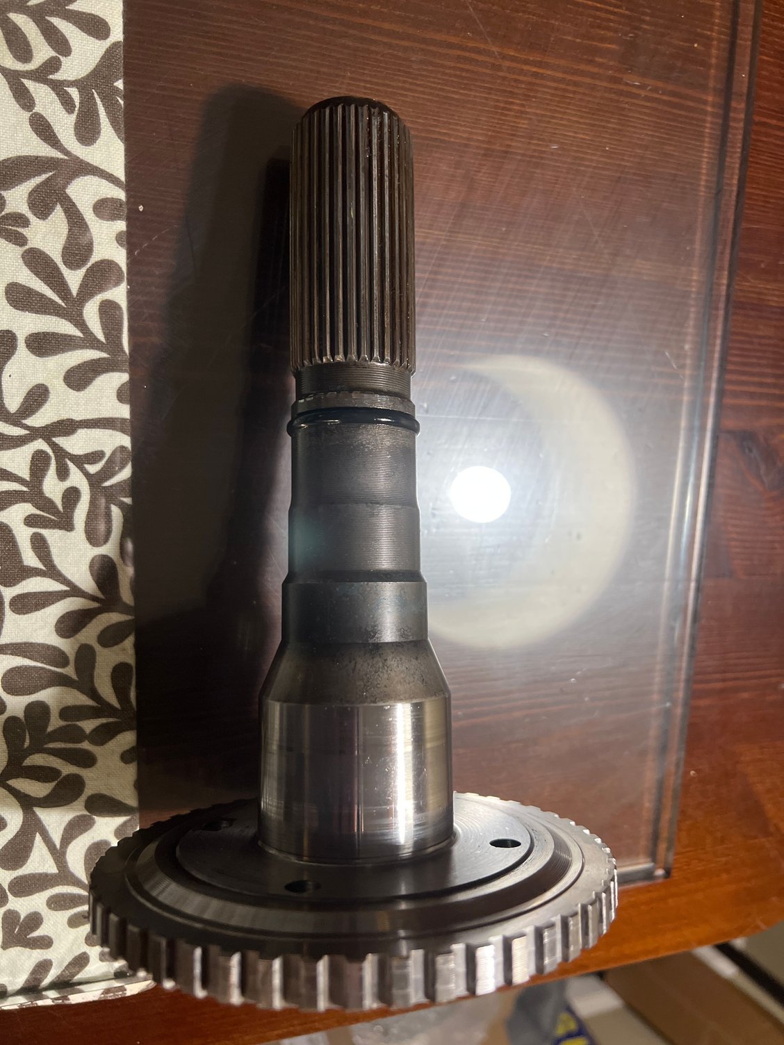

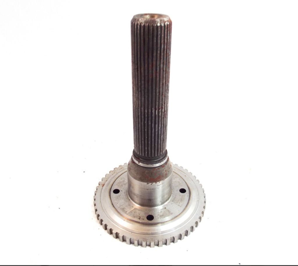

many thanks. Second picture is what I have (looks like the one you shared), then I bought a used one that looks like the first photo. Seller didn’t provide any part number.just said it has 5” of spline, no hole. Looks ok to me? I read all the posts. Thanks a lot.

Looks good!
