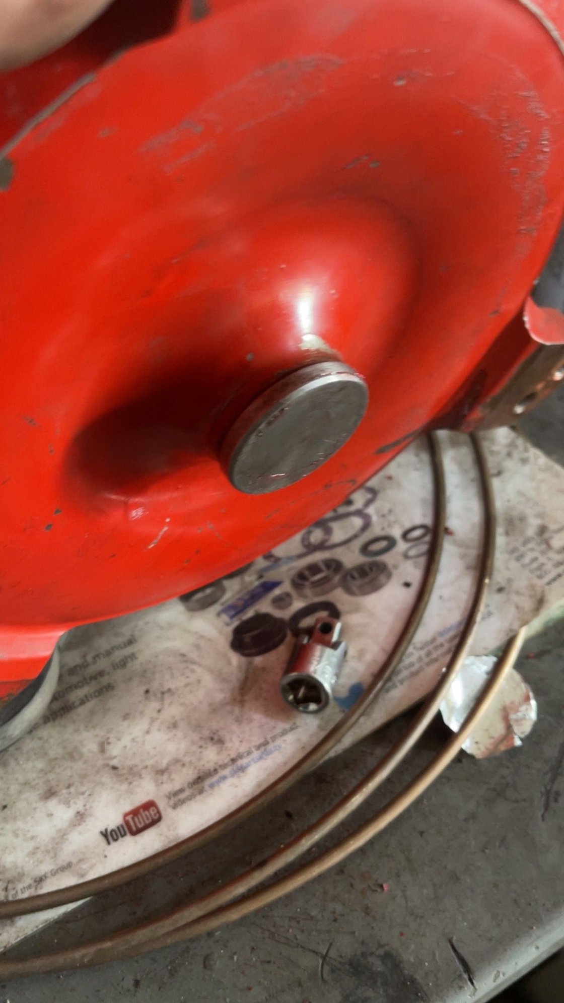

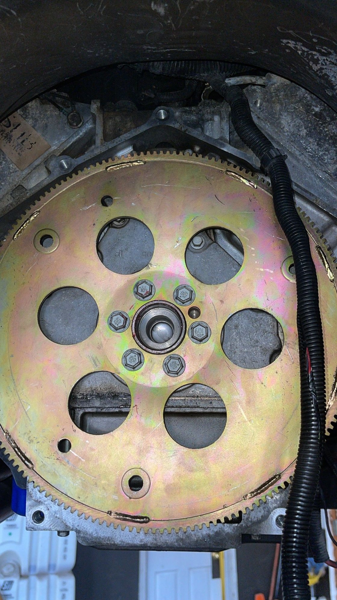

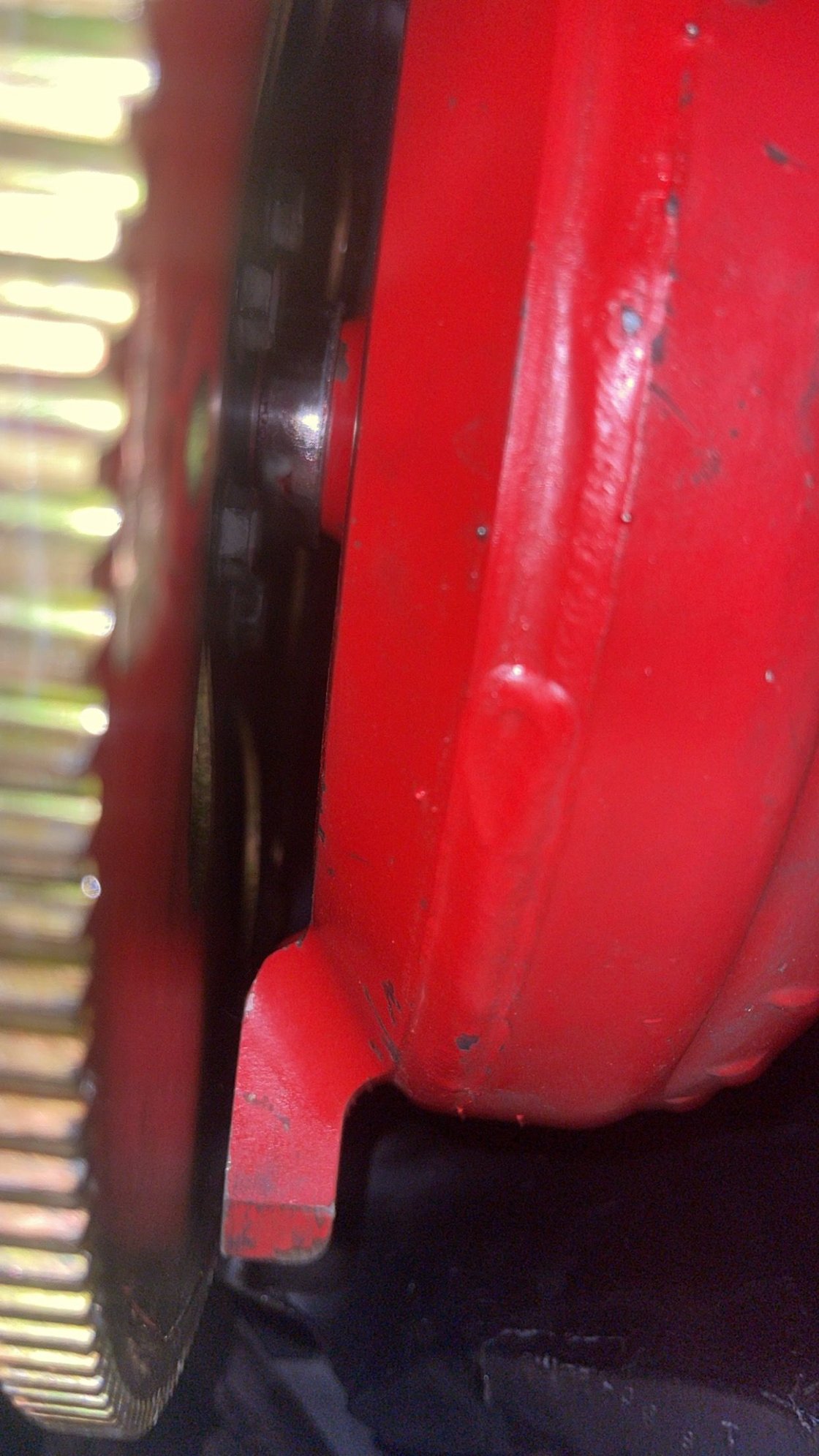

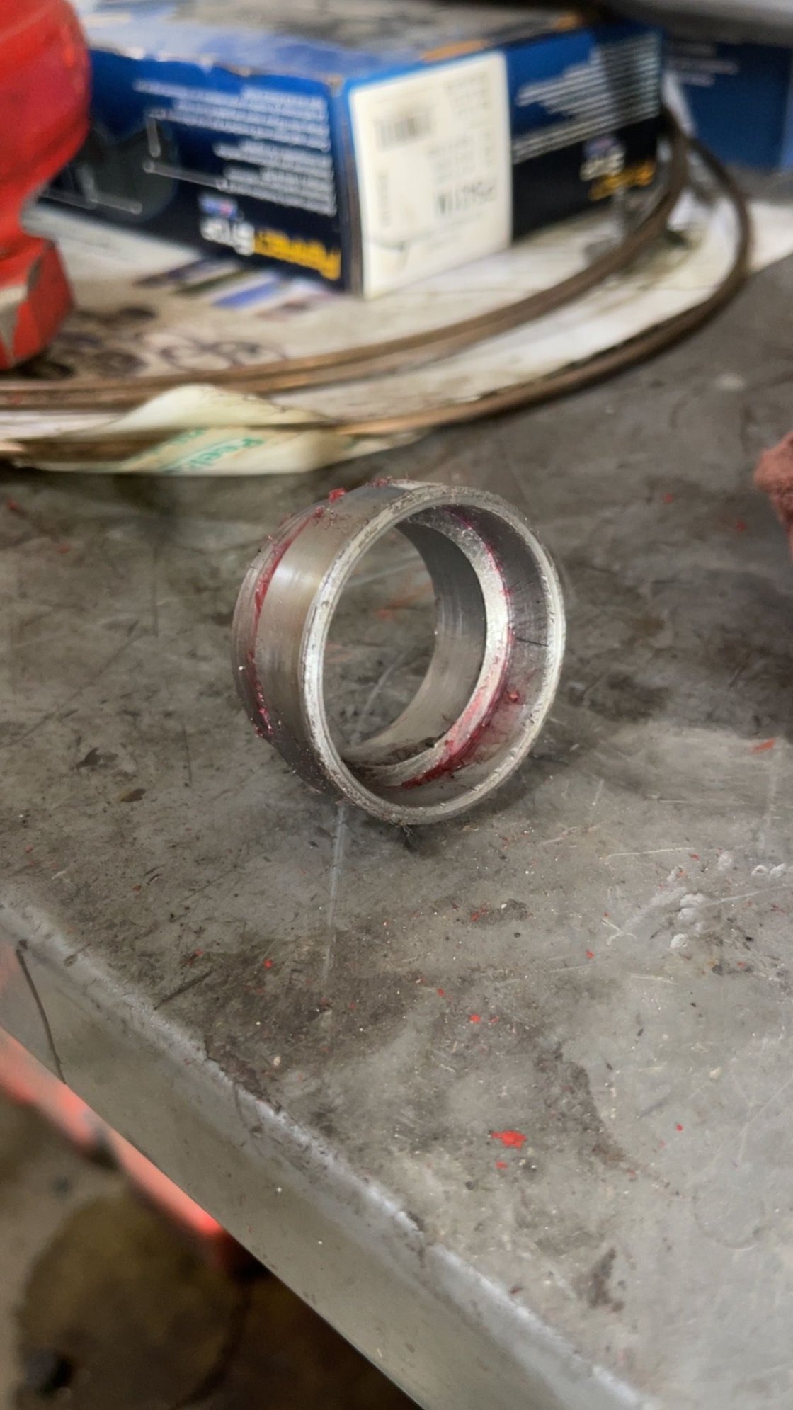

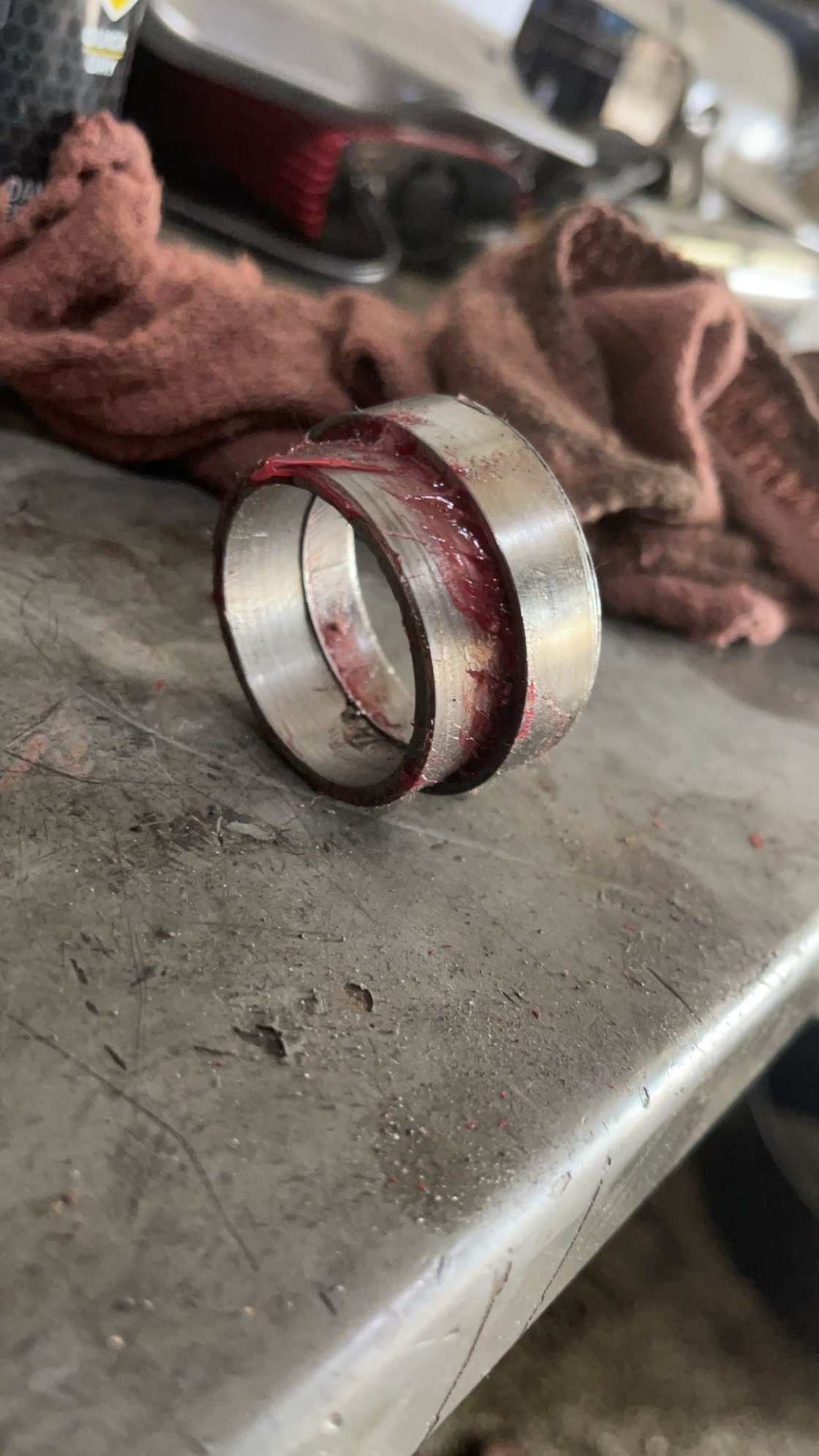

So I have an ls1 and a freshly rebuilt th350 with a Hughes 4500 stall converter I’m having an issue with the converter being to tight to the spacer and causing binding issues and I’d like to not worry about hurting my thrust bearing or trans pump I’m using a dished flex plate with the spacer and I’ve already taken .300 off of the spacer and I still have the issue I’d rather not buy another converter specific as I’ve already spent $1100 on the one I have now as of now the converter is all the way engaged to the trans but it’s also tight to the spacer so there is no room for movement for the converter to actually do its job anyone been through this before and have a remedy

Pull the converter back out and post photos of the converter pilot(piece that goes into the crank), pics of the flexplate where the converter goes in, and the adapter sleeve itself.
Also did you tighten the transmission to the block like this? If so were you able to get the case up against the block first or did you have draw it in?

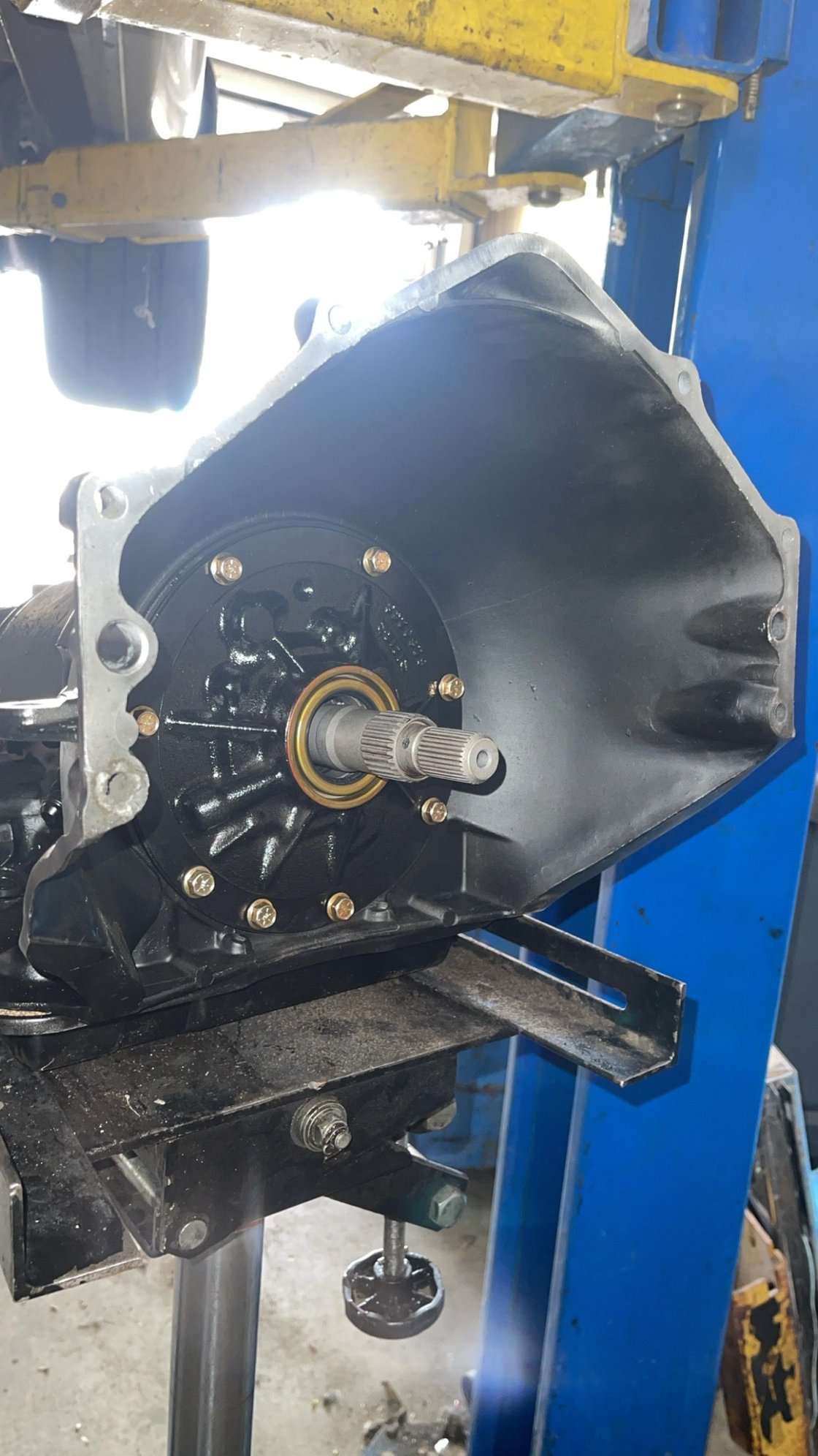

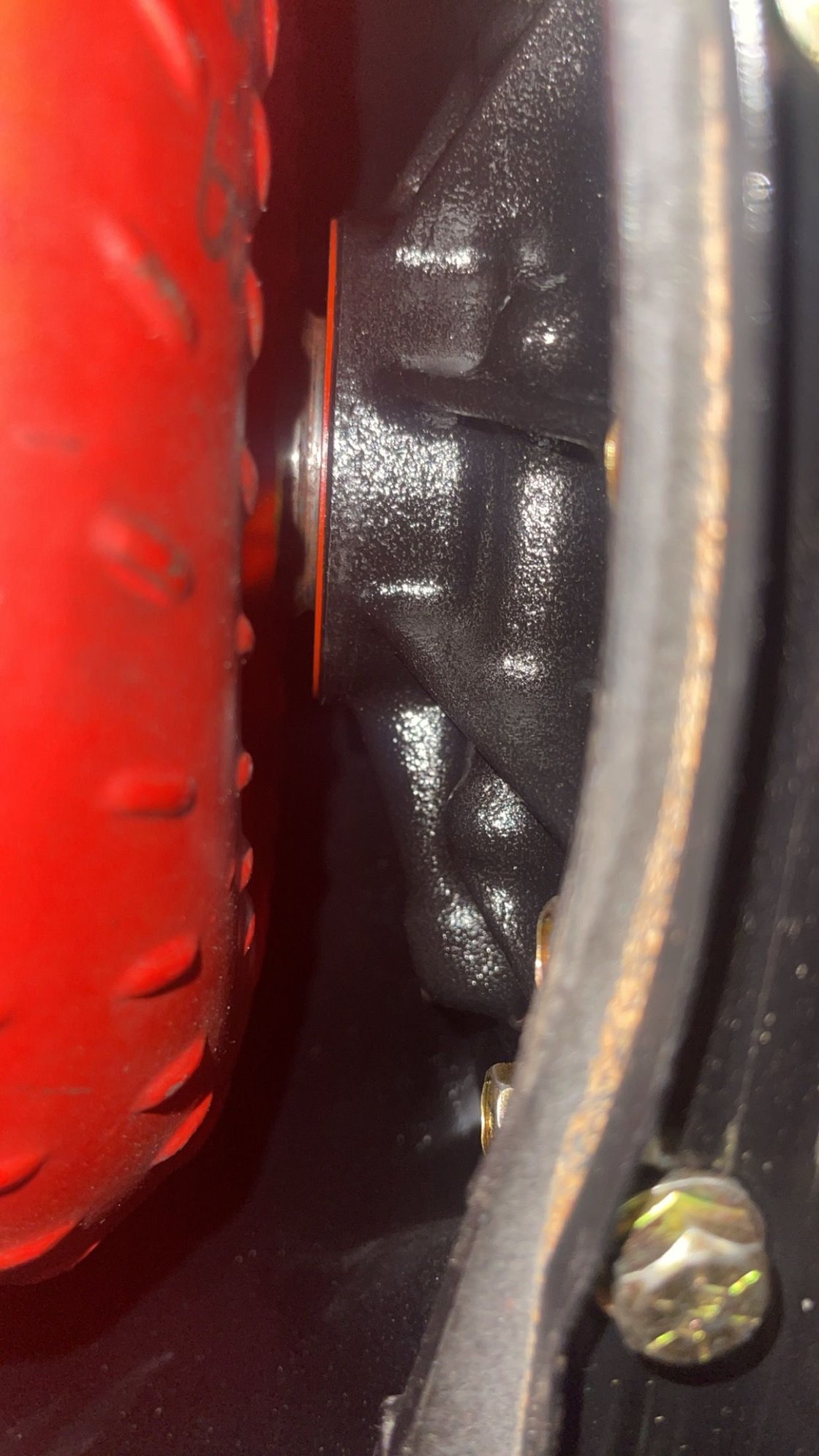

Hard to tell from your photo, but I'll mention it in case some other reader stumbles upon this thread in the future
SOME th350 have an issue with converter fitment due to the input shaft on the transmission.
SOME th350 (model year variations) got a longer chamfer on the end of the input shaft. That has the possibility of bottoming out inside of some aftermarket converters, especially billet front converters.
If this happens, you won't have proper converter clearance. And all sorts of issues will arise.
To check this, simply install the converter into the transmission and measure from the face of the bellhousing back to the converter bolt pads.
You should have over 1"
1-1/16" would be ideal
If you don't have over 1"...you do not have the converter to the proper depth
