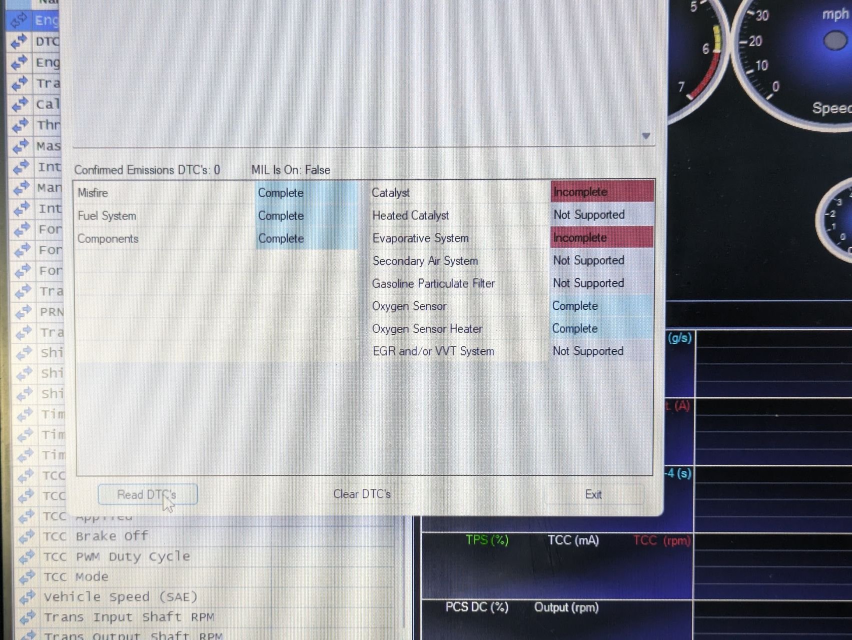

I hooked up my HPtuners interface and opened the scanner. I have a transmission layout set up. It had little to no load % change. I was able to apply the TCC & adjust my EPC Milliamp settings to confirm that the shifts got crisp. I found no misfire data.
I took a log file (3-28-24 gas to home) of the data from the PCM while I played with the EPC amp. You can see the .49amp desired and actual setting get commanded around the 2:15-2:20 mark. The transmission shifts much better until I turn that off later. You can see the load % against Throttle % is very low even at 25% throttle you only see 20% load.
I confirmed that there are no codes in the new PCM.
So to confirm that I’m not going down the wrong rabbit hole here, I installed the old PCM and took test drive and a log file (2005 Silverado PCM) of that. I have load % that goes to above 80% as it should. You can also see the TCC enable go to locked as it actually locks the converter.

As stated and you can verify by the log file posted that it can make pressure, show a load more than 80%, and apply TCC with the first PCM. If I install the new PCM I have the issue, put he old back its good again.
I don't need a pressure gauge to feel a commanded change to line pressure. It's soft at .98amp much better at .49amp and very harsh at .20amp. it won't go past 25% load and the PCM uses load to raise line..
The transmission made 220psi on my original pressure test after firing it up on first start and testing after the swap.
