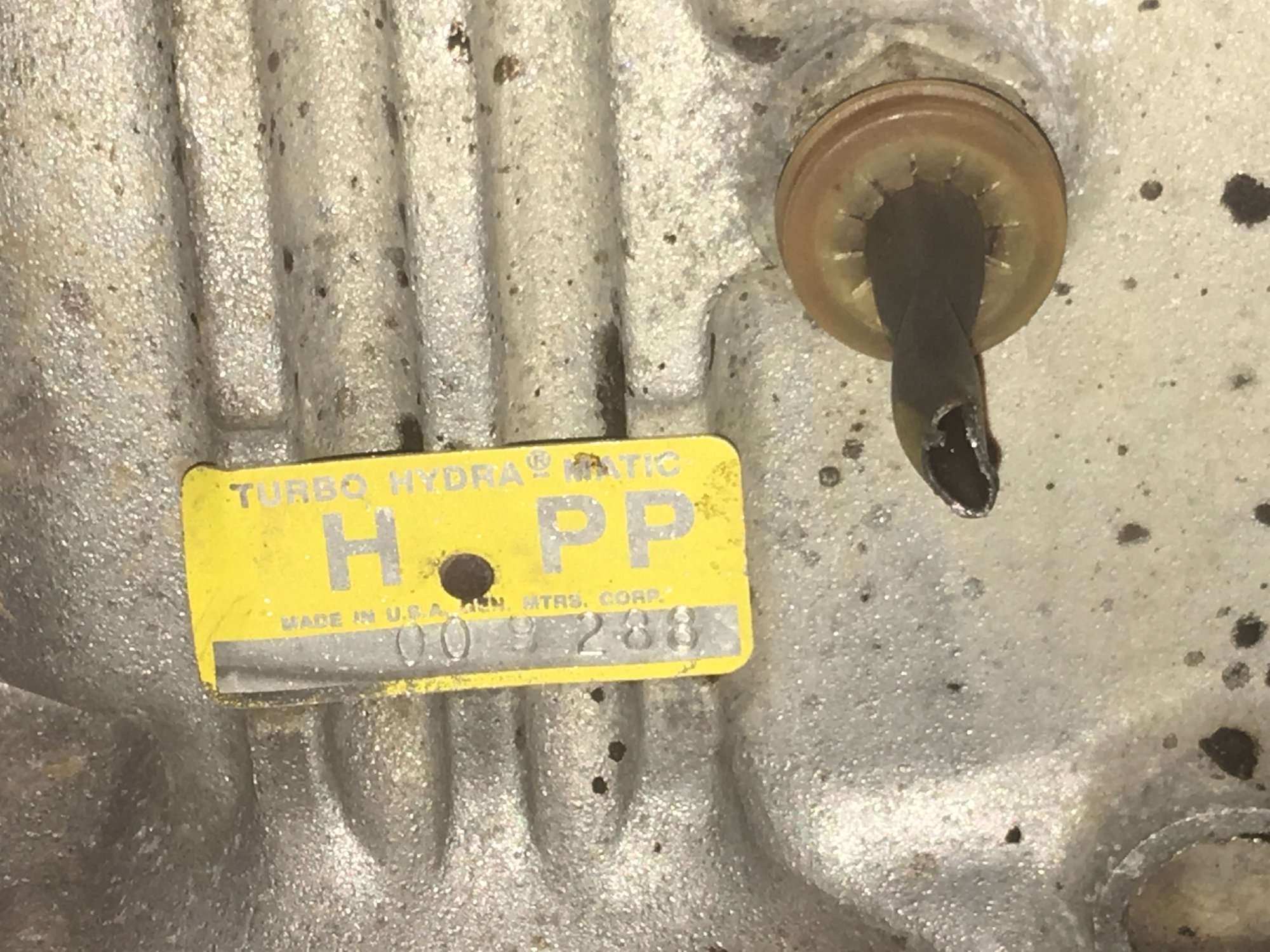

Is there a standard size u-joint for 4L80 transmissions or do they vary? This is the tag on my trans. I don’t know what year the yoke I have is from tho and it’s not with me. I only need the front.

It's fairly safe to assume that that is a 2000 transmission. Here is my 2000 model year code list...

If the yoke is from the same rig, 0HPP. That is a 2000 "C" truck or "G" van 2500 with a 5.7L, both 2wd. Those are both non LS based vehicles. That would take either a spicer 1350 or 1410 u-joint. Cap diameter are 1.188 for both but the cross measurement is different.
Whats the drive-shaft from?
Chances are you are looking for a 1350-1310/1330 jump joint.
Take the yoke to your favorite parts store and get the oldest guy there or the commercial parts pro

thanks for the info. I’m putting a 4l80 in my abody and need to get a drive shaft. I’ll go by Napa it’s the only “real” parts store we have.

It takes a 1410 in my case.
