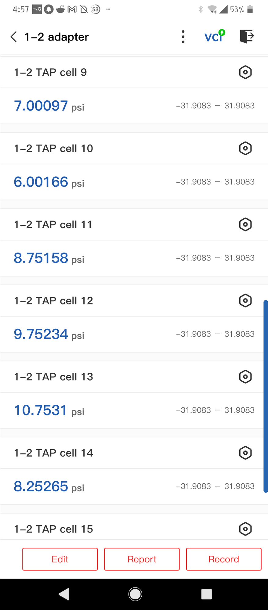

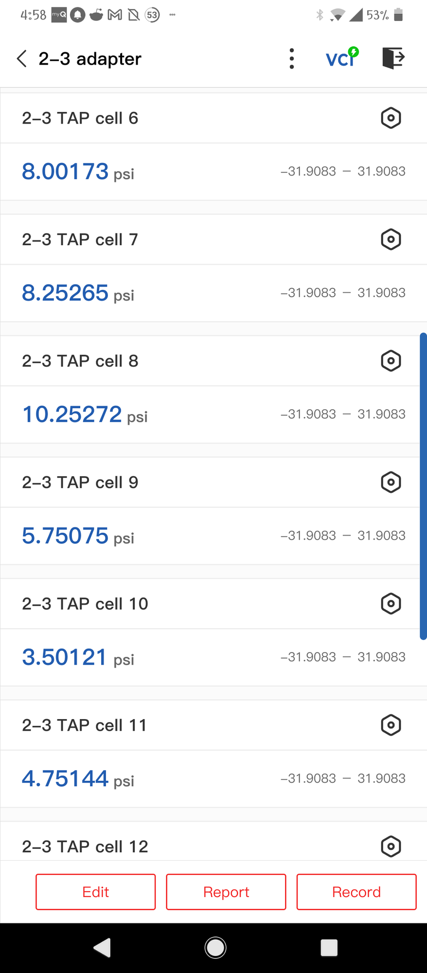

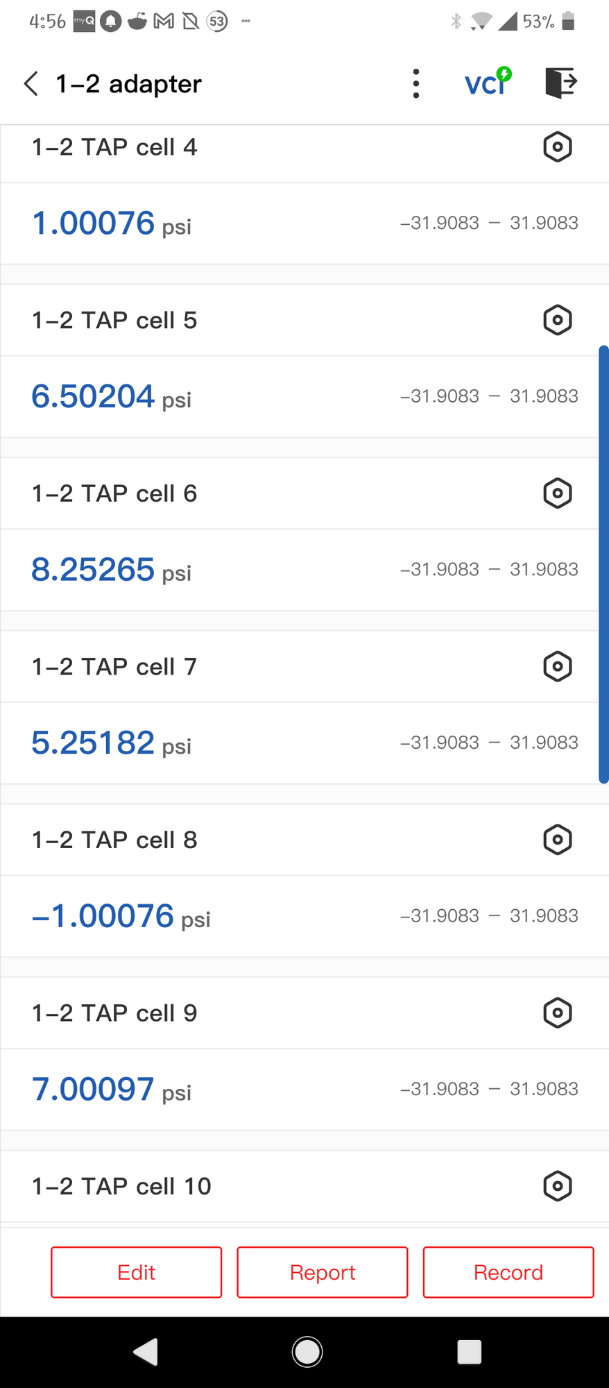

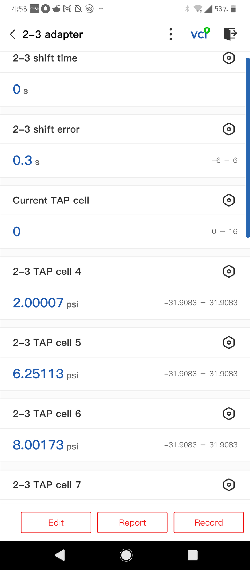

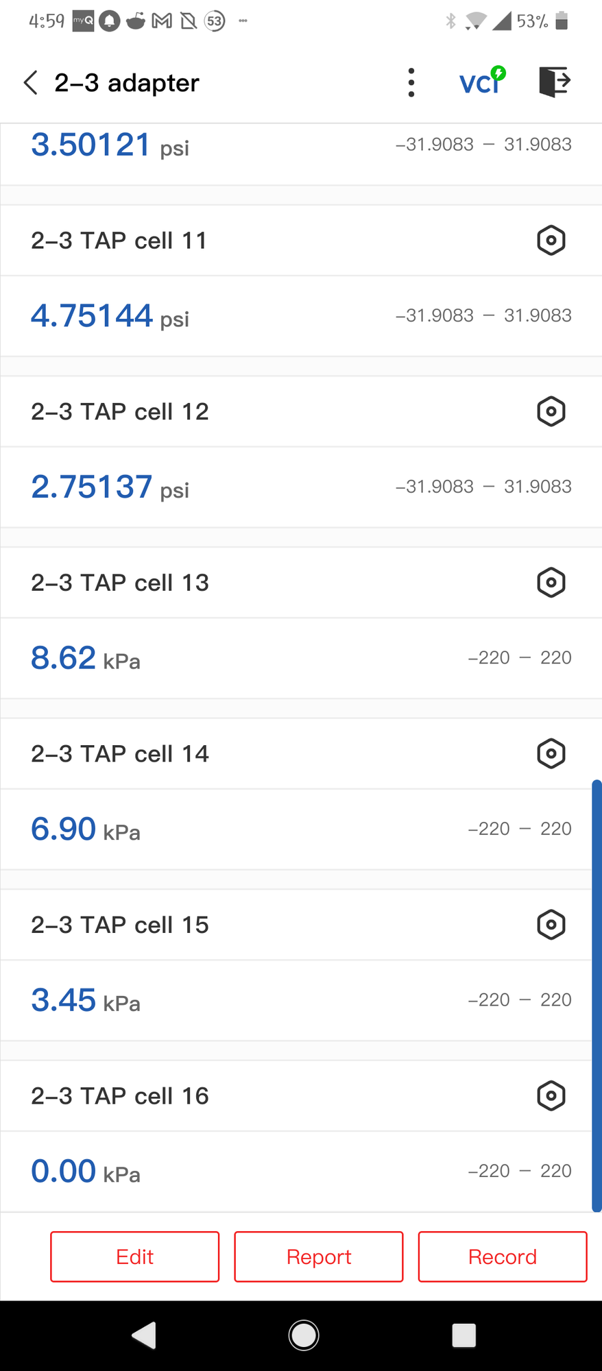

I'm trying to learn a bit about my high mileage 265k mile 4L60E and hopefully delay it's inevitable failure in my 2005 Silverado I use for work every day.....where can I find information about these adaptives and what is typical? Also when did they start using them? These screenshots are from my 2005 Silverado with original drivetrain, ECM and everything. I was told they didn't use adaptives until 2007 when they added the ISS but as far as I can tell my truck has them.

They existed long before that. My 95 ss has them , They can kinda mess with you on a performance build or shift kit, When I first built my trans and got going the shifts were perfect, Nice a firm, But in a short time then weakened a lot, I went in the tune looking and found a table. It's not called adaptives but that is what it is and it had actually pulled the shift pressure down and the 2-3 negative -4 not sure how much that changes stuff but I set theM and fixed them to 0.00 and did not have the issue again they stayed,

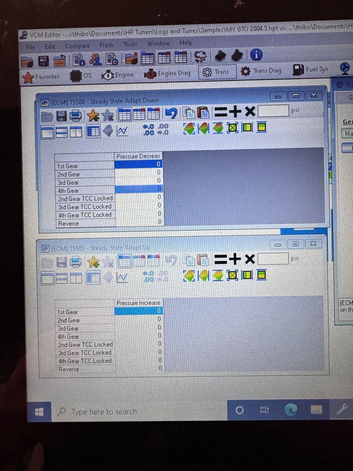

Id figure out how to turn it off. And then turn it off. Check on the hp tuners website. I have a 2004 gto and my settings seem to stay. This is my settings, all factory.
