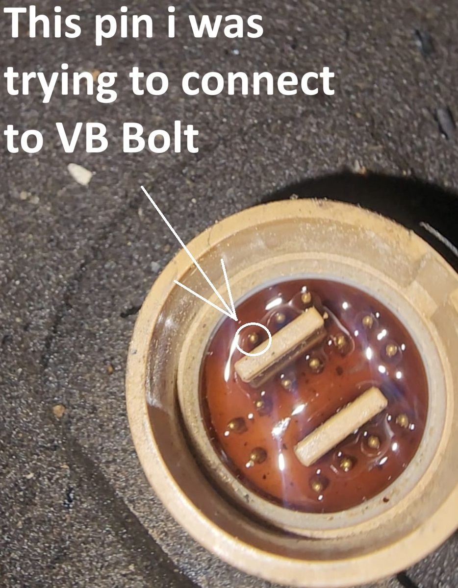

Hi everyone.
I have a 4l60e with 3 wires ISS and T42 24239926 controlling it.
Suddently, i lost the ISS signal to the TCM, Codes that pops up : p0741, p0717 with really harsh shifts.
Logs on HPT shows no ISS signal at all in any speed.
Tried to replace the TCM - No luck
Replaced harness - No luck
Dropped the Pan, spliced the V wire (DK/GRN) on the connector and connected the ISS Ground to the VB Bolt - Blows my Trans fuse in a fuse box.
I have checked the ISS itself with plug disconnected for shorts with a multimeter, no shorts were found.
What could be the issue? Is it possible to tune out this ISS or fix it without removing the trans?
Thanks!
2008 4.2 Trailblazer
This is how i found my connector when i first dissasembled it.

Originally Posted by FranksCustomTrans
Now it is my understanding that in 2007 and 2008 the ISS was strictly a diagnostic tool and while it will set a check engine light it should not otherwise affect trans operation. p
Hi dear Frank and thanks for your reply!
In my case, it is a big part of torque management and somehow jerks with the TCC.
It detects slip on the TCC because the ISS has no signal, and commands way higher line pressure. Thats why 1-2 and 2-3 gears bangs on a super light throttle.
It has something to do with TCC Duty Cycle stuff.At least, thats what ive read on other forums.
Maybe this is complete BS but pros here will correct me.
And i will be more than thankfull if there is a simple fix and it will save me from pulling out my tranny
