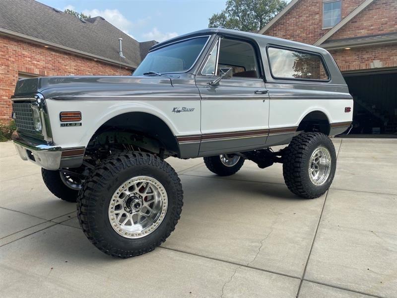

I def dont have a recommendation on your issue, but damn it thats a clean Blazer!
