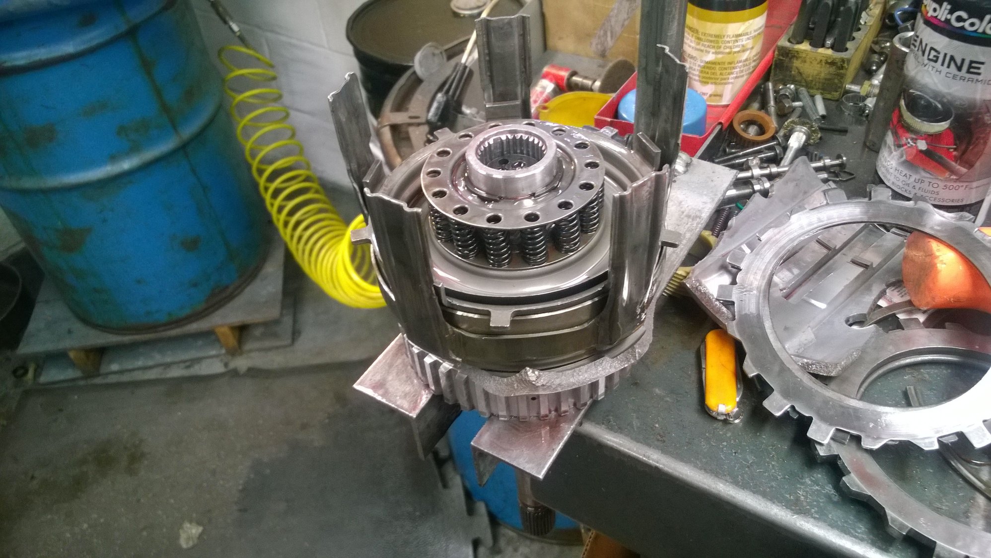

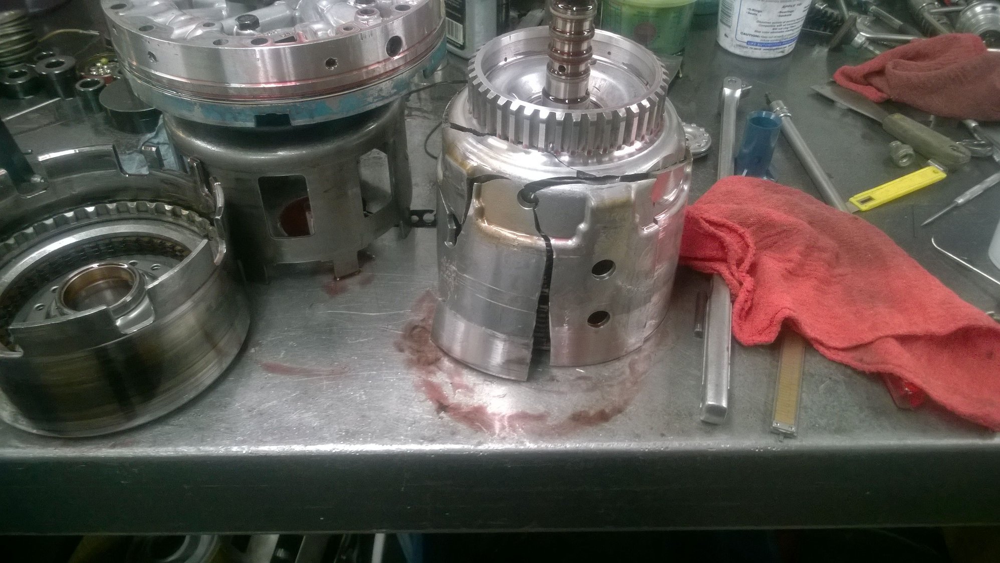

Here is what happen to a 2005 TB 4.3L transmission 18 month after a rebuild.

Not saying this is what happened with this one clearly, but this is @MaroonMonsterLS1 issue with the billet collar from Sonnax. The drum will find another weak point
