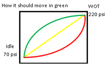

The pressure curve is more like this.
Engine torque is is built on the low end. Torque is what will slip a clutch pack more than HP. So the pressure curve goes high at first and usually cut's back a bit with MPH. The PCM's are calculated that way.
Throttle will drive the pressures high too. Don't be surprised if you see 300psi in reverse at heavy throttle.
Here's a pressure guide from an early 4L80 GM hand book
Gear Range -------------------------Line Pressure Range
Drive, Park or Neutral ----------------35 - 171 PSI
Reverse ----------------------------------67 - 324 PSI
