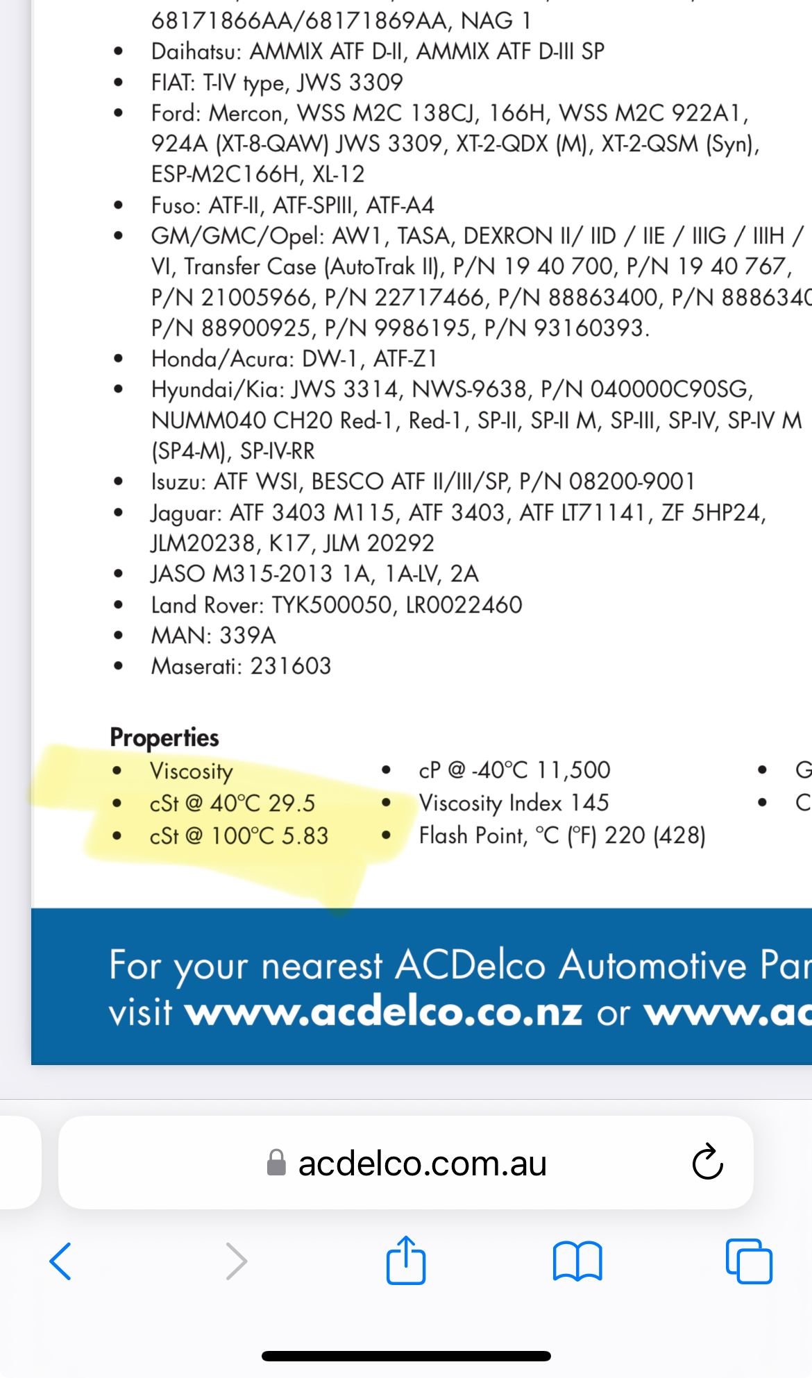

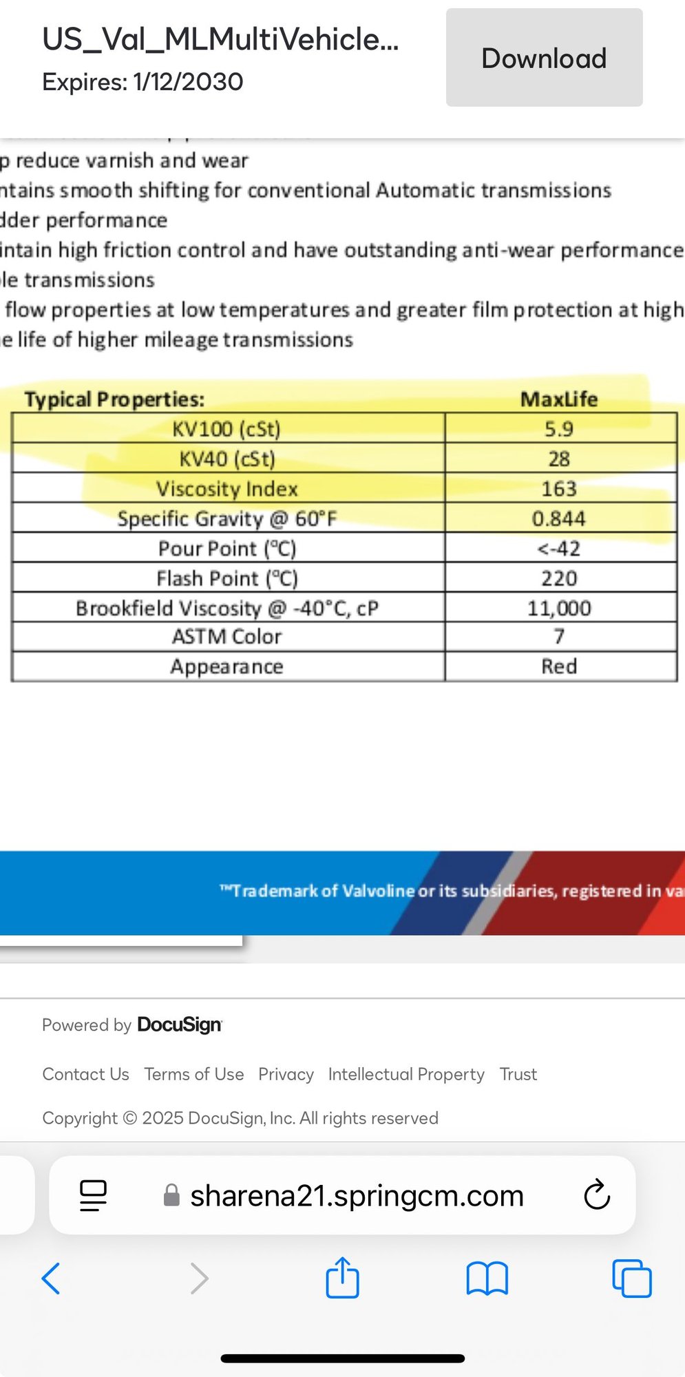

Fun fact- AC Delco’s Dex Vi is a little thinner than Valvoline’s Maxlife. Just by a little though. If memory serves, Dex III was thicker than both.
Delco Dex Vi
Delco Dex Vi

You are correct, that is a negligible difference between those two brands.
Yes Dexron 3 is inherently thicker because it is a mineral oil base stock. Valvoline shows it a 7.1 viscosity at 212 degrees and a 34.5 at 104 degrees. It got a lot thicker at "0" degrees.
That is why the Dexron VI gives you a better cold drivability.
