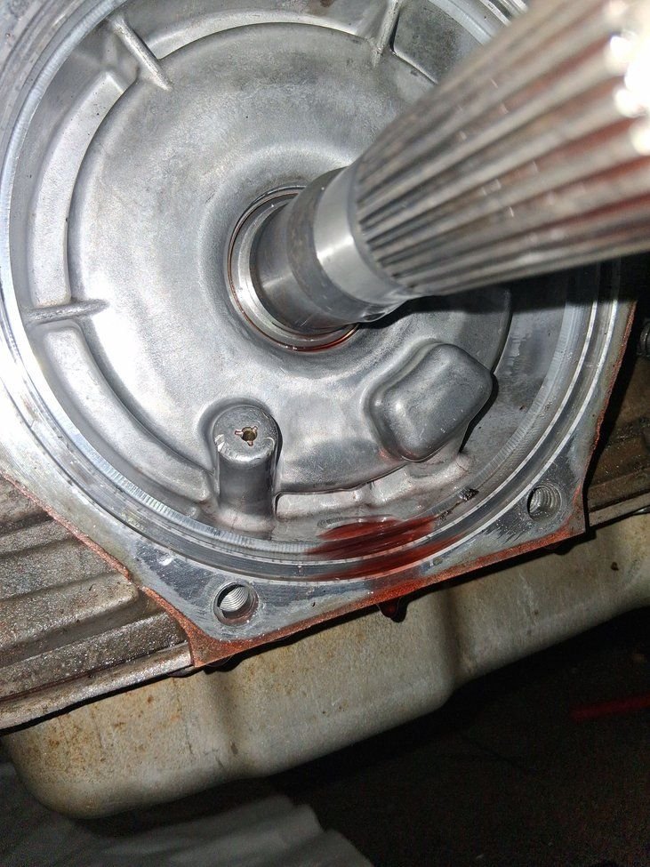

ANy idea what this is???
Old Jun 14, 2025 | 11:22 PM
ani987's Avatar
Joined: Jun 2025
Posts: 13
Default ANy idea what this is???
There has been leaking fluid coming out of the tail extension of my trasns so I took it apart to see what it was? I still have no idea what that hole is or what it does? What is it for and why is it leaking? Also can I just plug this hole up?
Old Jun 15, 2025 | 10:00 AM
bbond105's Avatar
Joined: May 2012
Posts: 3,052
Likes: 716
From: Poplarville, MS
That is the drain back hole for fluid that is in the extension housing. The fluid is coming from the extension housing to case o-ring, extension housing seal or the back of trans or extension housing is cracked.
Old Jun 15, 2025 | 11:16 AM
ani987's Avatar
Joined: Jun 2025
Posts: 13
ah no its a 4x4 transmission, the leak was because I thought the tcase adapter (extension) was a dry cavity like it is on the new GM 1500 and 2500 trucks. my ignorance ceases to amaze me.
