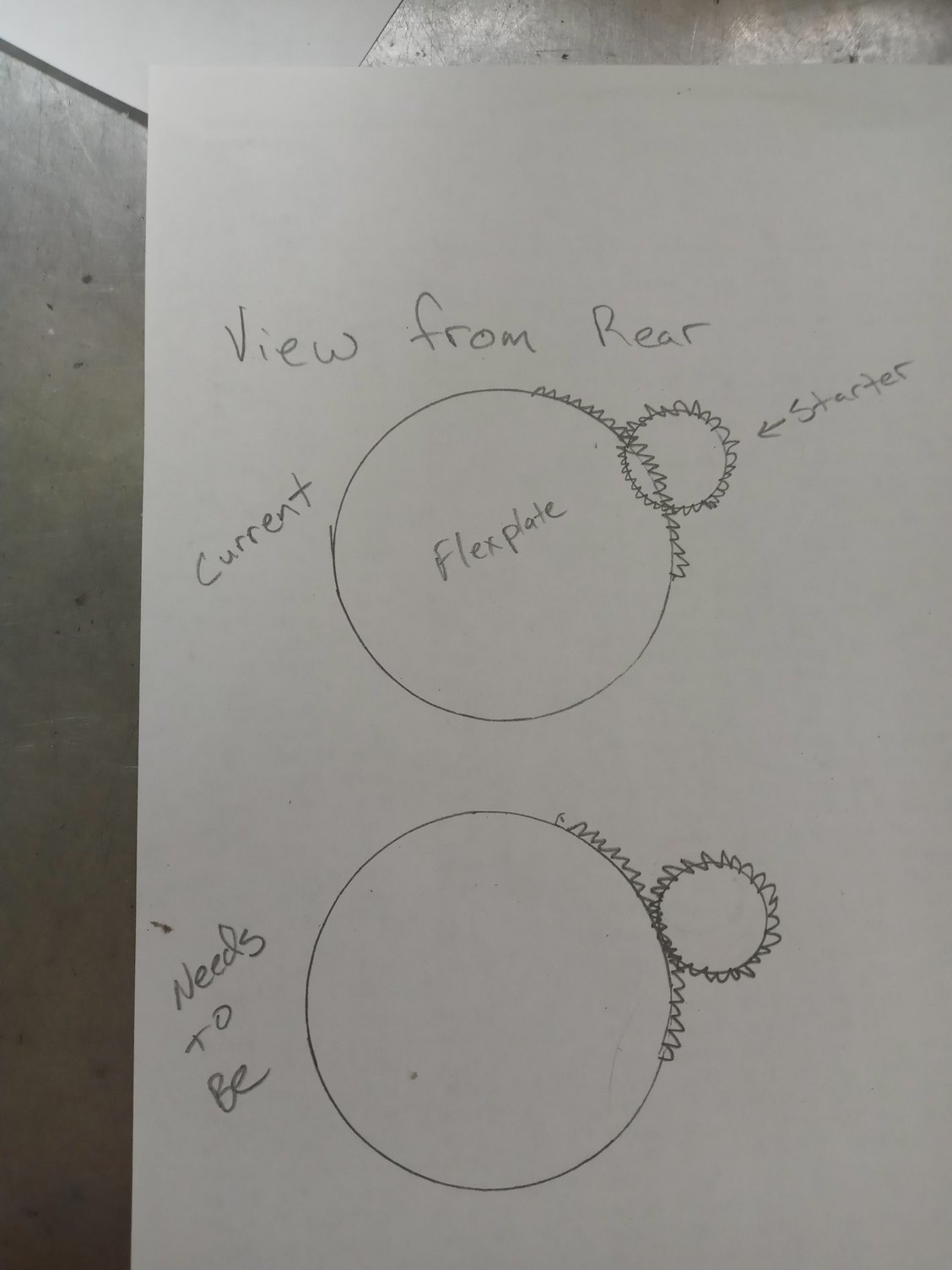

we’re having issues with my LS swapped bronco. It’s using a gen 3 block and a 2005 4l80. The gen 3 block takes the regular flexplate with spacer.

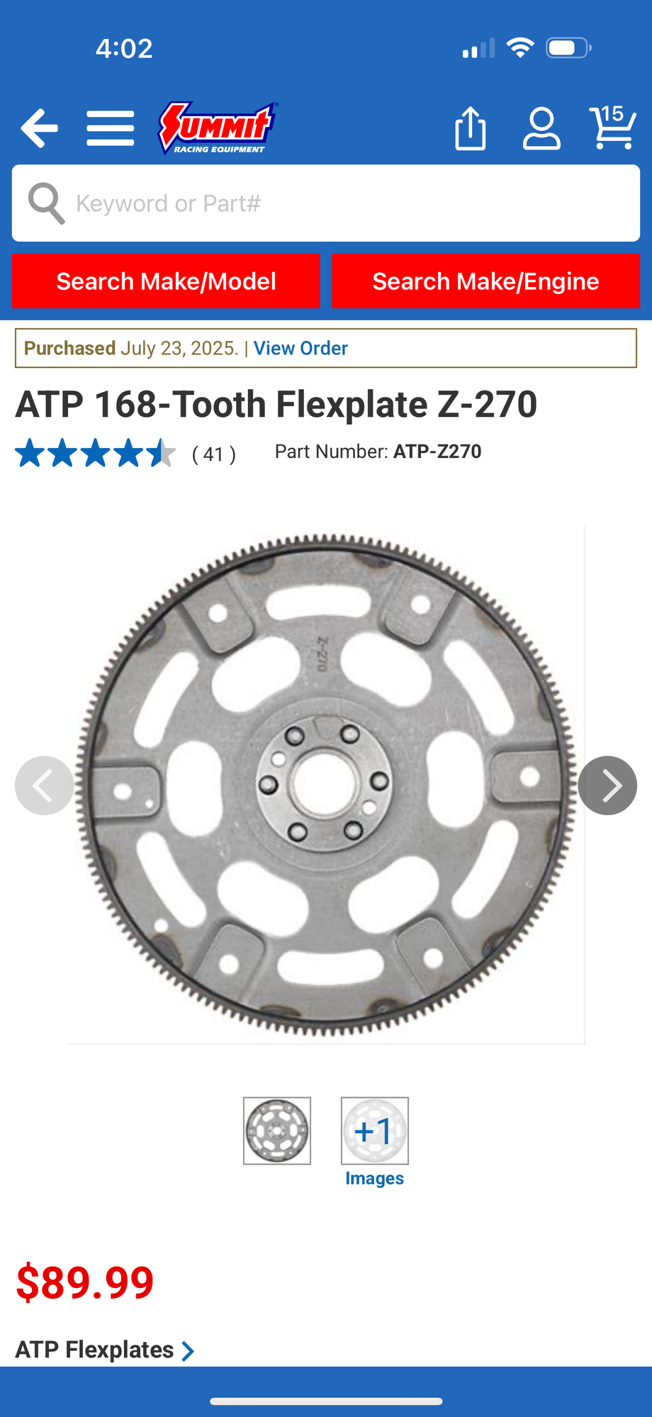

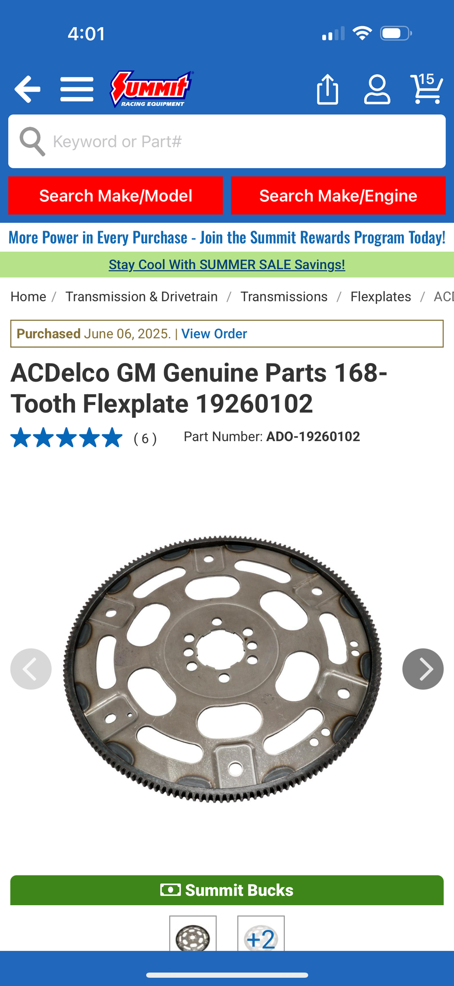

originally I ordered a ac delco flexplate that needed a spacer. Instead of buying the spacer I bought this Flexplate.

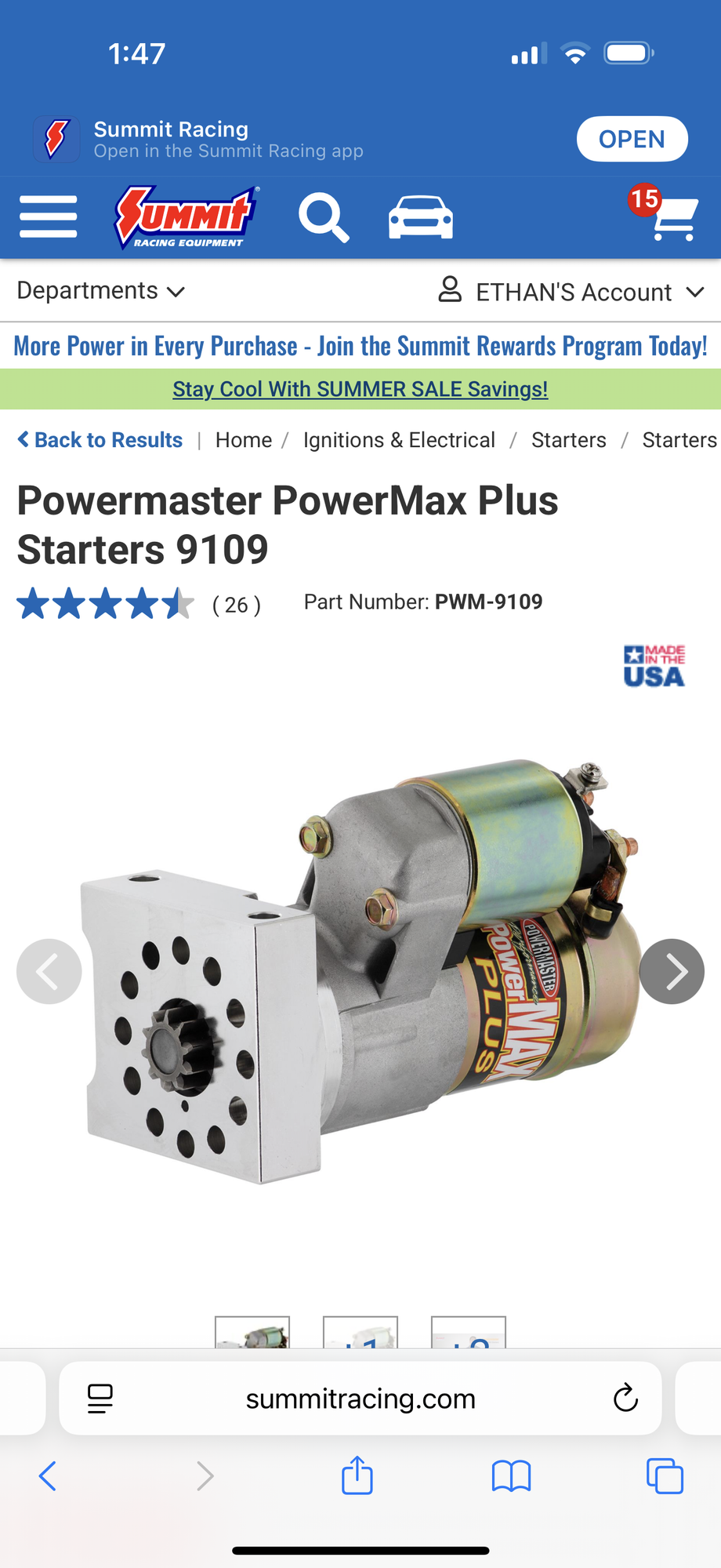

Mounted the starter pictured below. Looks like it needs a 3/8” spacer to align right with the Flexplate.
We are stumped at this point. Measured both Flexplate at 14.13” diameters. See the picture above. I went and bought a Napa starter today for a 2005 Silverado 4l80 and the mounting was the same as the power master unit. It needed a spacer. So this, to me, means the Flexplate is wrong. I have no idea on where to proceed but I’m running out of time. Need to get it finished and transported across the country. You can’t really mount a flexplate incorrectly. So it has to be the flexplate since the starter has been ruled out.
does anyone have any thoughts?
