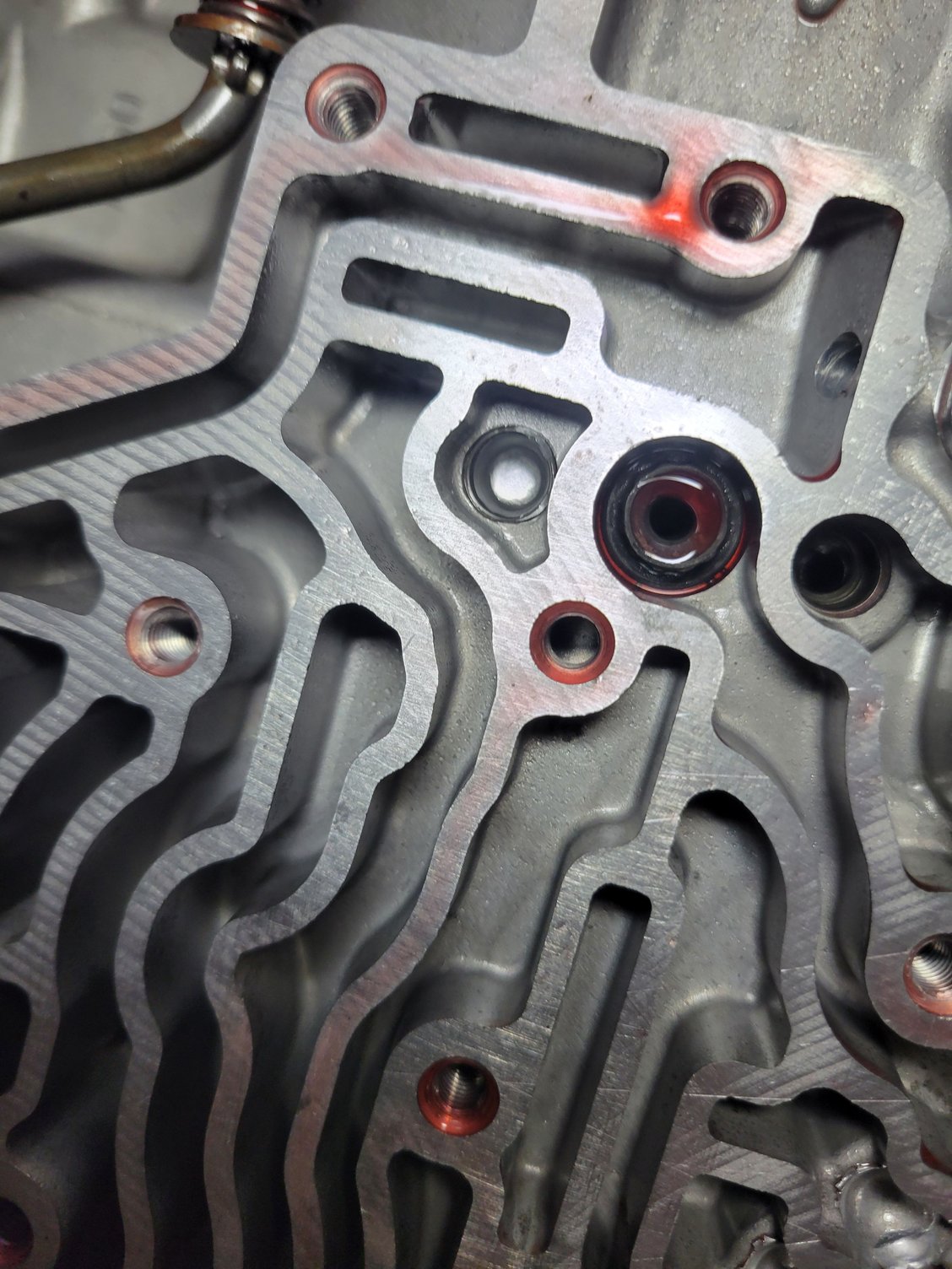

Old Sep 13, 2025 | 10:04 PM
Jarrod S's Avatar
Joined: Sep 2025
Posts: 3
Dual feed id say.   I pressured everything i could except a couple places along the front edge that i couldn't get to when i had the valve body off.  Everything made a thud sound and i never heard air pouring out anywhere.
