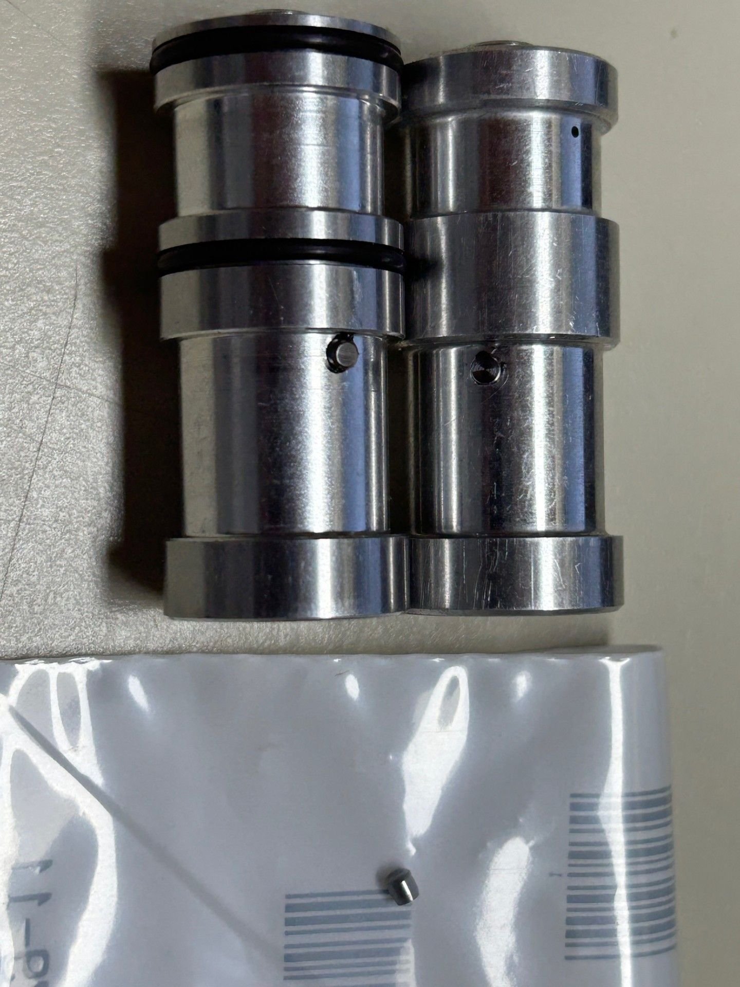

One of my auto shop employees, who is also a machinist, suggested tiny dowels which we just ordered. They are 0.093 diameter and 0.125 long. Drilling the holes a bit bigger, I think they will fit and can be pressed in. I was reminded these plugs need to withstand line pressure.
@V8fan I now understand your suggestion after disassembling a spare pump. Also non-trivial as you have to press a plug into an inner passage and the only room you have is through a 3/16" passage after drilling out the plug near #237. My plan A will be to plug the two holes in the boost valve sleeve with the tiny dowels we are getting. Your pump modification will be plan B. Thank you!

I blocked the reverse feed holes in the boost valve with tiny dowels, inserted back into the pump and just tested it with a pressure gauge.
At idle I have 75 psi of line pressure. (Cold start, 65F.)
Moving into Reverse, I see a brief jump to 100 psi, but then settles back down to 75 psi. Engine has a hiccup but does not stall. (Not sure if the hiccup comes first or the 100 psi spike, but previous Reverse pressure was about 180 psi.)
In Drive at idle pressure remains at 75 psi.
To ensure I reassembled the boost valve correctly, I blip the throttle and pressure jumps to 150+ psi.
Overall, this seems to be a success. I may not be able to drive the steep hills of San Francisco in reverse, but I only need to crawl in reverse on flat roads.
In detail:
* I purchased a new Sonnax 4L60E-LB2 on which to make the mods. I also had a spare stock boost valve for experimentation.
* We purchased an assortment of tiny dowel pins from McMaster-Carr in Aurora OH. Determined that their #98381A180 dowel pin of 3/32 diameter and 3/32 length worked best. (Bought 4.)
* Determined that a 0.089 drill (not a basic size) worked best by first testing on the spare stock boost valve. Ran the drill back a forth a few times to open the hole a bit more and clean it.
* The dowel has a tiny bevel. Maneuvering this tiny dowel was difficult. My shop machinist stuck the dowel onto a channel lock plier with some RTV and that worked like a charm. Moderate pressure pressed the dowel in via bevel side. Checked that the dowel did not protrude into the inner area nor past the outer lip of the boost valve. The second one was a bit more difficult because I didn't want to press against the first one while pressing in the 2nd. A flat piece of steel helped.
This picture shows the result of testing on the spare and then the actual mods to the Sonnax boost valve. It also shows how small and short the dowel is.
