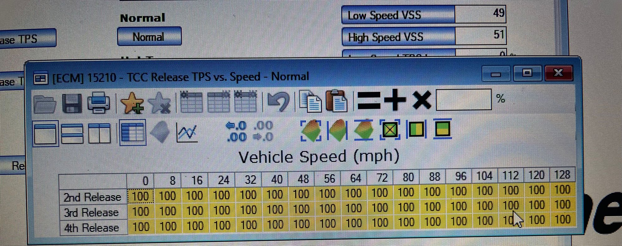

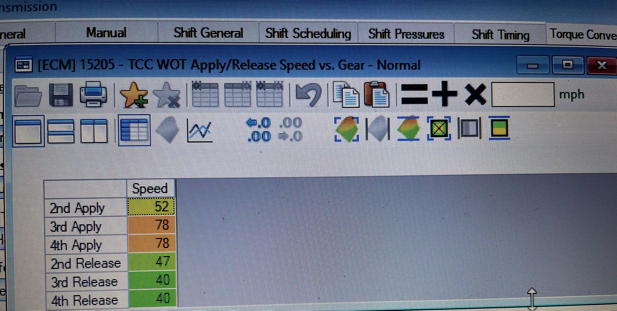

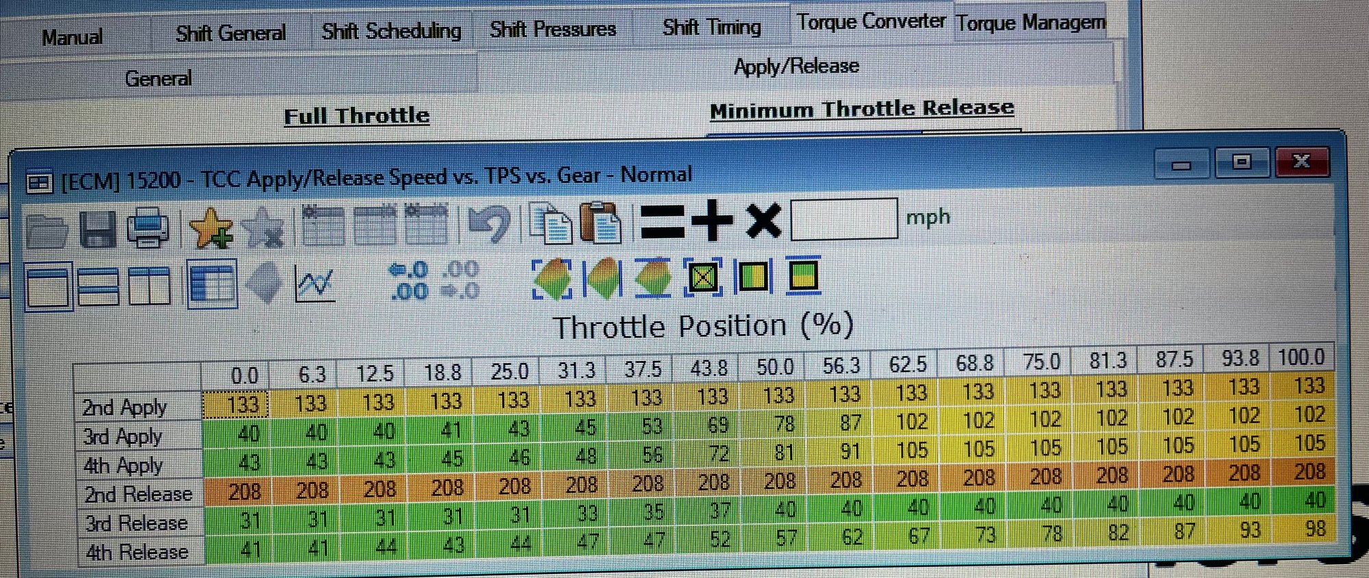

Based on these charts it should or shouldn’t be locking converter in 3rd during normal driving?
and it’s not commanding converter lockup at wot correct?

Let me start out with I am new my self at HP TUNERS however that does not look right to me though I could be wrong , Here is a pock of mine with stock table as while I have a triple disc and do plan to loct at top of 2nd and 3rd at WOT above 4000 RPM I have not yet done so ,
May be an image of text
Now these numbers are based on a 3.08 rear ratio with P275/40/R17 TIRES and I am not sure what yours is .Perhaps someone else will chime in with more tuning experince or consider posting your issue in the tuning section along with these tables for input.
