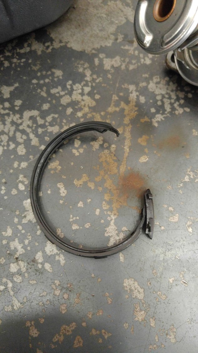

So the engine hot-ac off showed up again and I decided to change out the ECT sensor which didn't fix anything. After that I went ahead replaced the thermostat and that fixed it. The seal around the thermostat was not in a circle as it should of been. So far it's been driving well with out issues. Thermostat seal gone bad
Thermostat and housing with diffective seal
