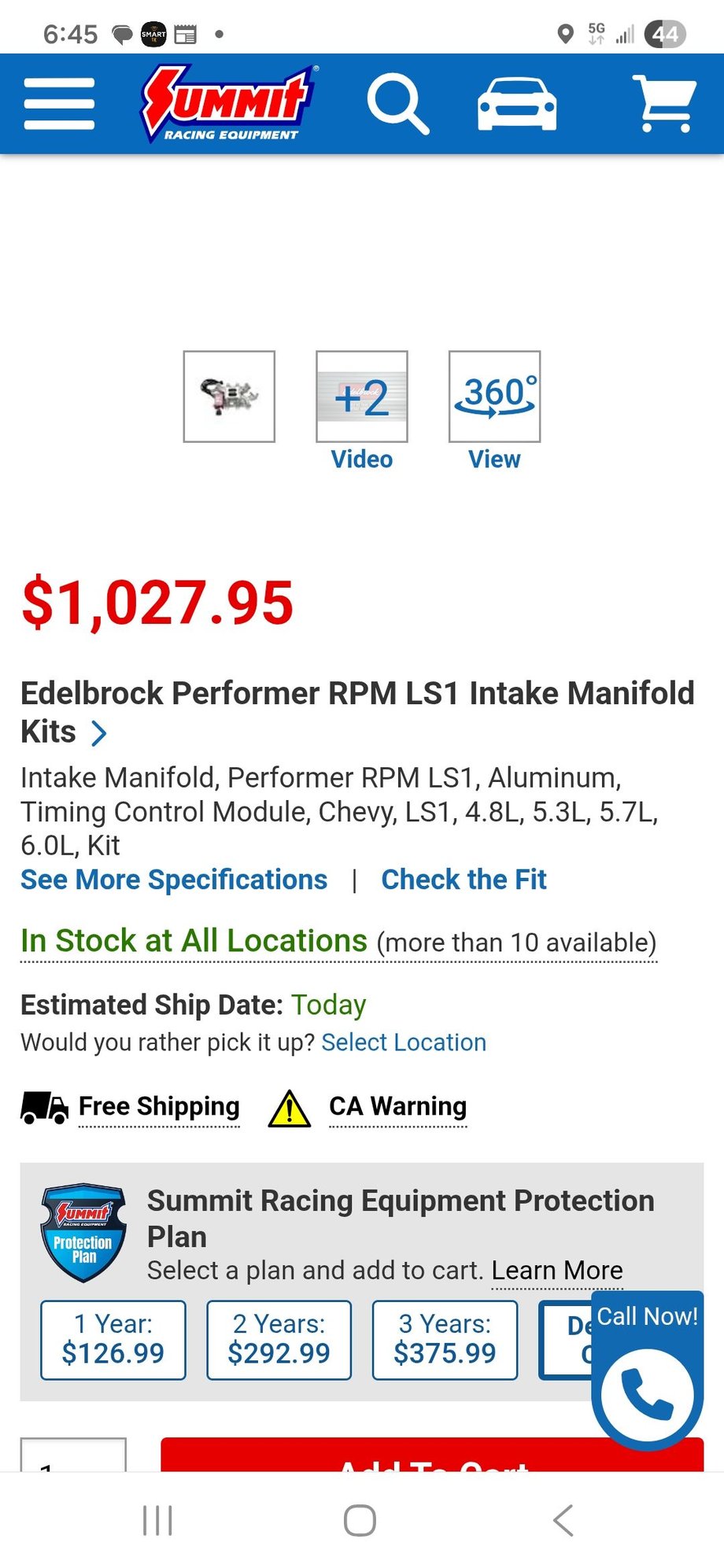

thanks.wow thats expensive

hey can i skip the wiring flash thing? id be interested if its plug n play

It's plug and play the ignition box has two leads to connect to the coil packs. I watched a video the other day where for about $200 the guy modified the cam sprocket and timing chain cover to run a distributor. Before I went to all of that trouble I'd just buy the timing cover that allows you to run a distributor off the camshaft. JESEL makes a nice setup but they're expensive and it's not something you'd want for a street ride.
