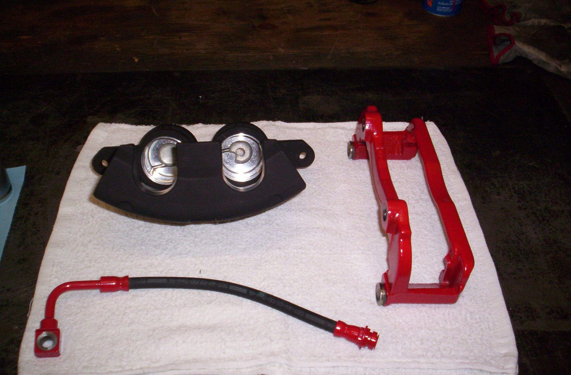

I used a die grinder on the bulk of the parts and then a small tooth brush size wire brush for the tight spaces. Then cleaned with acetone and painted. I used VHT caliper paint for the red on the bracket and the 2,000 deg header paint on the caliper in flat black. There is a guy that drives a new C7 vett around my town that is silver with yellow brakes that looks good on that color car.
