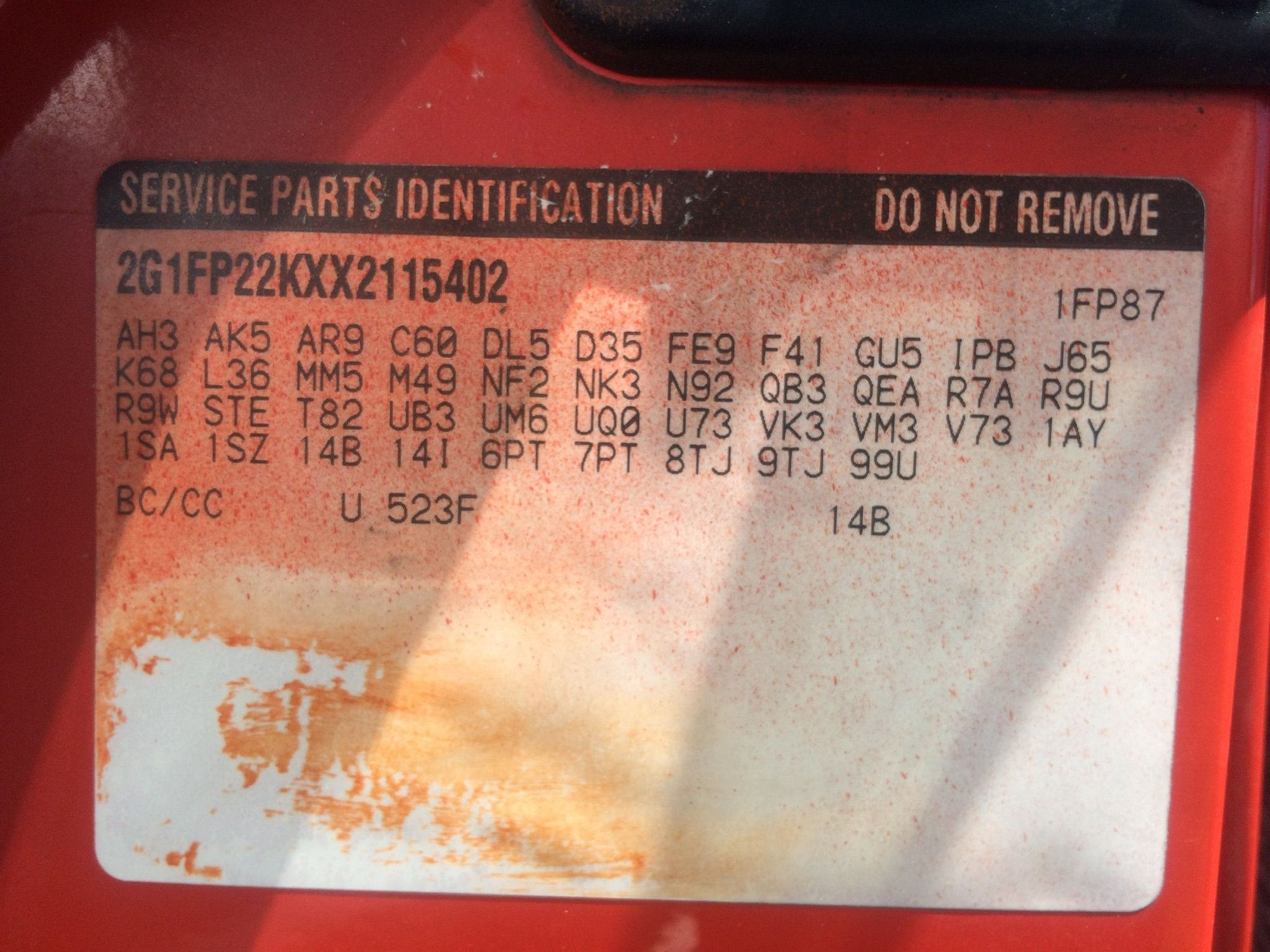

Here’s a pic of RPO codes

The Service Parts Identification sticker shows the car was painted Hugger Orange at the factory. The paint code is listed as 523F which is Hugger Orange and in the RPO section, 99U is shown which also indicates the exterior color was Hugger Orange. This information can be verified by the 1999 Service Manual in the General Information section using Service Parts ID and the RPO code list .

It does appear to have been painted given the over-spray on the SPID decal. But that is without a doubt a HO Camaro.
