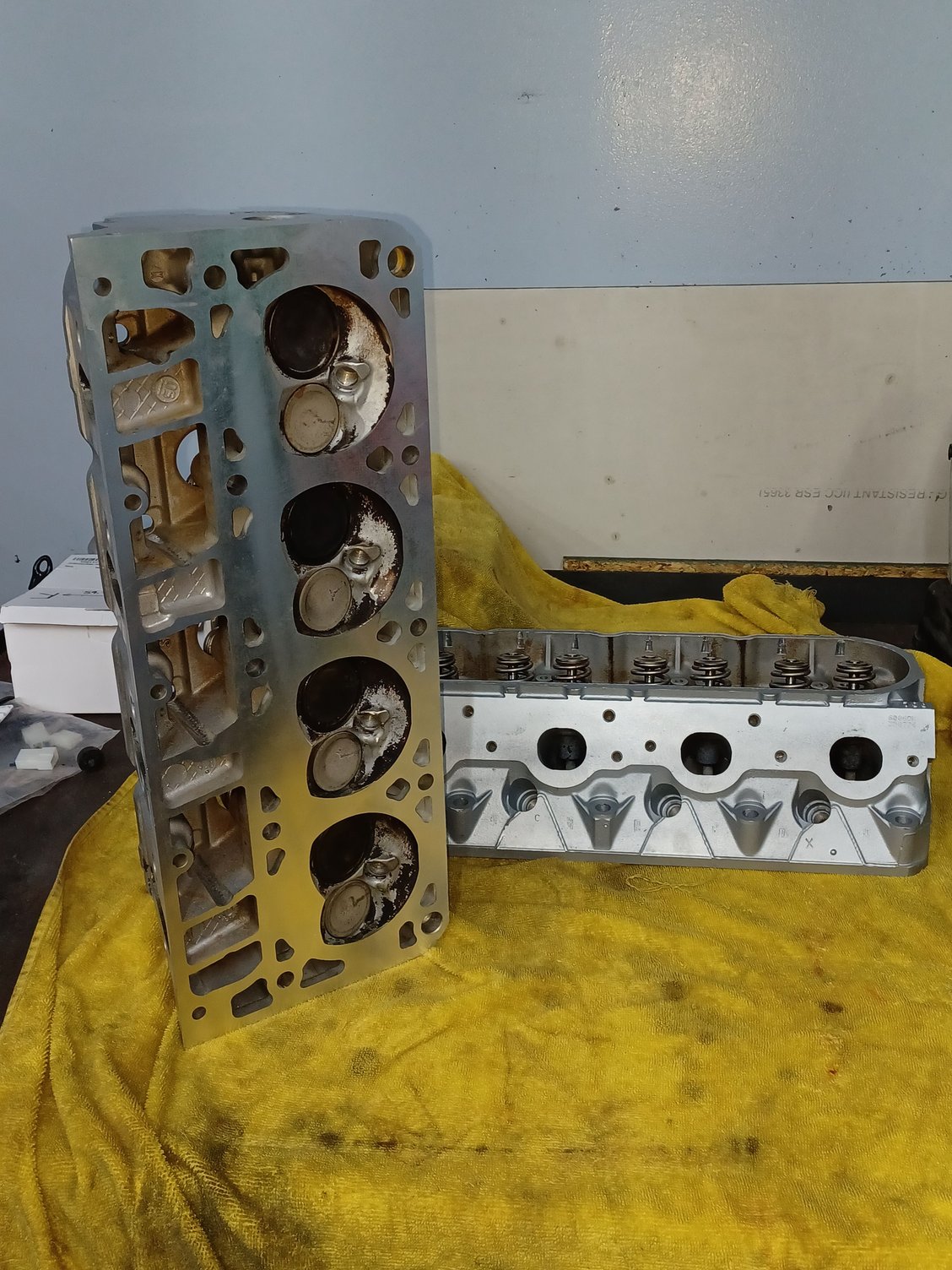

I just picked up the heads from my guy at the shop.
706 heads got them milled and valve seals/ spring put in that's all.
I have to take the 4.8 pistons out again since i gapped the rings for boost when i put it together. Since its gonna be NA after all I just slap stock rings on it.

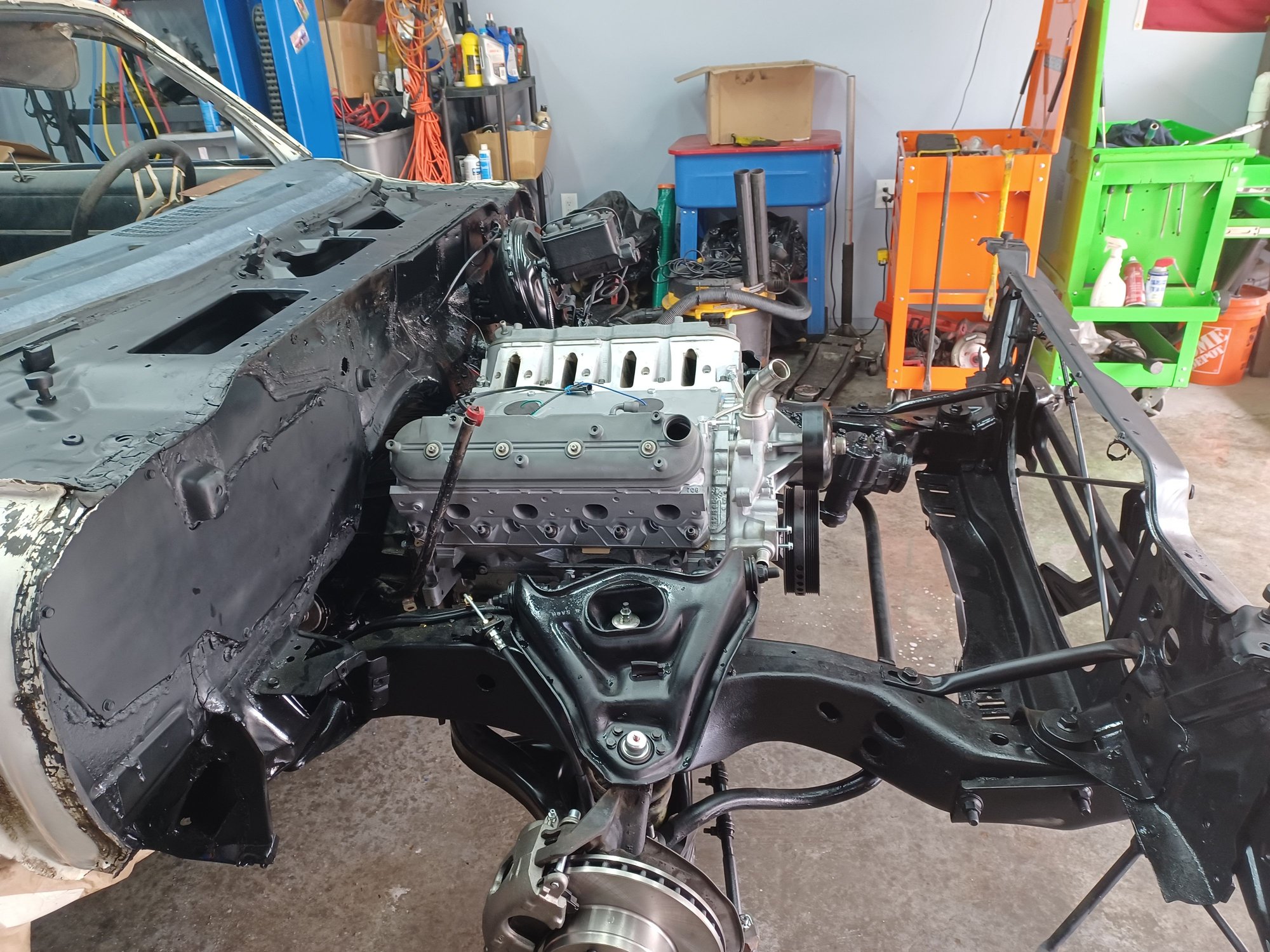

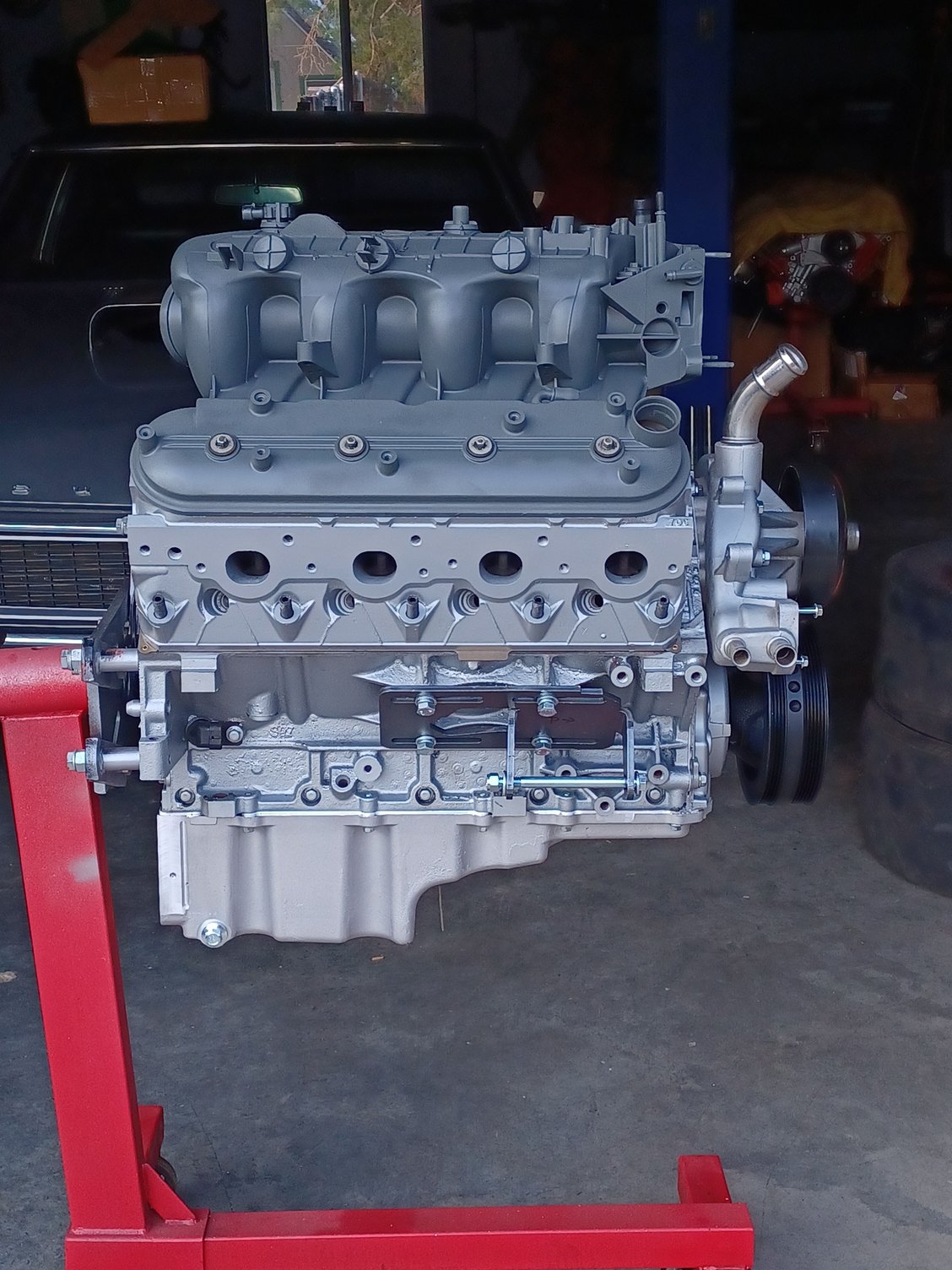

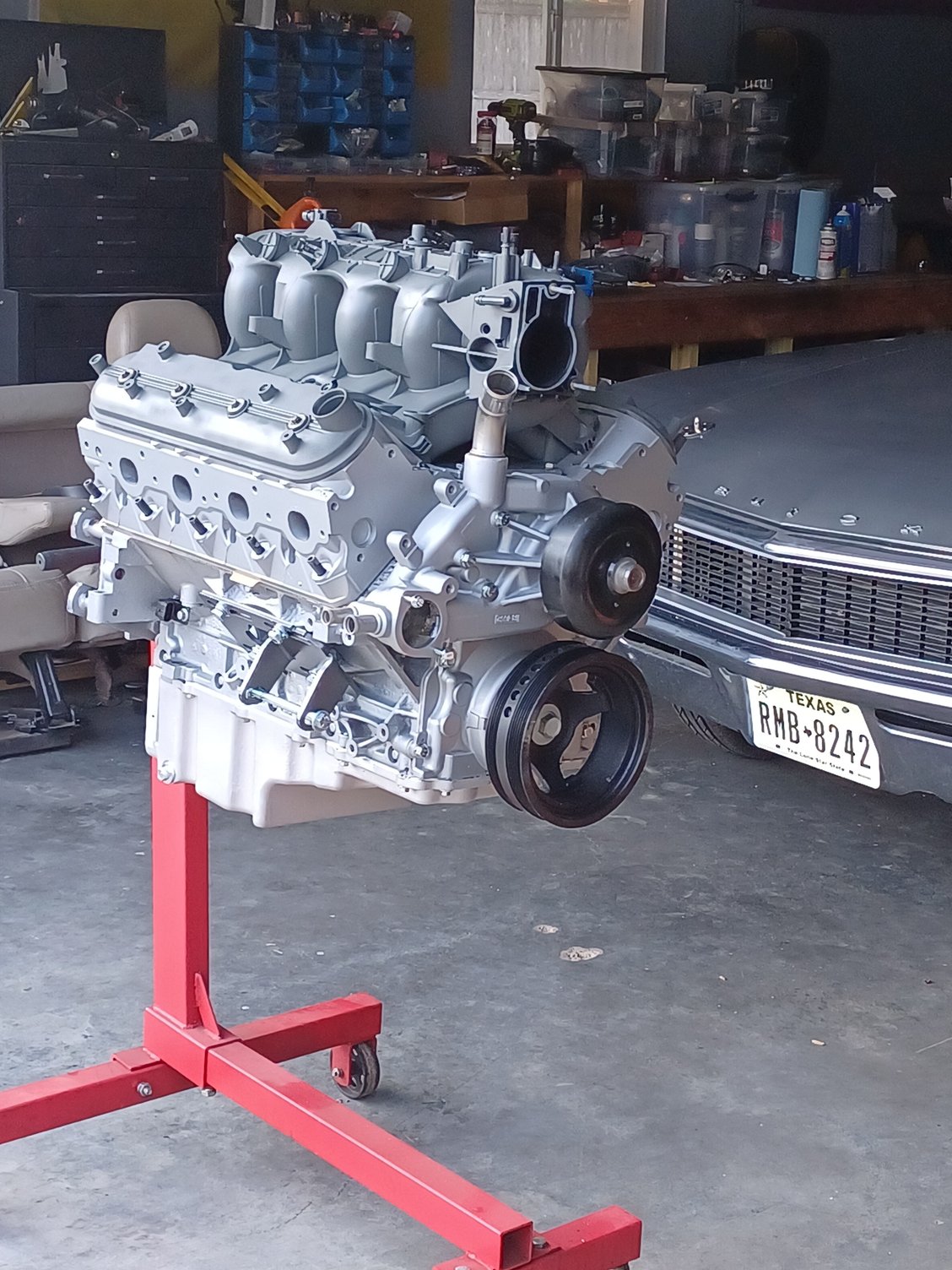

Long time no updates since i was travelling
i have at least assembled the Motor for this project and basically ready for drop in
i shaved a couple nothces of the intake for additional hood clearance lets see if it is enough

Looks good! Keep giving the updates.
I don't think the evap. solenoid will clear. When I installed my truck intake I had to provide some clearance by trimming the underside of the hood a little where it was contacting the throttle body. I used the factory fuel line manifold also. Not sure if it would have cleared if I didn't have a 2"cowl hood.
I had to cut that nipple off and run a screw in the hole, and my engine is really low.
but its a 72 firebird so the hood might be a little different.

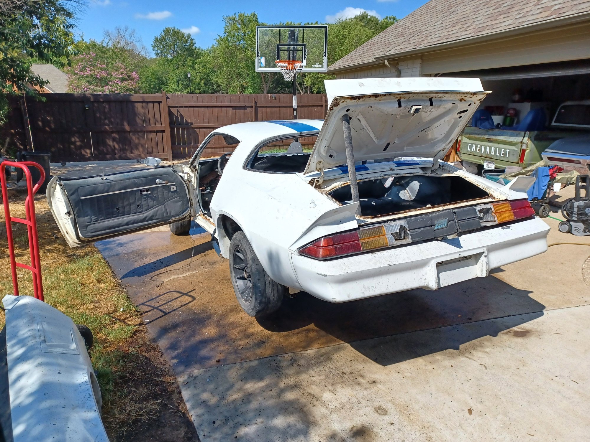

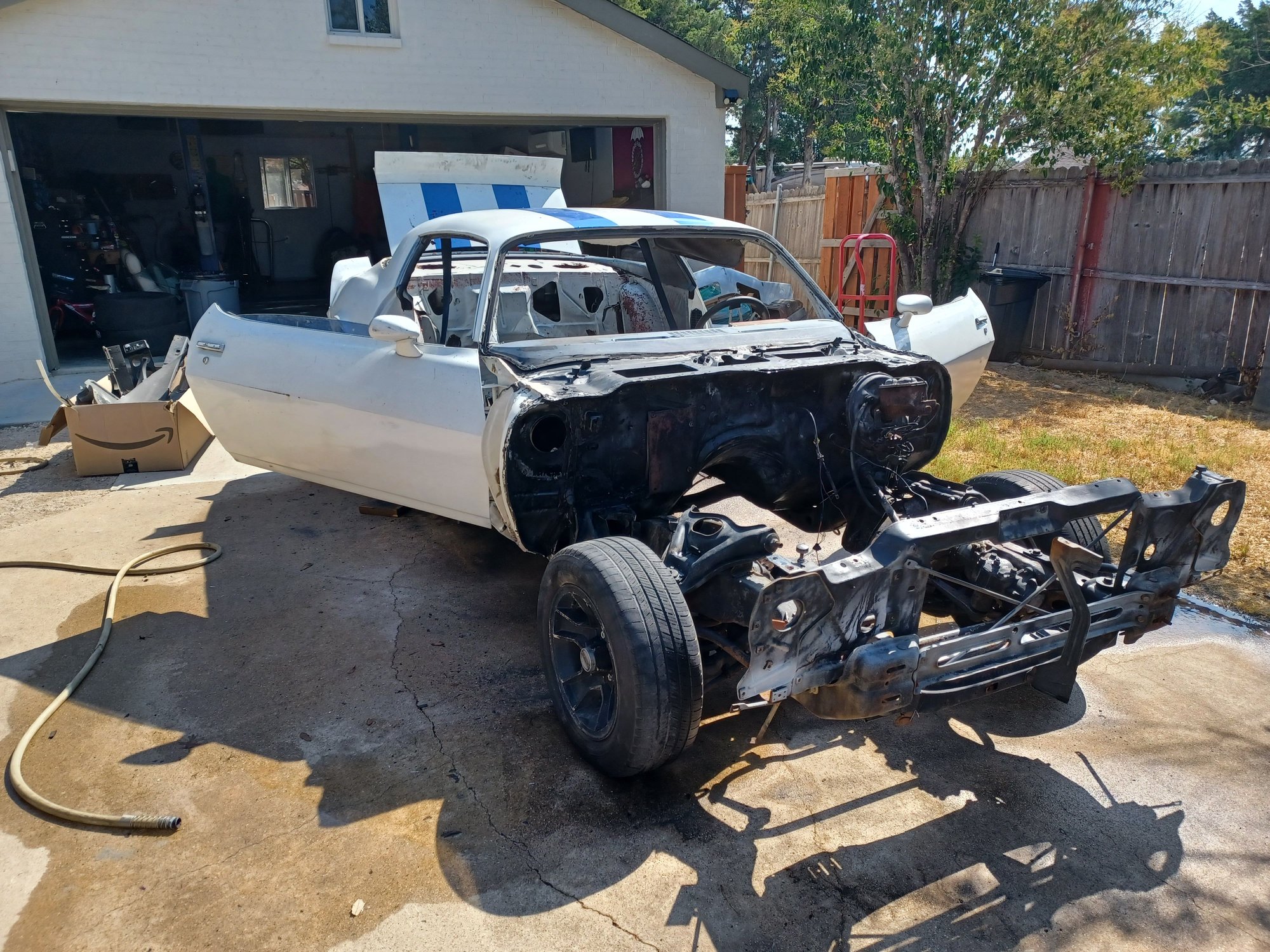

Finally some update. I was swamped with work and other stuff.
I brought the Z home it was at my buddies shop for storage for a few month. But now its here .
I have already a bunch of rockauto new oem suspension parts. To freshen up the handling + new frame pads new brakes and calipers all the "stay safe" stuff.
I power washed the body and will send off parts to my buddy who will paint it for me. I am aiming for the oem Z28 look white with the blue decals.
wife wants the oem N90 wheels which is ok but I think we can do better. Let's see.
I also picked up a 4l60e that I will send out for rebuild.
I definitely need a lot of oem interior parts. Such as center console, headliner, carpet etc. It's all doable and maybe I am lucky and fibd some good used stuff.
The rear end has slapper bars on it. That I might take off, i also replace all the brake and suspension parts in the rear.
Caswell get a new tank even though it looks like this one us ok but I'll Plat it safe + I probably mod the oem tank for a bosch044 or walbro450 anyways.
Powerwashed it its not that bad.
I will see I trimmed a lot of notches off already and I can get rid of more. However the z28 hood has that cowl and has a provission trimmed out of the hood so we will see. Testfit will tell

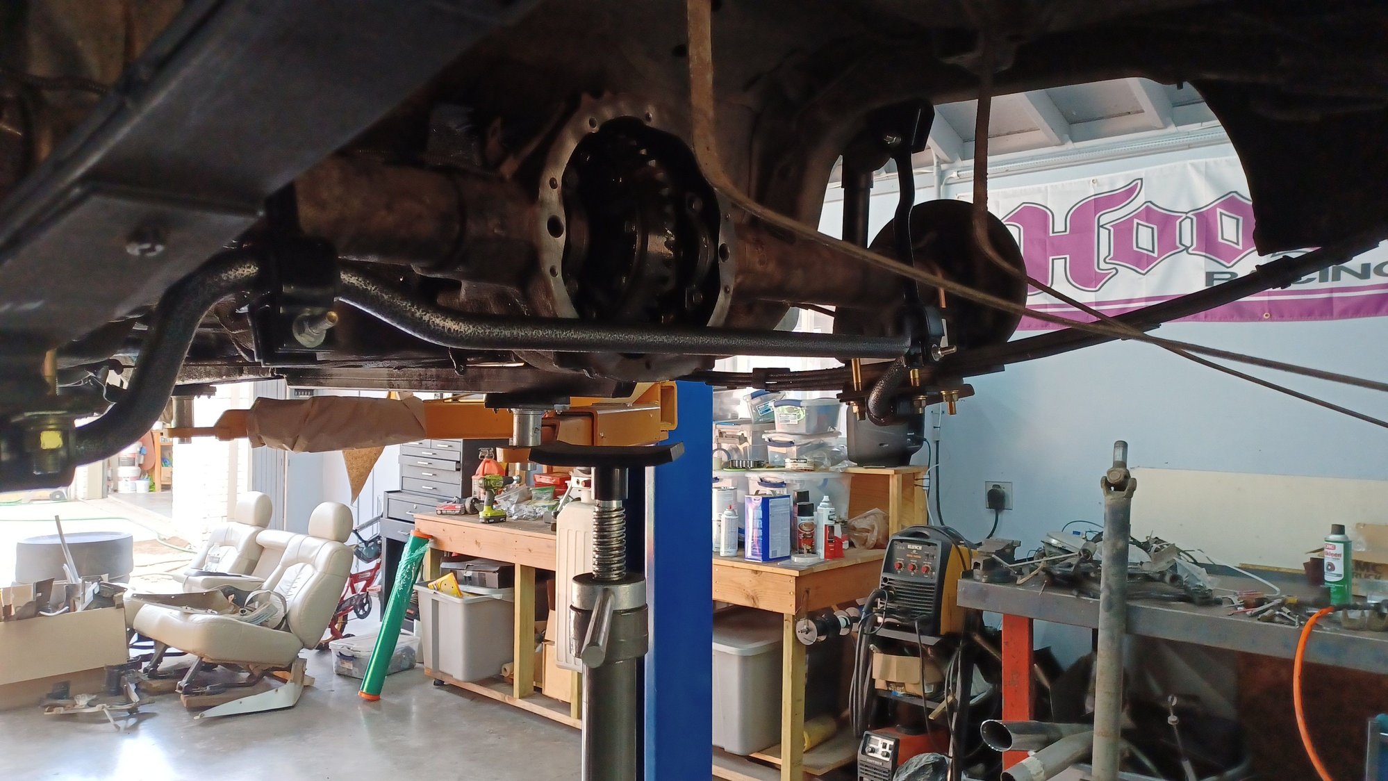

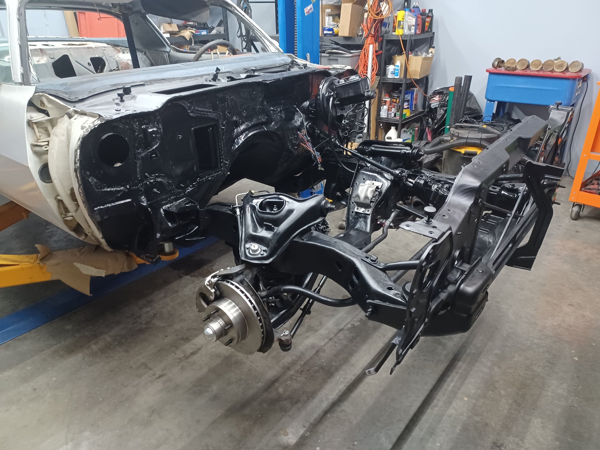

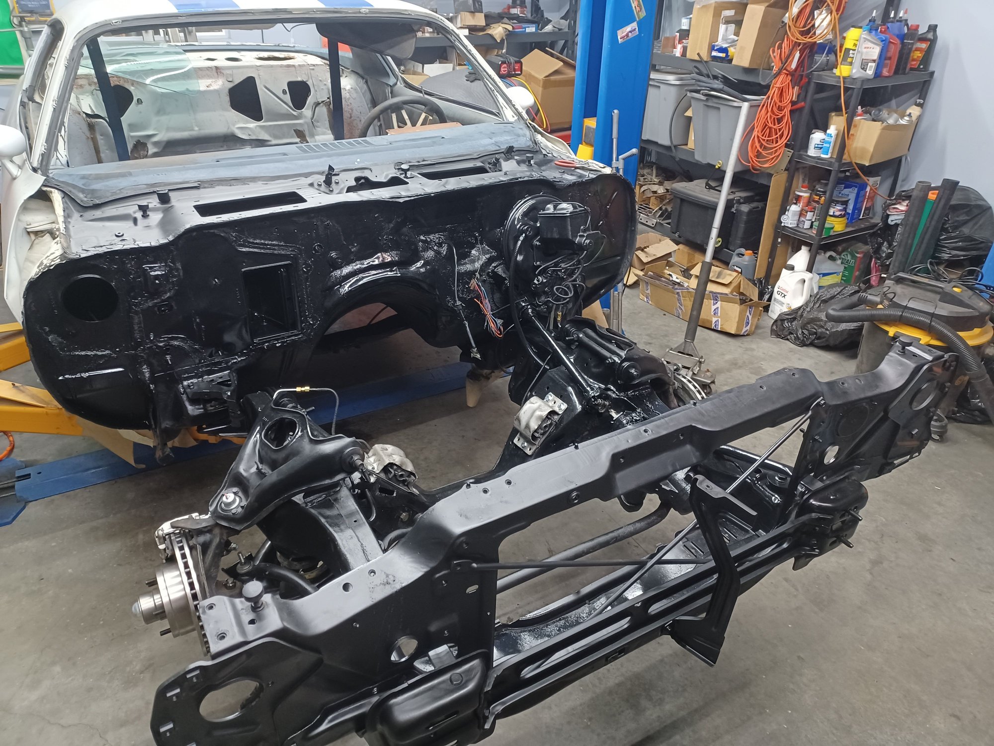

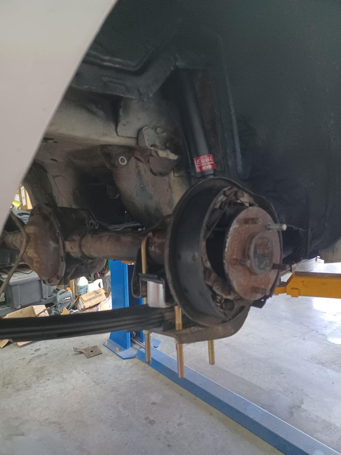

Git alot if work done this weekend
I feeshend up the front suspension completly..
New lower control arms new brakes and rotors, replaced all bushings, completely new steering arms and tie rods.
Cut 1.5 coils of the Coil springs to achieve a 2 in drop
( 1 coil = 1,5-1,75 in drop, so 1.5 coils should get me there)
fixed parts of the brake lines.
And did the rear as well inspected the 8.2= good, replaced all leaf springs bushings, installed new shocks and a 2 in lowering blocks.
took care of the. Seat belt humps right away since I'm planing on 15x8 /4.5bs with 275/60s in the back.

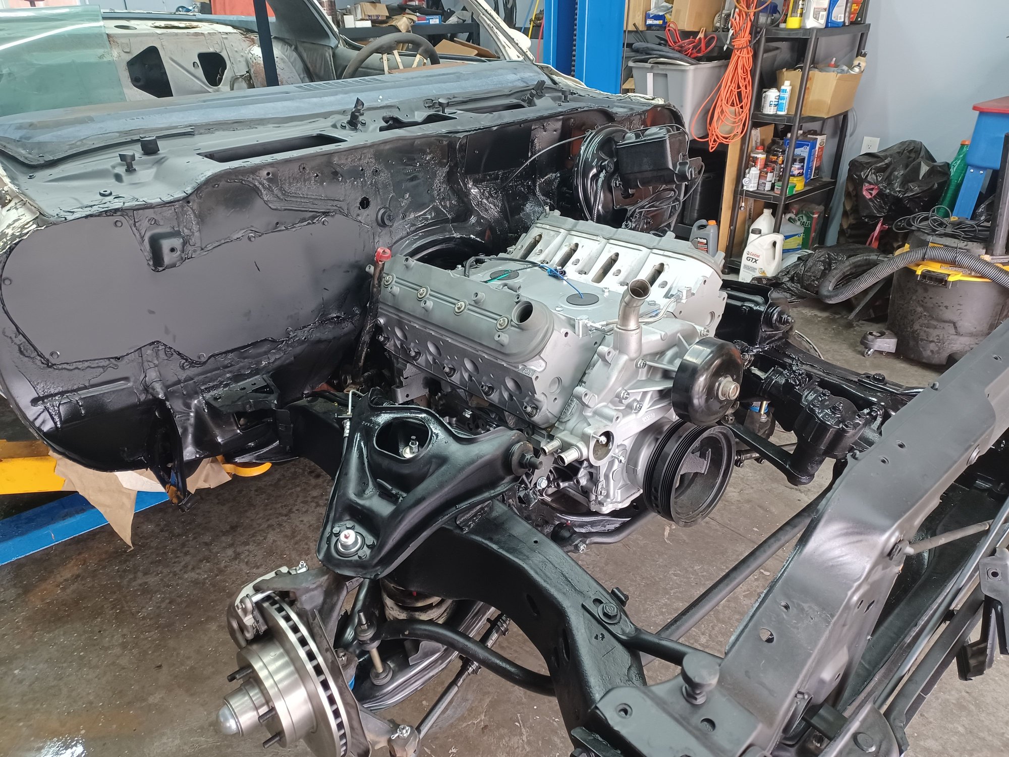

Rear suspension is sorted out with a summit racing sway bar 2" lowering blocks and new shocks.
I am waiting on a mini spool for the 8.5 lol.
I was able to mate motor and trans and drop it in ..
That's Some motivation right there
Fenders hood and Nose are at my buddies paint and body shop to see what's fixable and to get some paint

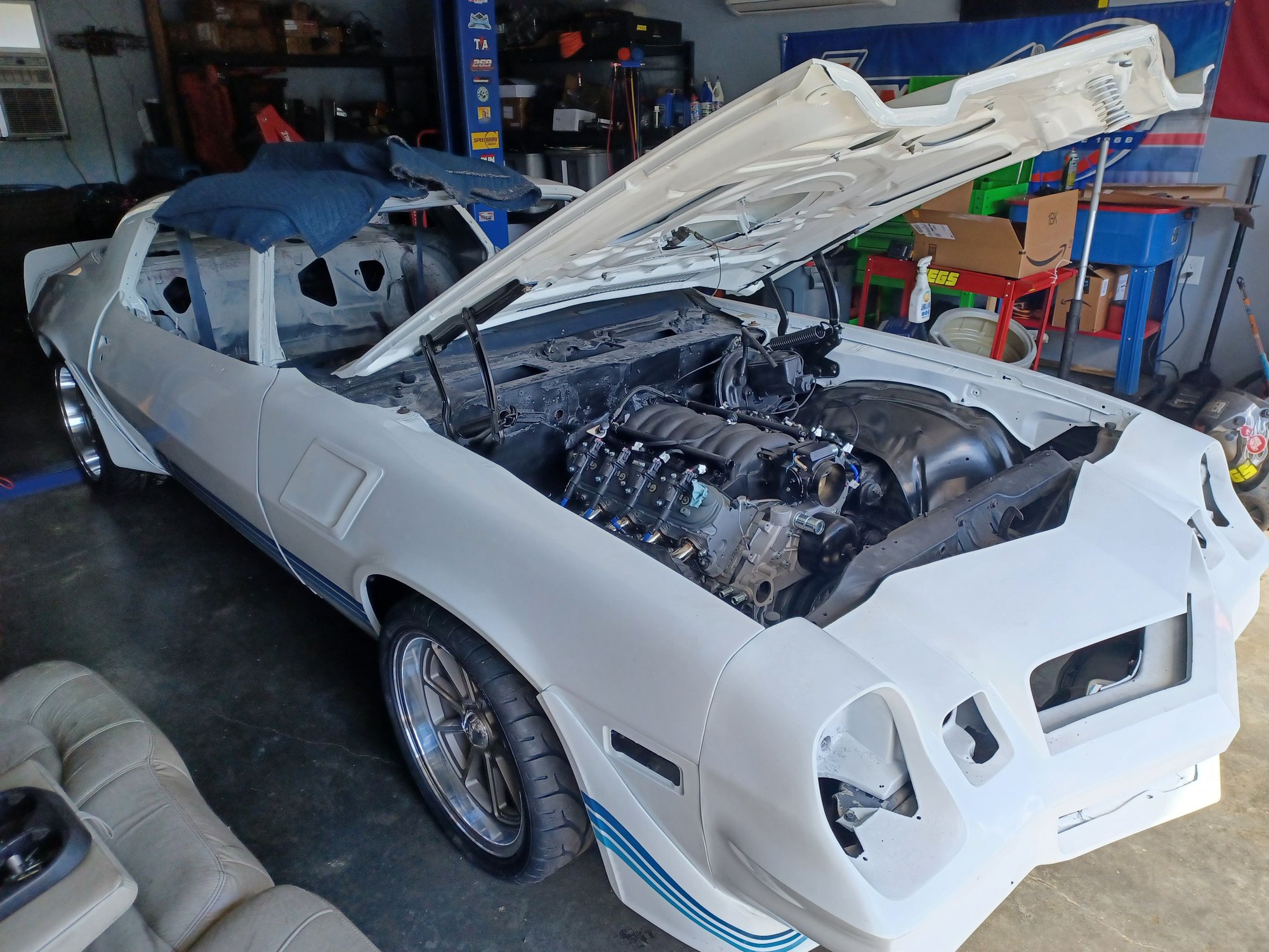

Its been a Long time ... Lets revisit this guy...
We are sitting in the shop forever..... life gets in the way sometimes ...
however she is painted... back to the stock color with the Orig Z28 stripes and the engine is mated to a TH350 and dropped in..
i have a ACES jackpot or the engine management ...
further i collected alot of parts... new wheels and tires and interior pieces... and so on....
