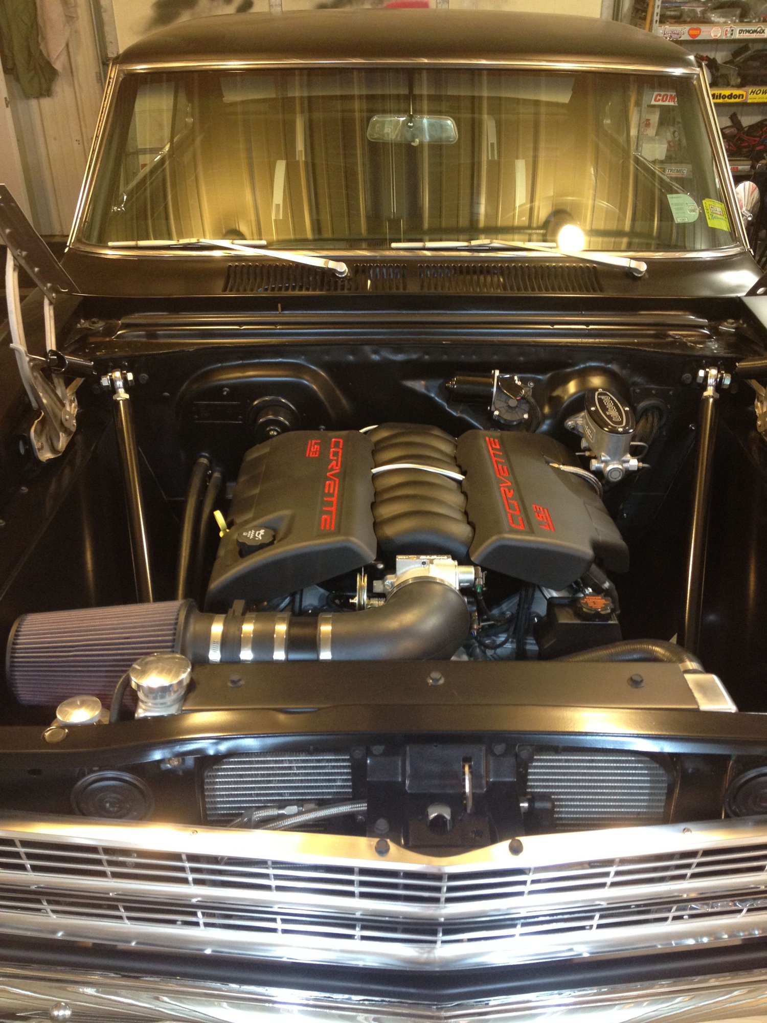

I had RED (Race Engine Development) out of CA sleeve a LS2 block for me. Darton sleeves. 427 cube Manley stroker kit. 24 tooth reluctor crank. L92 heads with up graded springs and push rods. LS3 intake.
Smallish cam. Did 490 rwhp with a 4L60E.
Ran great and easy to tune. Very quick in my 67 Nova project.
