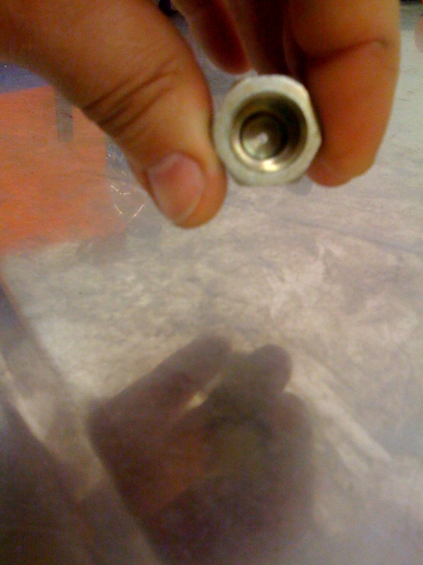

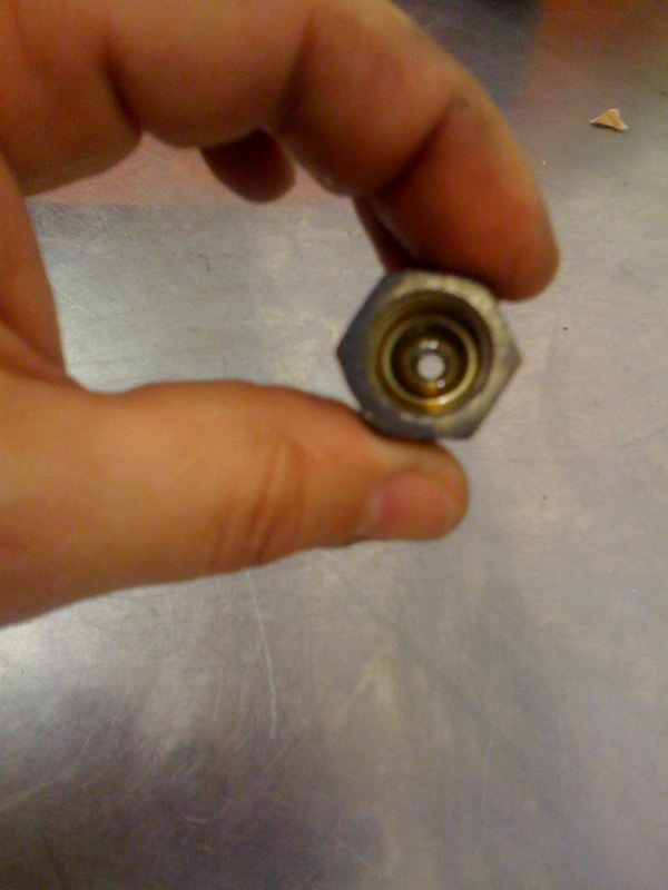

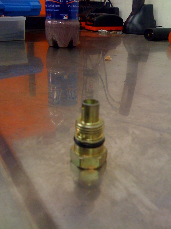

I managed to make a little more progress yesterday and today. This is the first car that I have done with power steering. Both of my previous FCs were converted over to a manual rack. However for this build, the customer wanted to keep the power steering. So I got on the V8RX7forum forum to see what issues I might be facing. It seems that the stock LS1 power steering pumps flow too much volume than what is required by the RX7 rack. There was also a couple of methods to deal with the problem. One method is to cut the pressure relief spring. The other method is to get a new orifice fitting from Turn One.
I chose to do the latter. Here is what the fitting looks like:
This is the orifice in the stock fitting:
Compared to the orifice size of the new fittings provided by Turn One:
The orifice opening is much smaller and as a result flow less volume to the rack. I know there is much debate as to what method works best and whatnot. This solution seems very simple, inexpensive, and straight forward.

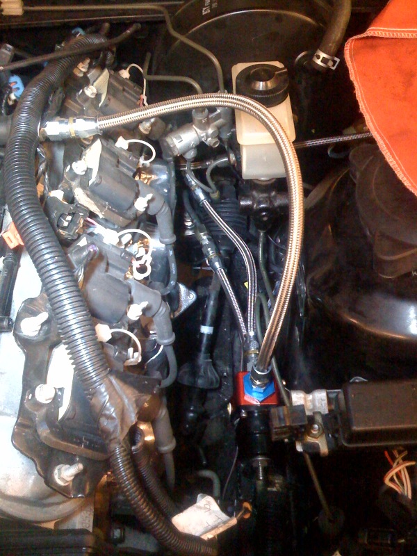

Next up on the list was the rest of the fuel system. The fuel pressure regulator was mounted on the shock tower. This allowed for simple routing of the fuel lines. Once again braided stainless teflon hose is used. Instead of the crimp style fittings, these lines use reusable fittings since they look a little better, in my opinion.

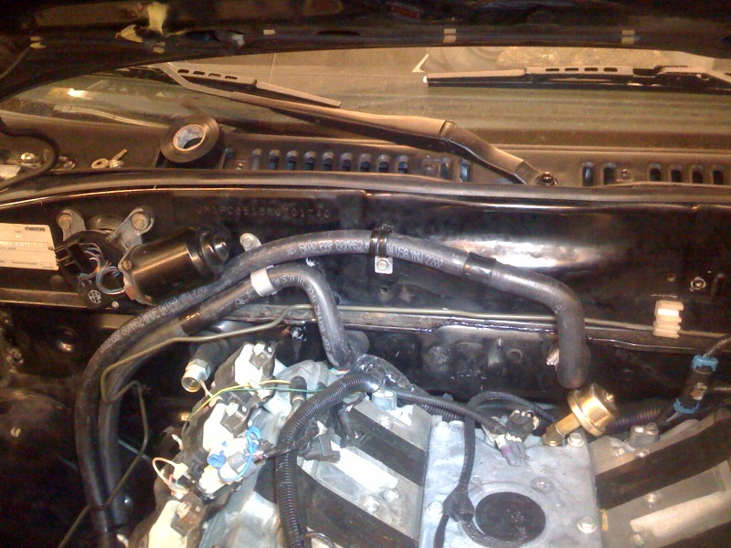

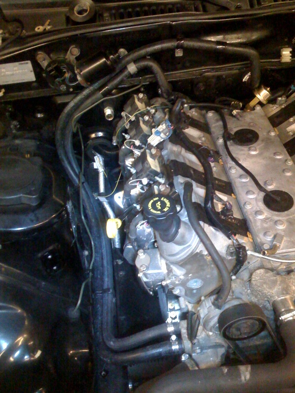

Next up was finishing up the heater hoses. I found perfectly molded hoses with the correct bends that come off the fittings on the firewall. From there I used a hose union and some heat shrink hose clamps to mate with the rest of the hoses that run to the engine.
The lines were routed along the frame rail and attached to the water pump. In this picture you can also see where the engine wiring harness enter the passenger compartment. Routing the engine harness this way allows the ECU to be located where the stock Mazda ECU sits in the foot well.
