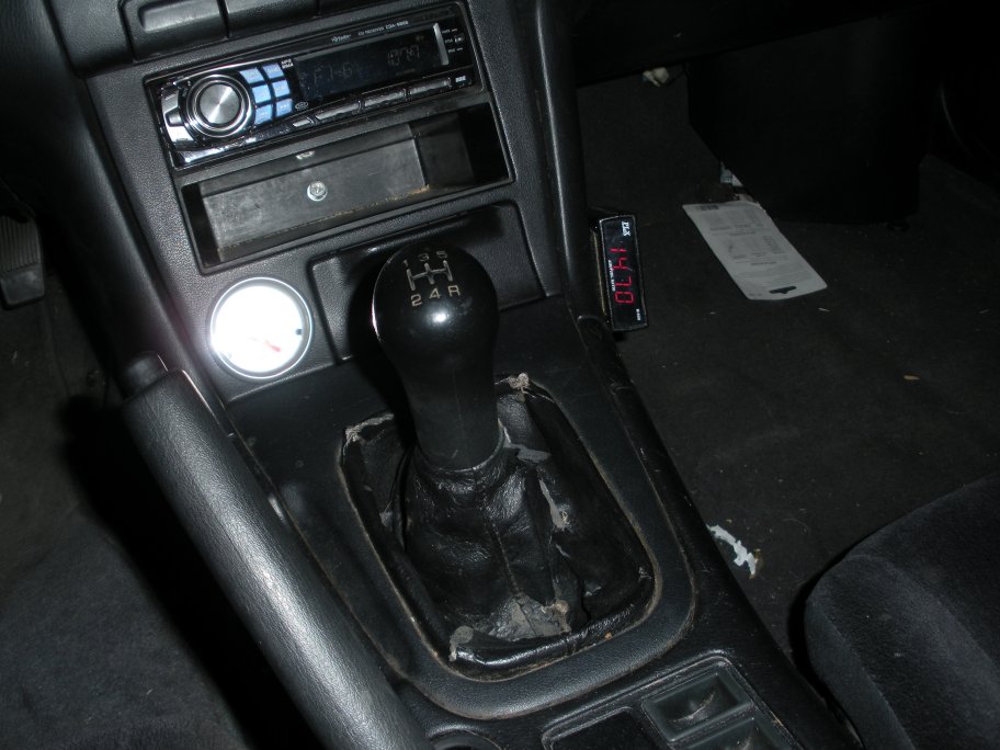

The stock 240 gauge is worthless. An H and a C won't tell you much. If the motor is already in the car you don't have too many options. I put my aftermarket one where the lighter used to be. The temp sender is in the passenger side head. If you must keep the stock gauge you could always put it in one of those radiator hose adapter.
