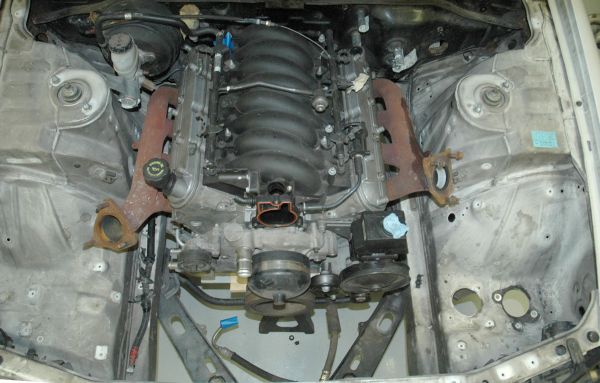

Since this project has progressed to the point the engine swap is moving forward, figured i'd finally post here.
Nissan Skyline R33, wrecked at a track in 2005, bought cheap, fixed front clip. Now starting the swap. Not a high dollar build by any means. I've done a few other swaps, this is not my first. Plan on doing a turbo ls1.
photos -
full photo album here - http://www.z28evans.com/album/thumbn...lbum=28&page=1
Why ls1?
I like them. I like their power band. It is cheaper for me to make my power this way than to go with an RB.
James

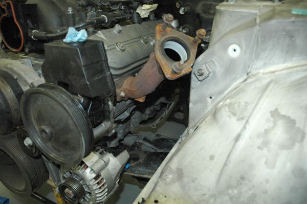

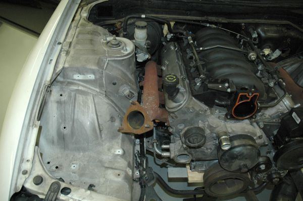

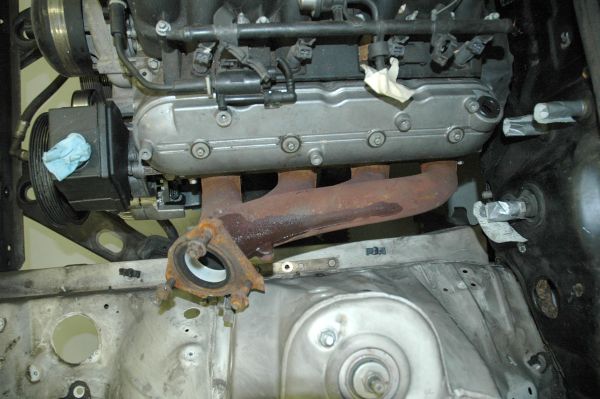

playing with possible turbo setups. The engine is not in the final place yet, i still want to move it back about an inch. I cut the right manifold and rotated it so it would clear the shock tower. It is still closer than i would like, i will play with it more. There is a lot of room to run the down pipe, and i can run it on back the factory location. So, i probably don't need to make the manifolds from scratch - people are making over 1500hp on these factory manifolds

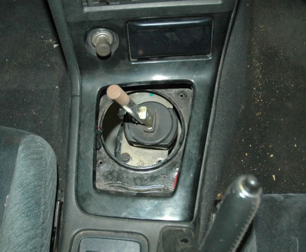

shifter looks almost stock, once i move everything back about an inch it should be about perfect.
