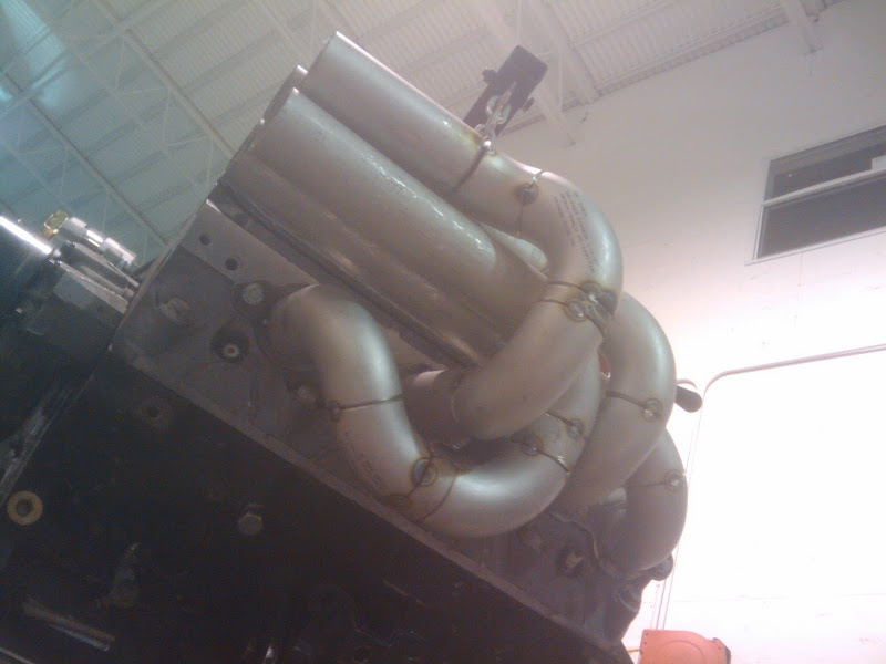

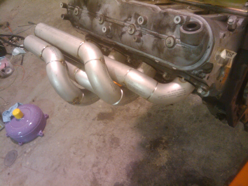

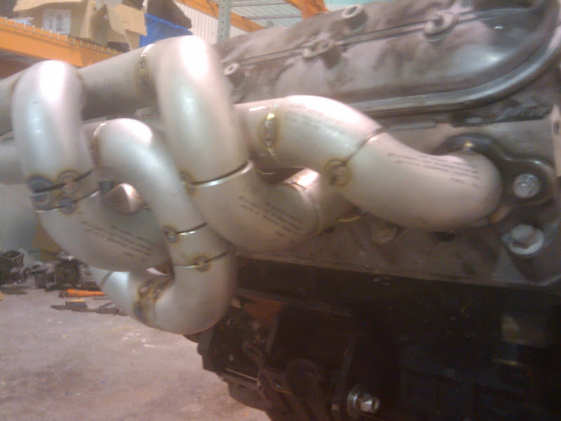

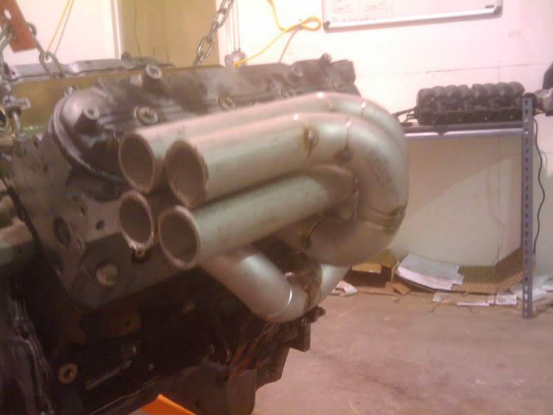

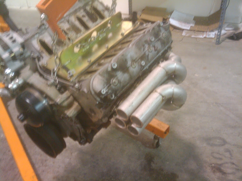

Just tacked together. Need to cut the tacks on the flange, finish weld the primaries, then weld them to the flange. Should be fun. Not bad for my first time I guess? It's 1.5" sch40 (not sure they they call it 1.5", ID is a good bit larger....)
You can see the lovely precision 3000 stall sitting there =)
