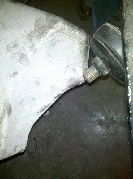

Sometimes we get lucky. I was pretty sure that a batwing pan wasn't going to fit. Man, it was close to interfering with the Mustang II strut arms.
However, because it ended up looking like it will work, I gained MASSIVE ground clearance.
Before:
After:

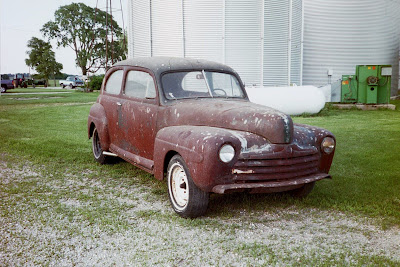

I've got a 42 sedan with the 46 front end on it. It needs an LS for my boys car when he turns 16 I think. I wish mine was a coupe but you take what you can find. Plus it was cheap.
(Note the "barn find authentic" bird sheist.
