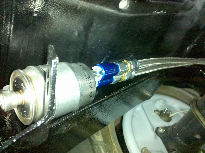

Hey 46Coupe, etc,
When I mounted those Russell fittings on my filter/reg, the inlet and return fittings slightly interefered with each other to the point where I feared the possibility of a leak. I very carefully spread the two tubes apart, and now the fittings just clear each other. Anyone have this same experience?

Originally Posted by Andy1
Hey 46Coupe, etc,
Andy1
Yup.
which is the return line on this filter, the 3/8 or the 5/16?
5/16" is return.
Russell PN 640863 is 5/16" to 6AN (for return)
Russell PN 640853 is 3/8" to 6AN (for inlet)
Russell PN 640940 is for 6AN outlet
Note that the first two are the BLACK fittings. PNs for anodized BLUE are 640860 and 640850.
