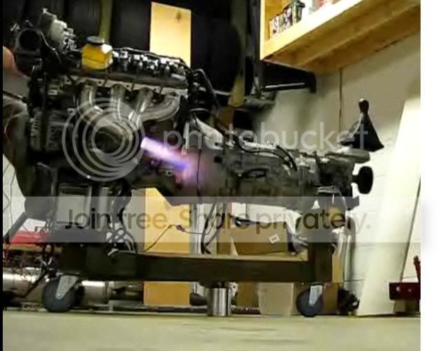

I made a wood stand because I was too impatient to wait for one to be shipped and didn't want to use up my metal. Doing it again, I'd order a stand that could support the engine and tranny.
Here's what I came up w/ from 4"x4"s.
