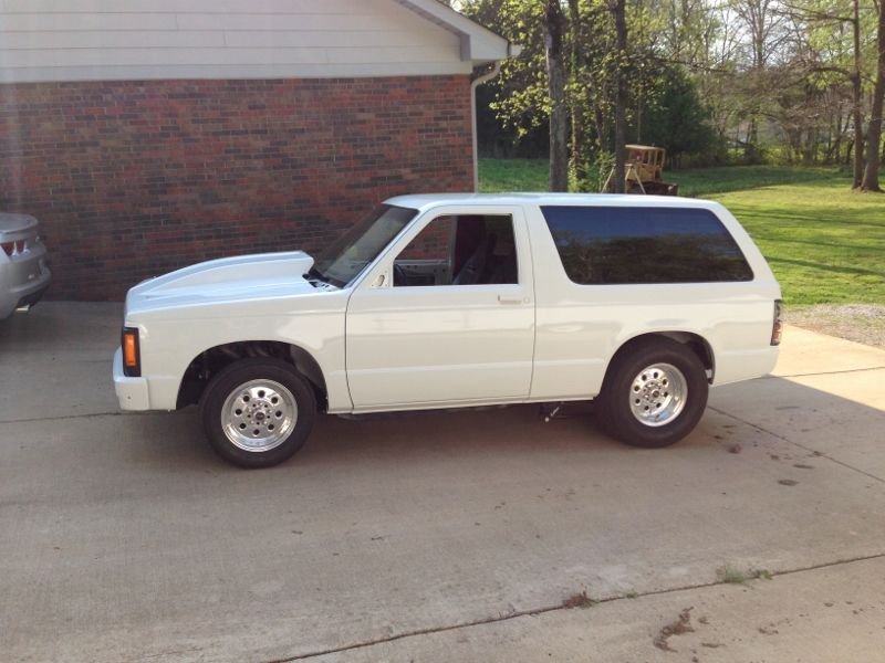

My Blazer below:

You have a real nice looking truck. Should be a fun build.
