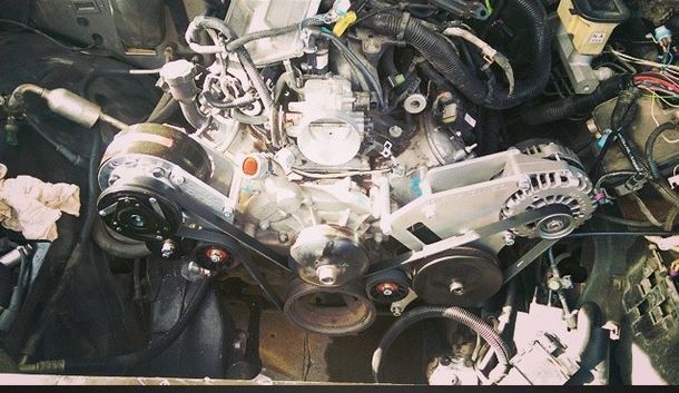

Old Dec 9, 2014 | 12:09 AM
moore_51's Avatar
Joined: Jul 2014
Posts: 26
From: Fort Worth
This is the motor once I got both the brackets bolted on. The old harness is still in this picture. I got a painless harness for it now. As for the intake, I didn't think the Hummer intake would clear the bracket, and I cant use a truck intake for the 5.3 without relocating the battery which I don't feel like doing. So I checked out AEM, and got a couple things to make the intake myself. I'll post a picture once that's done for everyone to see. And i'll get some more pictures of everything when i get back up to the shop.

I have the dirty dingo a/c mount and my H2 hummer intake fits.
