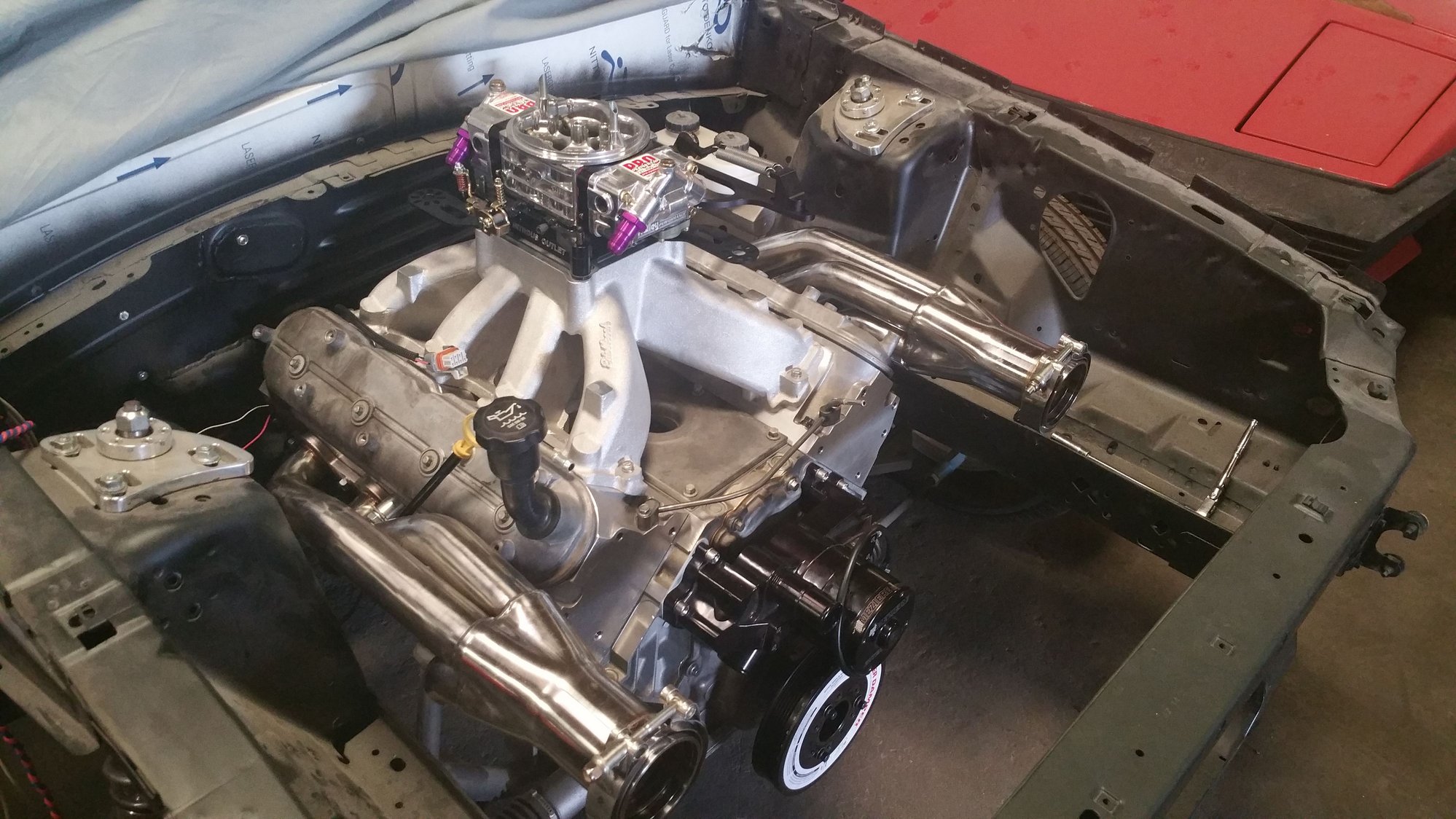

Old Jun 28, 2015 | 07:33 AM
Gray86hatch's Avatar
iTrader: (83)
Joined: Sep 2009
Posts: 2,388
From: Battle Creek Mi
I just built my own. Not worth buying something you will have to modify.
Tim
