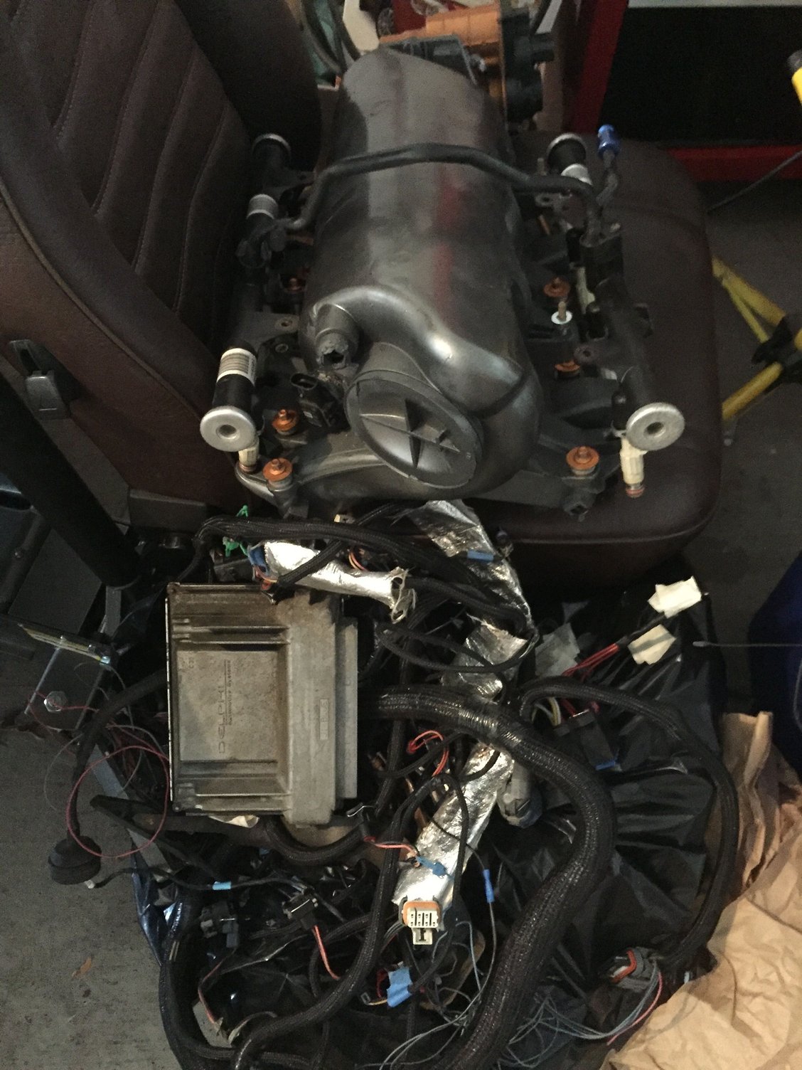

Below is the intake manifold that was sold with the car (a little difficult to see):
But I cannot use the truck intake manifold with clearance issues so I am reaching out to see what my best option would be...
I've read that the LS6 intake is popular along with the LS1. LS2 manifold is possible too? If I could get some input, that would be great.

With the upgrades, an LS6 intake is a must. Get used or dorman replacement (search Gen III external for Dorman info).
You'll need LS1 injectors and a fuel rail, but your 3 bolt DBW TB will bolt up fine.
