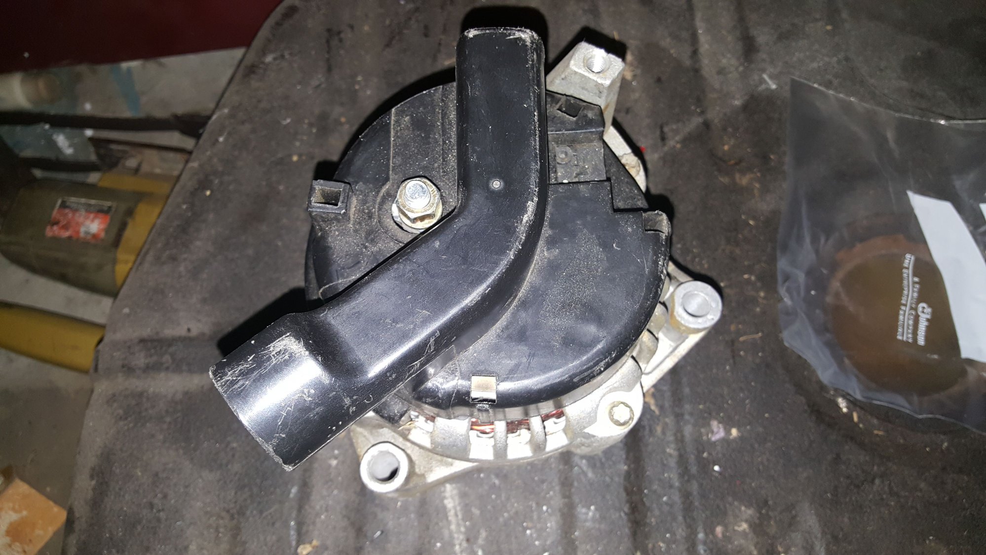

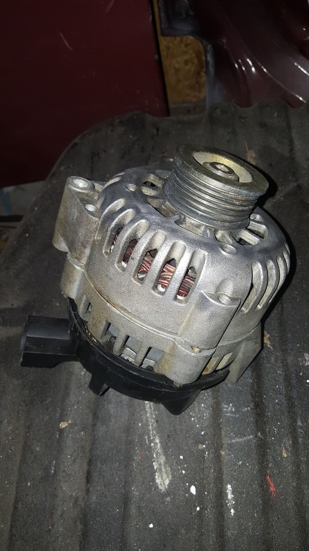

Is there a way to tell which alternator I have just by looking at or or measuring the case? I'm trying to figure out if this is the 105, 130 or 140 amp but I don't remember if this is the one that came with my 5.3 or if I bought one from a LS1. There's some numbers on side of the case: 2010/12/10 1/1 0005

It doesn't look like a truck alternator. Can't help you with load rating.

Not sure of the rating, but that is an F body LS1 alternator, they are the ones with the plastic vent thing on the back of them.

I was thinking its from a LS1 too. I tried google for some pics but that didnt help much. I remembered buying the alt bracket from a guy but I didnt remember if i got the alt from him too. I guess I did. Thanks fellas.

Looks like an F-body alternator:
http://www.rockauto.com/en/moreinfo....sn=506&jsn=506
102 amps.
