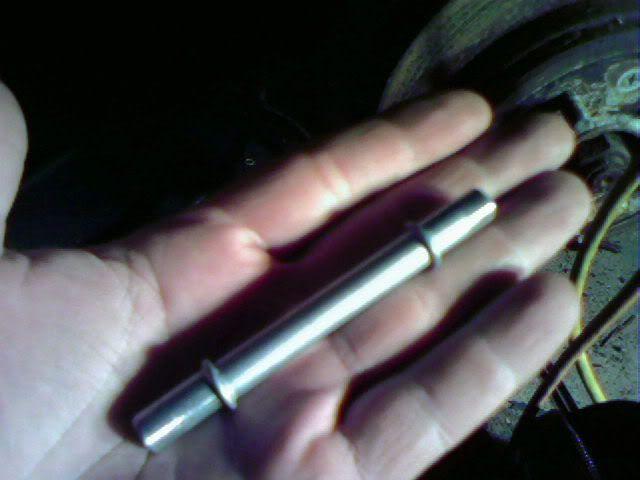

I bought the regulator for my 91 rs, what fitting do I need for the motor side feed? I bought a 6 an quick connect but that's not right since it's male on male action and no one seems to sell a 5/8 10 an female quick connect?

Does anyone sell these yet? If not would anyone need some if I make them?

yes they do although the ones I bought were longer, Dorman makes them I think I listed the part numbers some where here before a quick search turned up DOR-800-155 for the 3/8" line.

I love you a little lol I've googled my heart out. So I'm going to have to suck it up and use a foots worth though,right?

that is the only option I found was 12" connector, dorman sells the 5/16" double ended one as well. I have the part numbers at home but won't be able to look at them until tomorrow night. I found searching on dorman's website to be helpful

Theres a guy on ebay that sells them http://www.ebay.com/itm/LS1-LS6-Fuel-line-3-8-Push-Connect-3-8-Push-Connect-/271431960024?vxp=mtr&hash=item3f329b05d8

I didn't know about the Ebay guy. I just cut mines to the length I wanted & welded it back together
